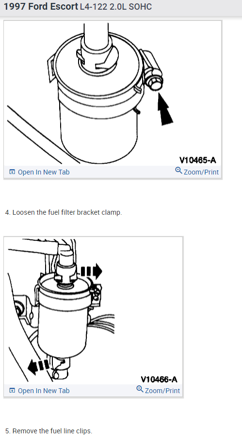

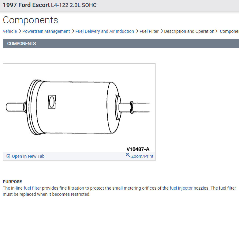

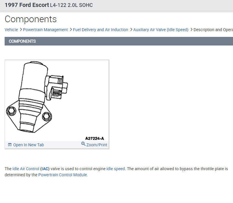

Please can you help me as my car will not perform when putting foot down on accelerator, it also die's when stopping, the car shakes and also wobbles. Have you any idea !

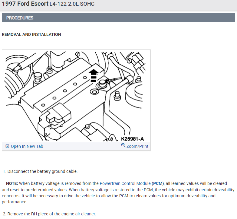

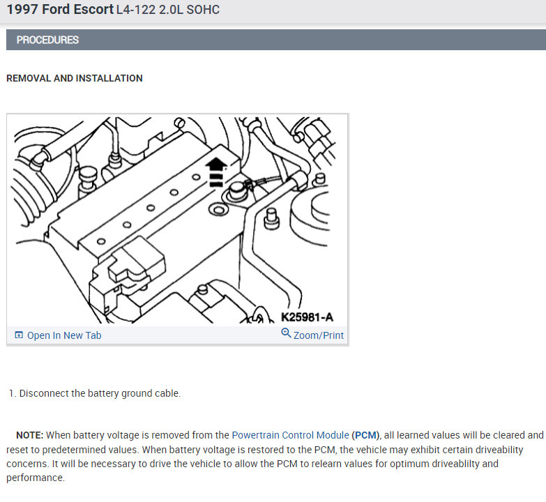

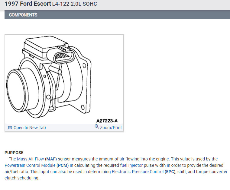

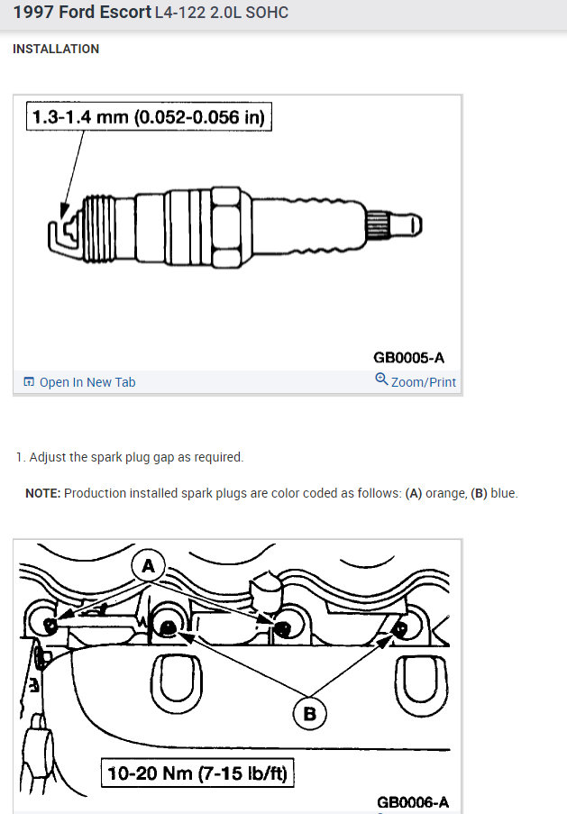

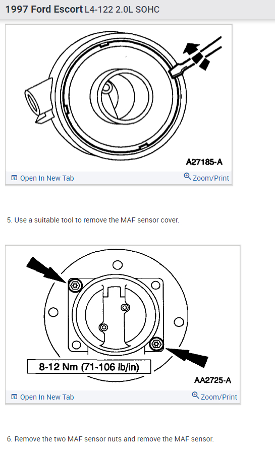

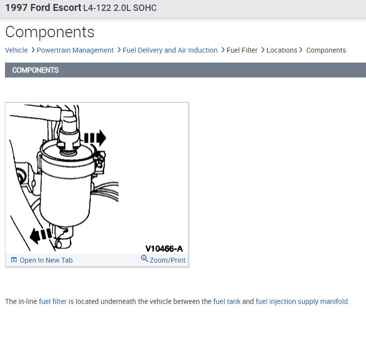

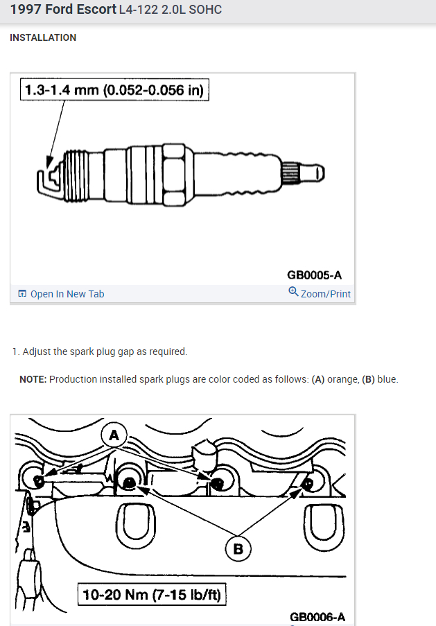

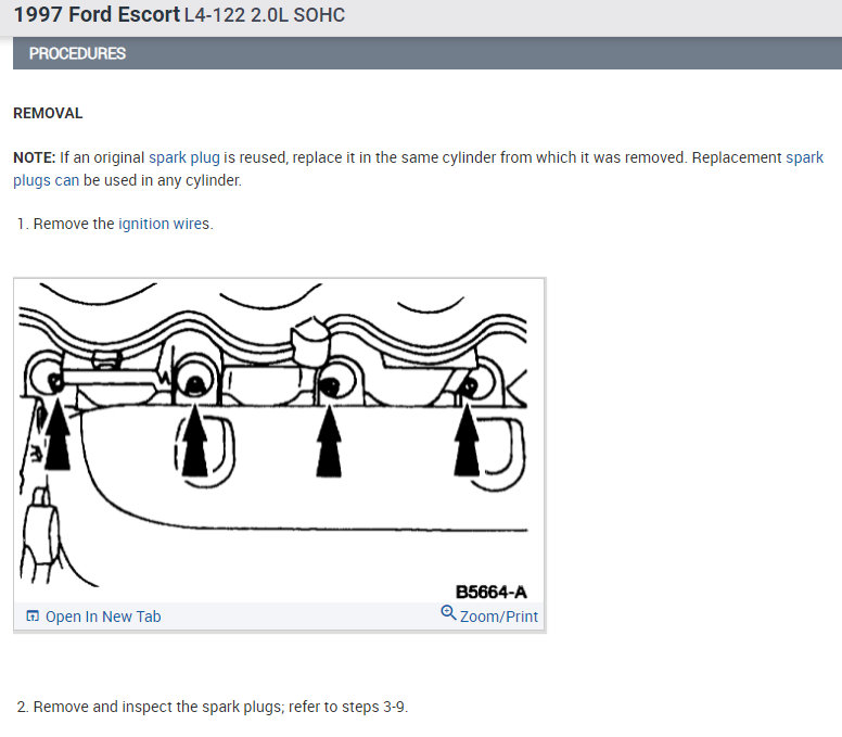

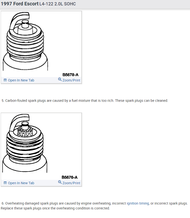

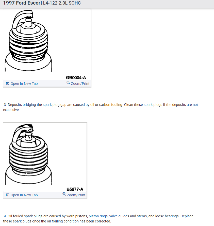

This issue can be due to several factors.

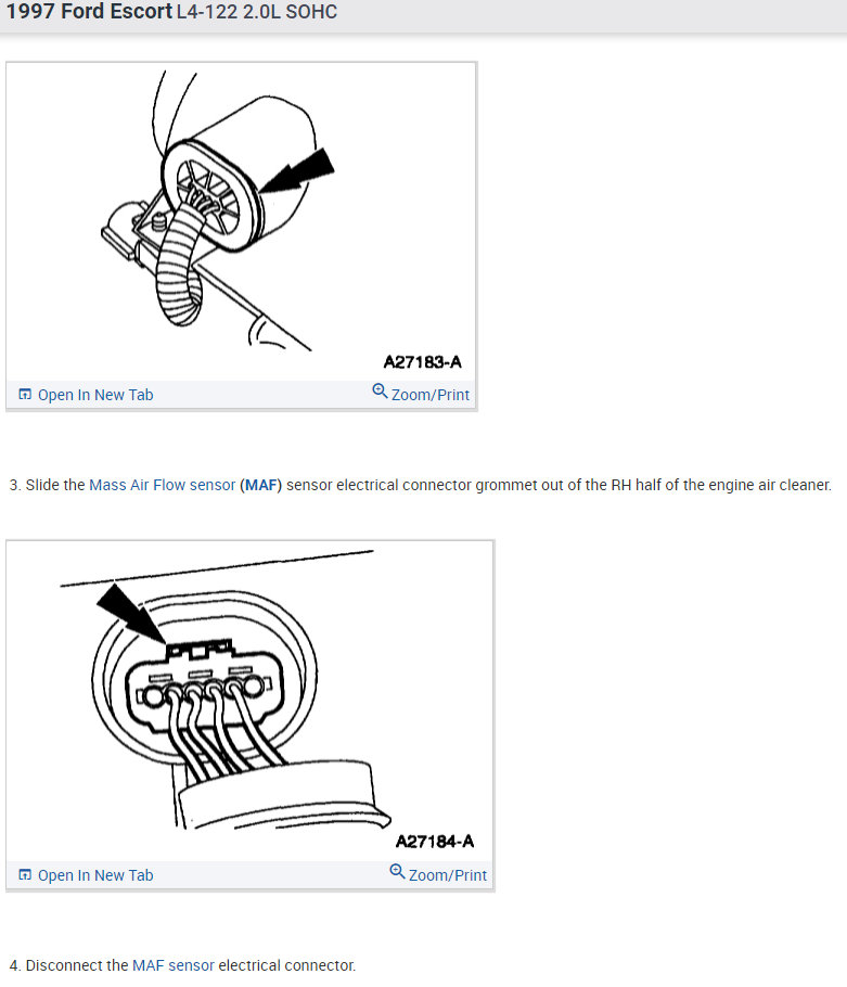

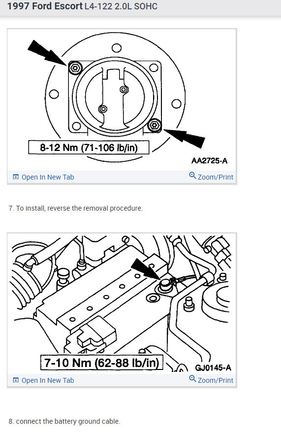

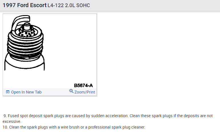

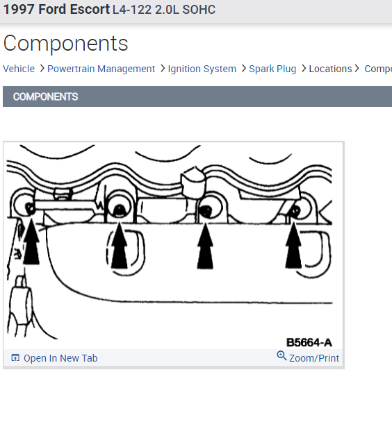

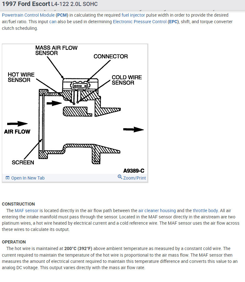

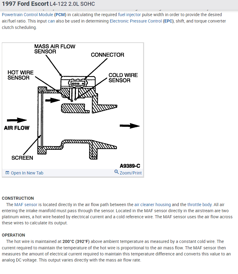

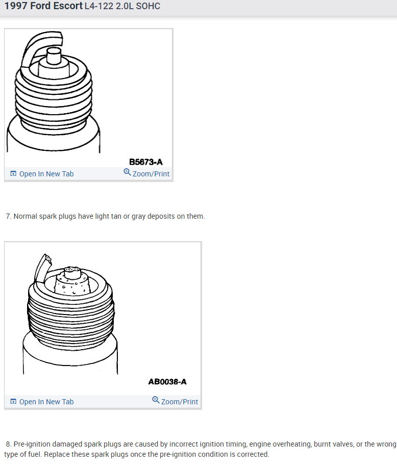

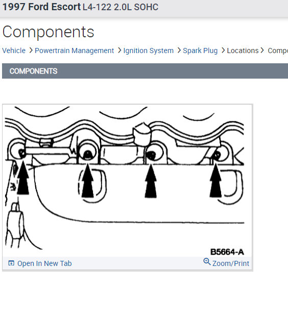

It can be for weak spark plugs, dirty mass air flow sensor, clogged fuel filter etc.
The best course of action should be to have a look at the primary components and verify they are functioning properly.
If it has not have one in the recently I would suggest first doing an engine tune up. Many times a tune can restore the lost performance and drivability.

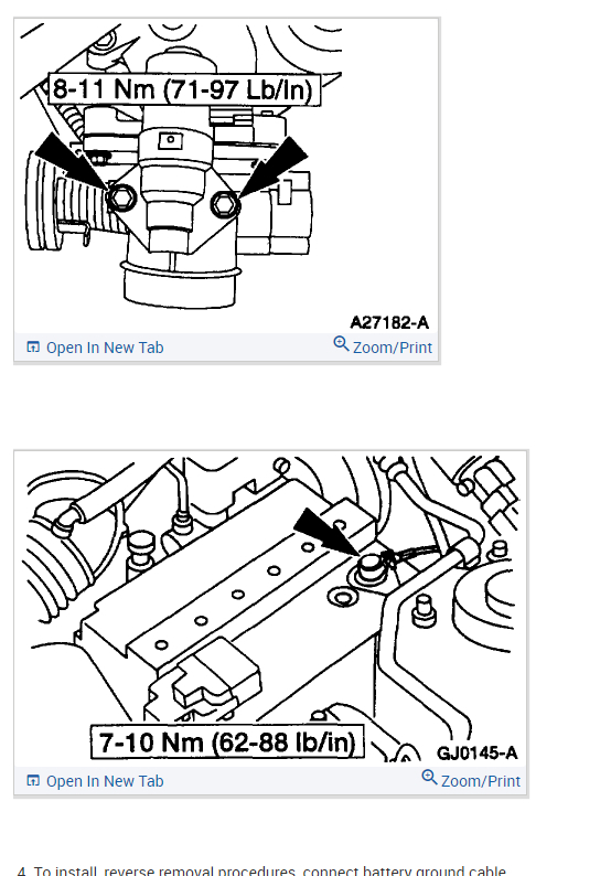

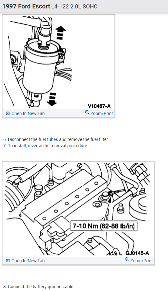

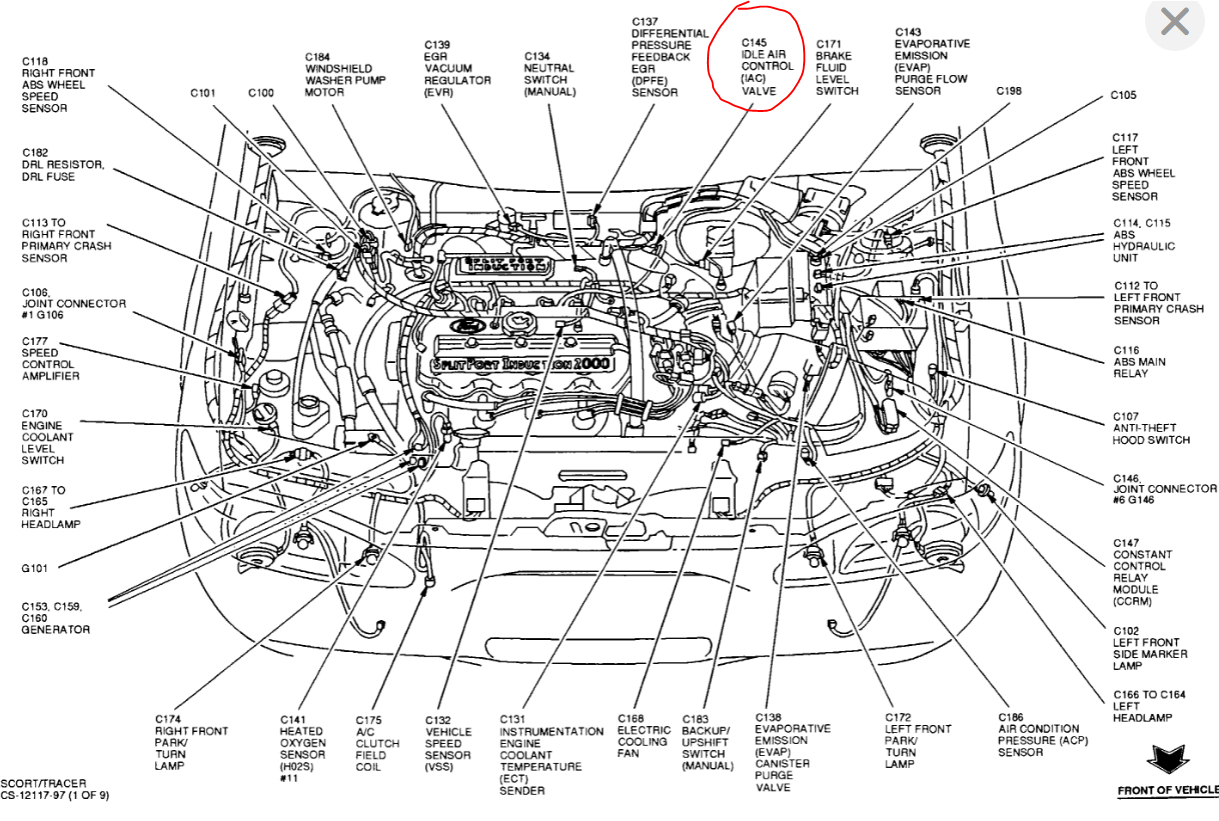

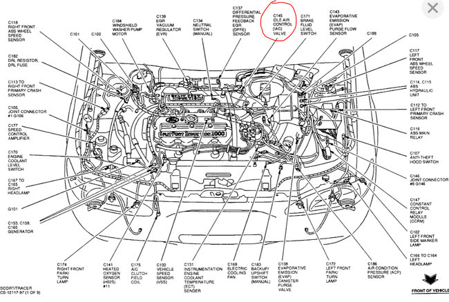

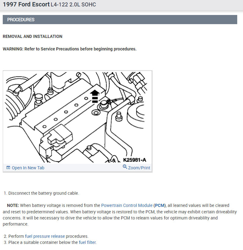

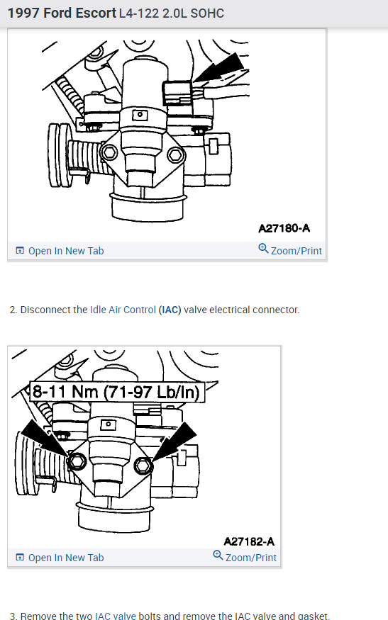

Typically a tune up includes changing of the oil and filter, spark plugs replacement, air filter replacement, fuel filter change, cleaning out the mass air flow sensor, cleaning the idle air control valve as well as the throttle body.
Here is a helpful article on tune up:
https://www.2carpros.com/articles/how-to-tune-up-a-car-engine
https://www.2carpros.com/articles/mass-air-flow-service
https://www.2carpros.com/articles/idle-air-control-valve-service
I have attached replacement procedures for the typical tune up items for your reference.
