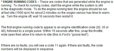

Well there something strange going on, I pulled the codes and there are mutiple, 15, 91, 13, 52, 21, 59, 34, 22. Is that a sign the eec is cooked?
Friday, September 24th, 2010 AT 9:06 AM
BADORDER
  • 11 POSTS
I tried to clear the codes by unhooking the sti jumper while key is on and codes flashing and codes will not clear.
Friday, September 24th, 2010 AT 11:39 AM
MERLIN2021
  • 17,250 POSTS

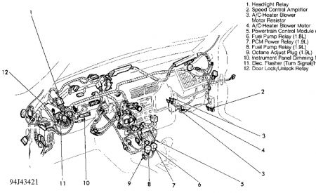

Didnt see the codes, here's the list, I would suspect a bad ground where one of the codes is power lost to keep alive memory while other circuits had power, check the PCM ground and power wires.

Check Pin #1 blue/red wire at the PCM, it's the Keep alive power wire. And Pin 40 for ground Blk/Grn stripe.
https://www.2carpros.com/forum/automotive_pictures/62217_PCM_conn_close_1.jpg
Use a pin to pierce the wire and test with DVOM. DO NOT try to put test leads into the PCM Connector holes, it will probably damage them. After these check OK re do the flash codes test with engine off ke o, then again like this to get the real results:
https://www.2carpros.com/forum/automotive_pictures/62217_Goose_test_1.jpg

I checked pin #1 has 12v and checked pin # 40 and it has good ground.I want to say also that this came about after I changed the head and timing belt, it was running prior to that. Ive checked all the wiring and eveything seems to be connected. Thanks for your time

On the lower right side of the engine find the Crank sensor and check to see if the plug is firmly pushed on and if there is any visible damage to the wires. Yes the VRES wire at the sensors should have 5 volts with the key on. The 214 code is just a code that seems to match your symptoms. Check the PCM Power relay. # 7 in the diagram.
https://www.2carpros.com/forum/automotive_pictures/62217_PCM_POwer_relay_1.jpg

I have voltage to the crank sensor and an output signal. The cam sensor has no voltage at all. All wiring looks good Why woold there be 9 codes stored in the computer and not be able to clear them?Also checked for ac voltage from the crank at the icm. There is voltage at the crank sensor but nit at icm.
