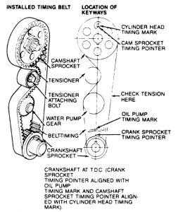

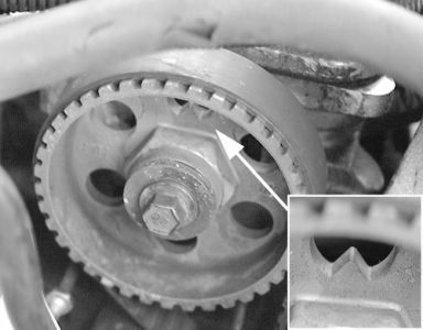

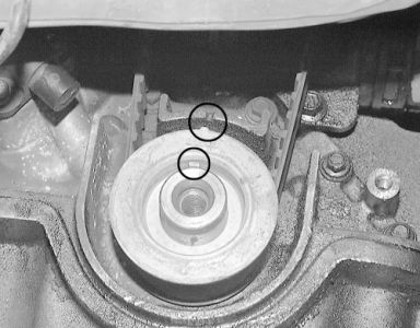

I have checked everything else including fuel rail and fuel pump, plugs and wires. I also checked the fuses and relays, everything was fine. I checked my timing belt and there was the problem. Missing teeth and timing off. I changed the timing bely and alternator belt and lined up my timing marks and tried to start it again and it backfired. How can I make sure it has the correct timing besides having my #1 pISTON UP, DOES ANYONE HAVE A DIAGRAM OF THE TIMING MARKS? Any response will be appreciated, Thanks.

Align the timing mark on the camshaft sprocket (arrow) with the timing mark on the cylinder head
https://www.2carpros.com/forum/automotive_pictures/261618_0900c1528008daaf_1.jpg
Confirm that the timing mark on the crankshaft sprocket is aligned with the timing mark on the oil pump housing
https://www.2carpros.com/forum/automotive_pictures/261618_0900c1528008dab4_1.jpg
Timing belt installation guide and alignment marks
https://www.2carpros.com/forum/automotive_pictures/261618_0900c1528008dab8_1.jpg
