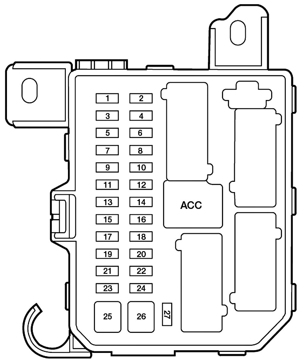

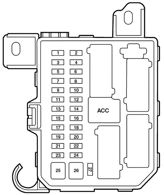

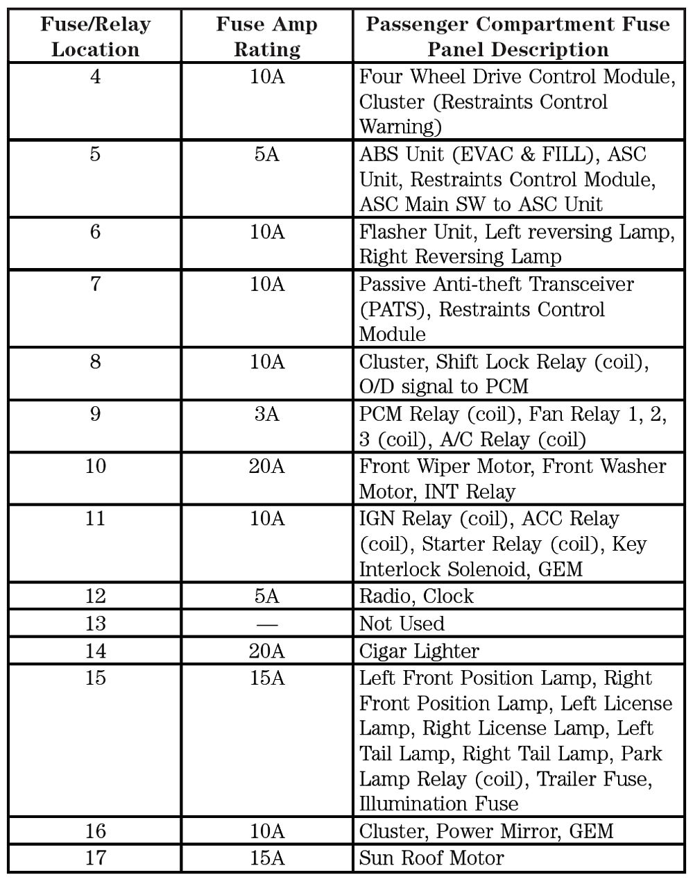

It could be the flasher has failed. However, the idea that you had to push it in place may indicate there is an issue with the electrical connectors where it mounts. Remove the flasher. Take a flashlight and check to make sure none of the connectors in the plug are pushed back inside eliminating the connection to the flasher.
If that is good, check fuse 6 in the fuse box located in the vehicle passenger compartment. I attached a picture of the box and legend. If you noticed, the reverse lights also use this fuse, so you can check if they are working. If they are, the fuse is not the problem.

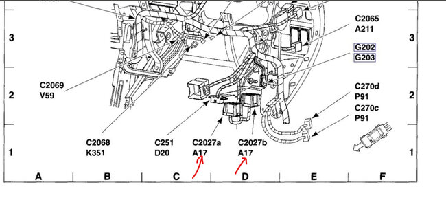

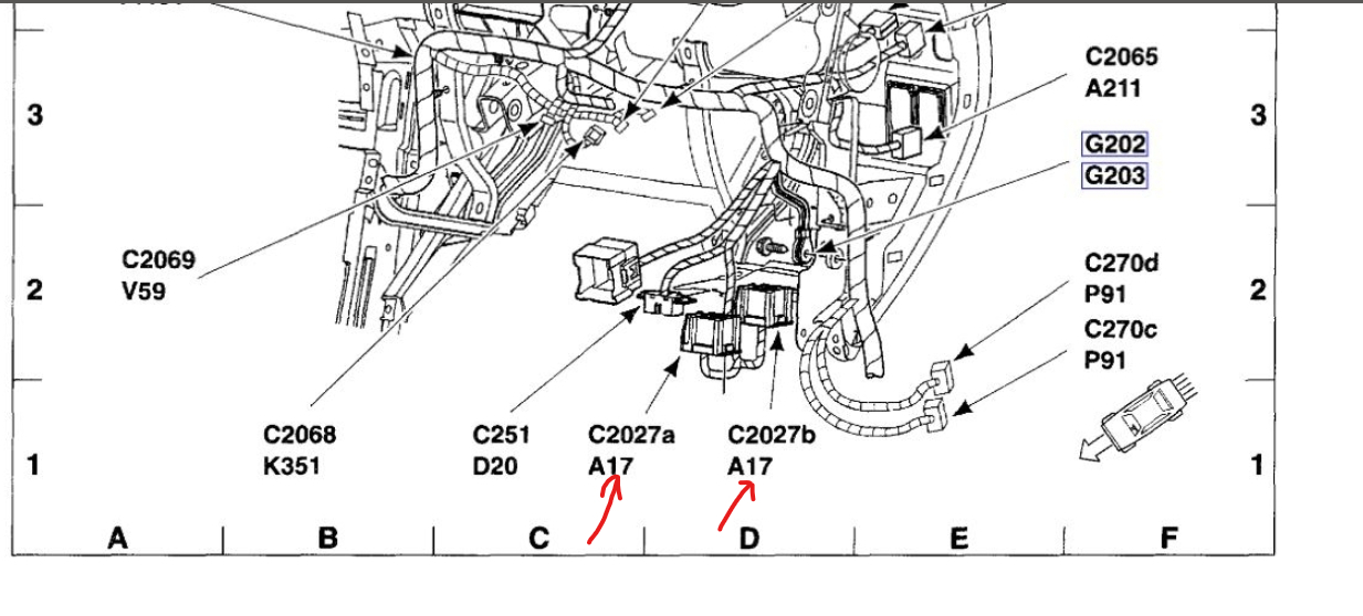

Where is the turn signal flasher or flashers located? Looked all around found where the hazards are flashing from under dash but it is not a flasher. Thanks
Nov 26, 2020 at 12:14 AM (Merged)

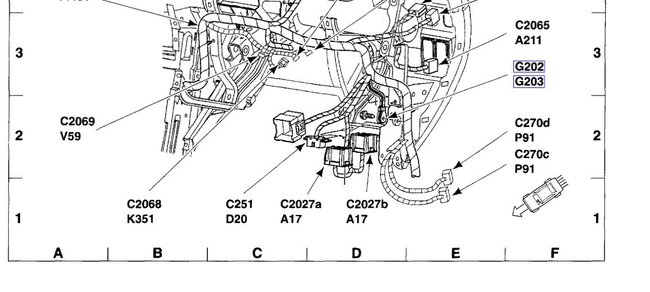

Good afternoon.
The flashers are not like the old type. They are relays.
I attached a picture of the location for you. They are under the left side of the dash.
They are marked A17 in the diagram.

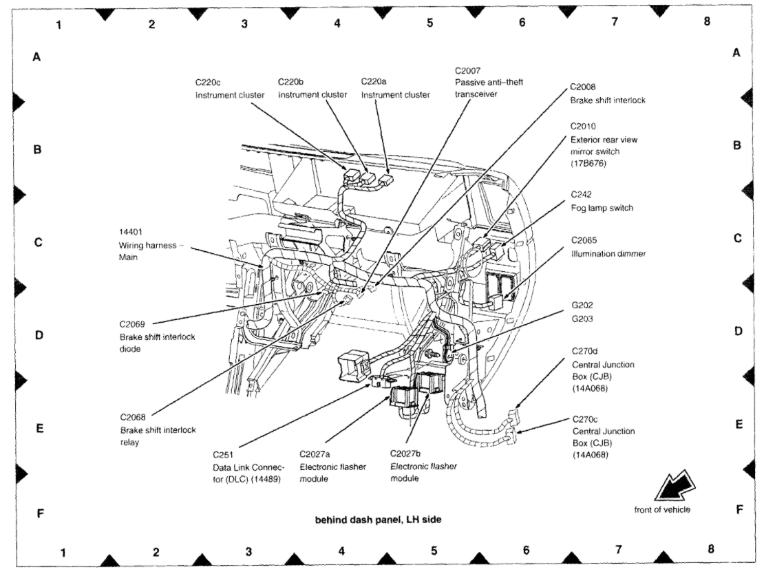

I have a replacement flasher on the way. How do I get to it? I don't fir under the dash unless I maybe take out the driver's seat
Jan 28, 2026 at 10:02 PM
  • 55,093 POSTS
it looks like it is on the driver side dash up underneath. Here is the location, match the new one up to the old unit to be sure. Check out the images (below). Let us know what you find.
Jan 29, 2026 at 1:03 AM

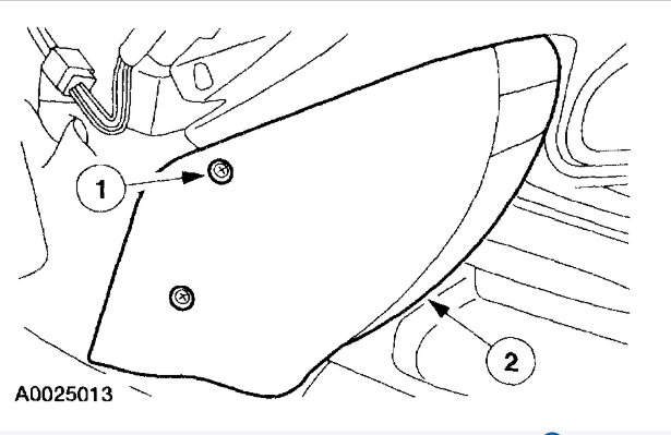

How do you access the flasher?
Feb 2, 2026 at 2:43 AM
  • 55,093 POSTS
You need to remove the lower dash panel on the drivers side.
Feb 2, 2026 at 4:38 AM
MACKO
  • 10 POSTS

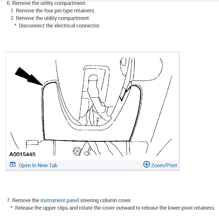

So how do I remove the lower dash panel?
Feb 2, 2026 at 5:25 AM
  • 55,093 POSTS
Sure, here are images to help you remove the lower dash panel. Check out the images (below). Please upload an image or a short video in your response, so I can see what's going on.
