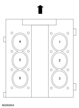

My escape has a misfire 5 cylinder
I was told to try tuneup which was done
25,000 ago. What else should I try
I get the parts for my mechanic and he charges me for
Labor. What should I get for tuneup other than wires
and plugs

OK, actually the first thing I would do since it has coil overs is to change the location of the coil Move the #5 coil to #4, if misfire code moves to the #4 cylinder then replace the coil.

Already did that twice and within 100 miles ran crappy
again and light back on either blinking or stays on
Going to try tuneup next with new wires and plugs
What other things would I change for a good tuneup
I have a friends mechanic doing but he doesn't speak
good English and hoping you can list what parts needed for
tuneup to maybe help my issue

OK, you say you relocated the Coil twice, did the same code show up or what. Please be as detailed as possible. As far as a good tune up, on newer vehicles - Plugs, Wires, Air Filter and PCV Valve if equipped.

What do I do when there's a cylinder 4 misfire on a 2001 Ford Escape V6?
Thursday, July 19th, 2018 AT 2:19 PM (Merged)
  • 75,992 POSTS
Check that cylinder sparkplug, compression and injector-start here-
WRENCHTECH
  • 20,761 POSTS
This is a coil on plug system so it's usually a bad coil in that situation. If you have over 70K, change all the plugs too.
