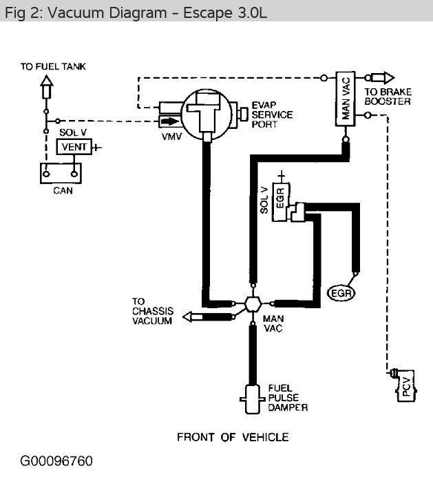

The lines going from the valve cover to air duct /breathers are not vacuum only the pcv is if you are good with a scanner freeze frame it and check your voltages if a sensor is bad can cause that also check grommets for air leaks. I'll send a vacuum diagram in next email because our site has changed and I can't do it on a reply.

See pic
