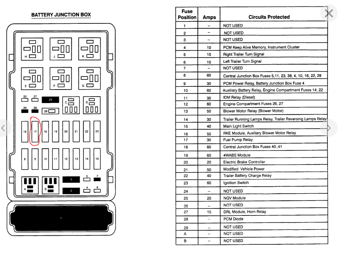

Eng. Spins will not start scan tool will not connect to computer. Cannot find any blown fuses?

When you turn the key to the on position, does the fuel pump kick on?

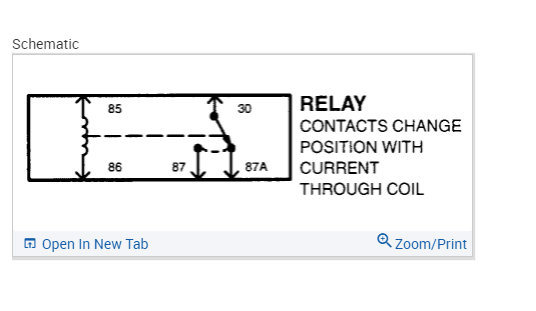

An inoperative fuel pump can be due to a bad relay, faulty wiring or a bad pump.
Checking the fuel pump relay is a good place to start.

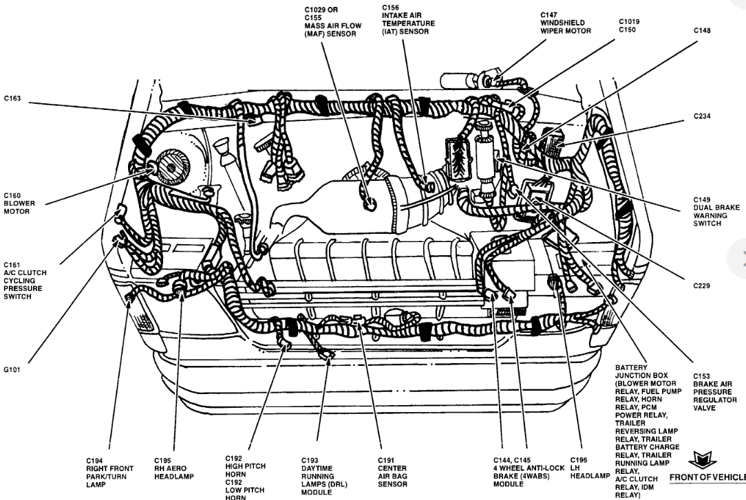

That relay is located under the hood fuse box (see diagram).
Check for corrosion and burnt pin(s).

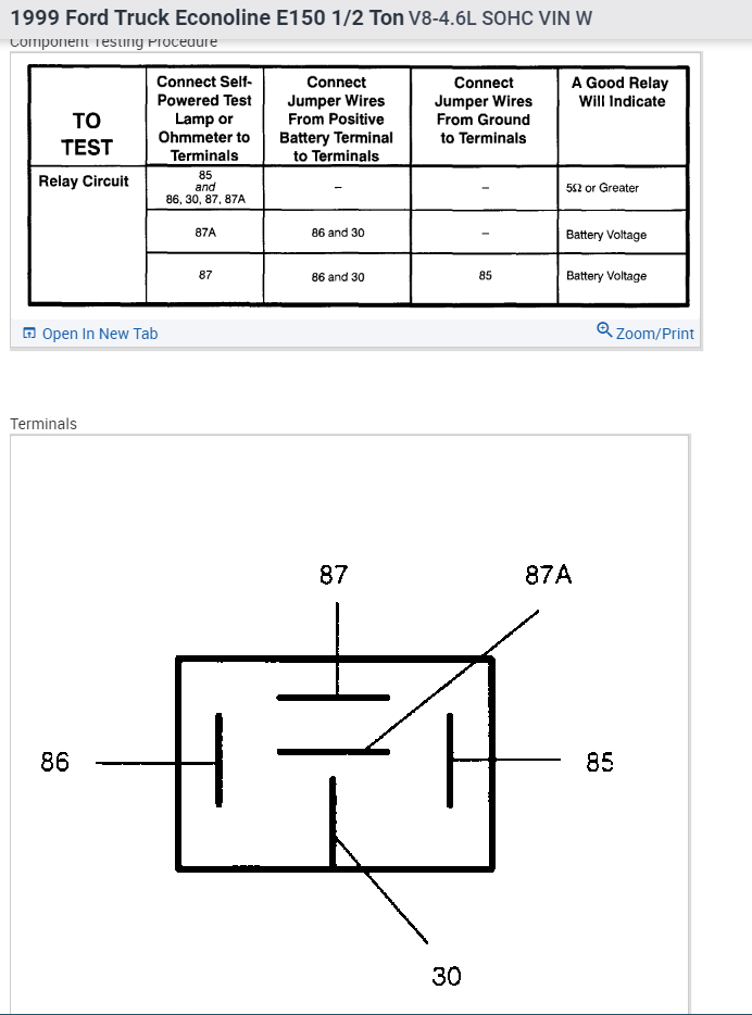

Here is a guide on how to test relays:
If the relay is good, then check to see if there is power to the fuel pump. If you have power, then the issue is a bad fuel pump and will need replacement.
