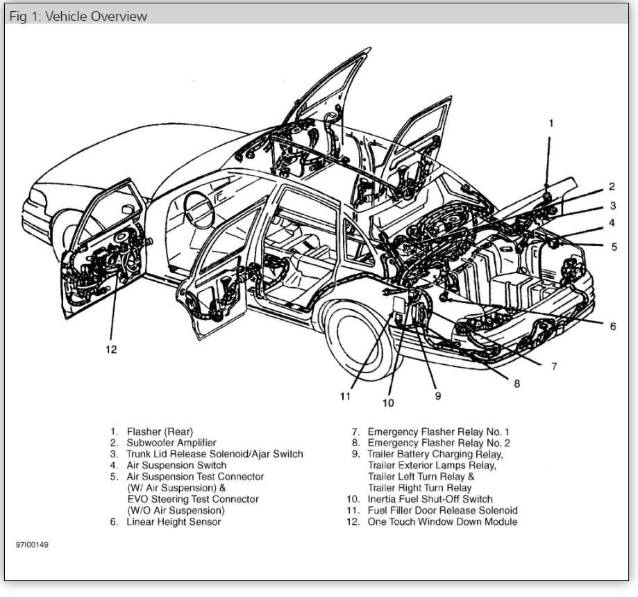

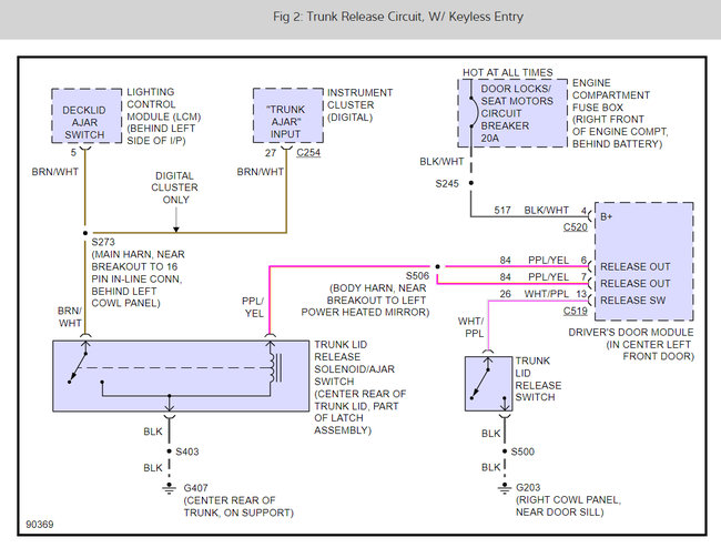

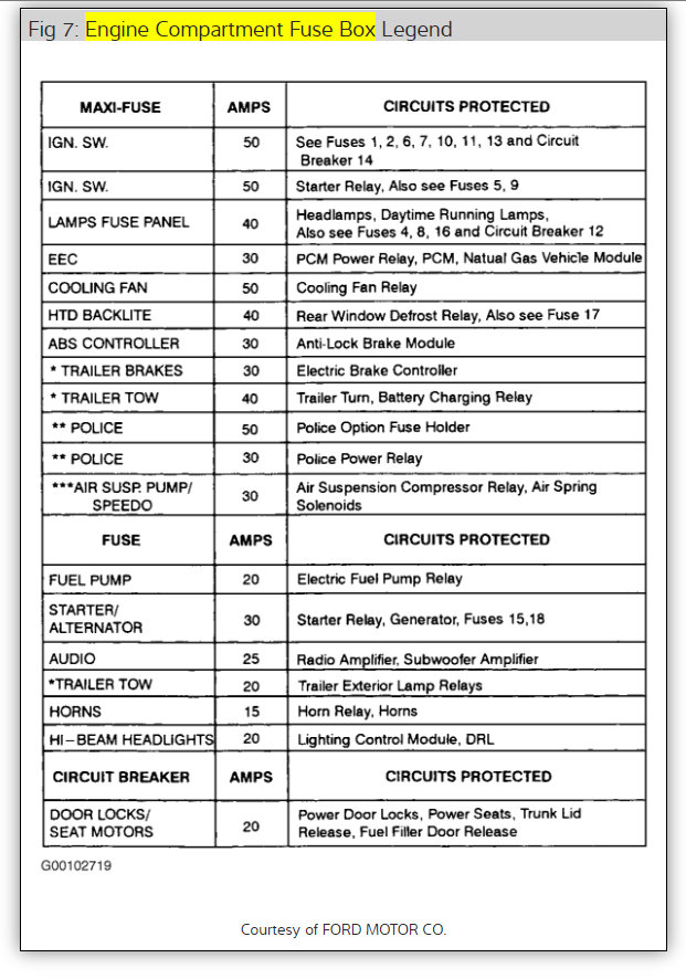

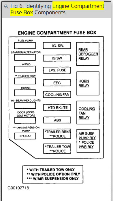

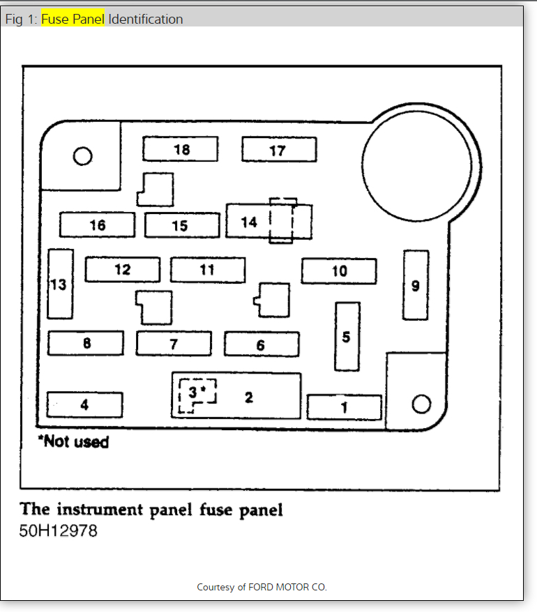

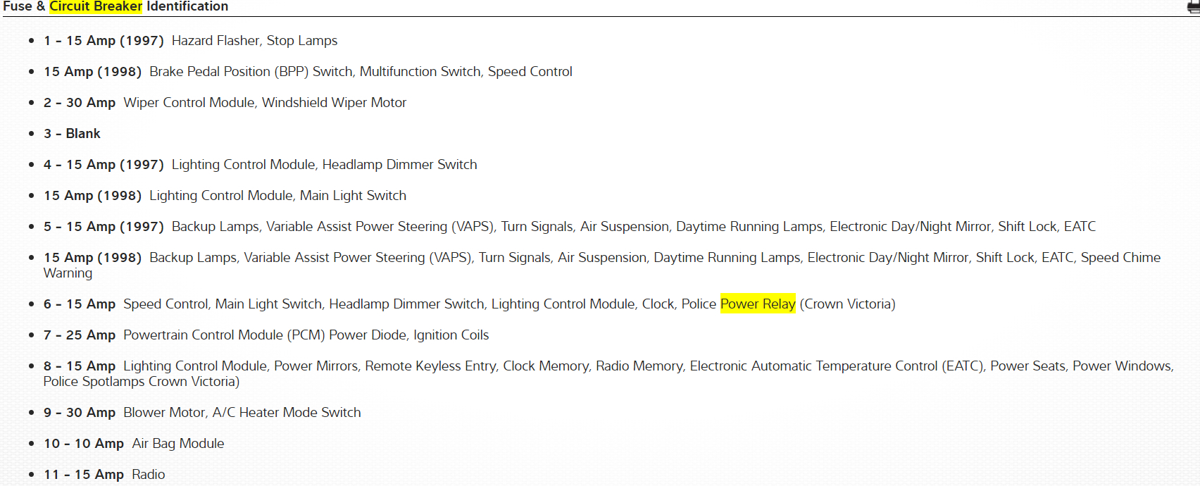

The above item will not work. I tried manual and remote and they will not work.
Sep 2, 2010 at 2:42 PM
  • 110,193 POSTS

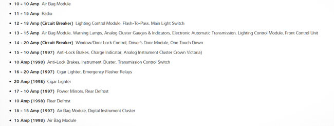

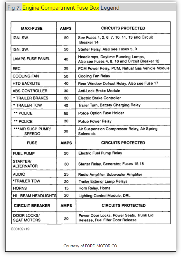

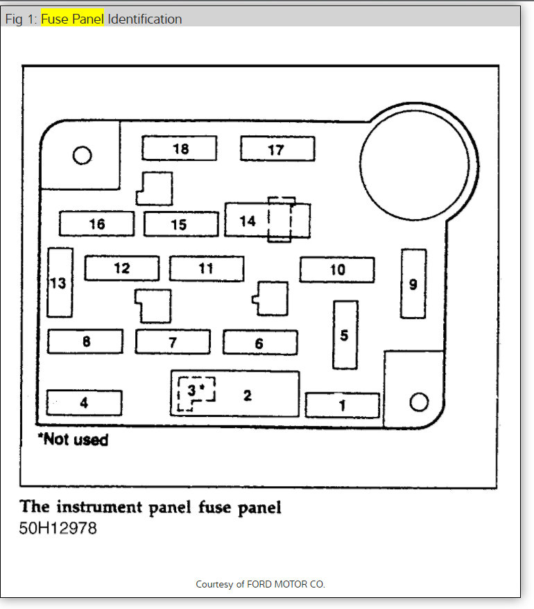

There is a trunk release relay and fuse that needs to be checked. Here is the trunk wiring diagram so you can see how the system works and two guides to help you check the problem out:
and
Cheers
Sep 3, 2010 at 7:33 AM
KENDRARUSSELL
I had this problem until I replaced the trunk solenoid, FYI.
