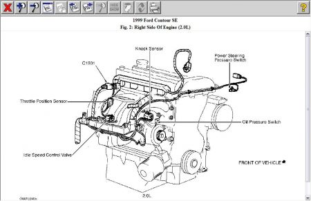

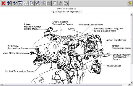

I have a 99 Ford Contour SE. 165,000 miles, automatic, trans, 4 cyl engine.
Car runs fine, however, when I turn the A/C on it revs, then putt-putts, revs, then putt-putts, and then after about 4 times, will stall.
Doesn't happen while driving or giving it gas in park and neutral.
Could this be a fuel filter or fuel injectors?
Thanks!
Wednesday, October 10th, 2007 AT 4:20 PM
3 Replies
  • 75,992 POSTS
Inspect and test the idle speed control motor/valve might not be adjusting the idle for the AC load
Wednesday, October 10th, 2007 AT 4:38 PM
NICKFLAC
Thanks! Where exactly can I find it. Or should I let a pro look at it?
Wednesday, October 10th, 2007 AT 4:59 PM
  • 75,992 POSTS
Below is for 2.0 and 2.5 engines
2.0L
https://www.2carpros.com/forum/automotive_pictures/12900_1999_ford_contour_SE1_1.jpg
2.5L
https://www.2carpros.com/forum/automotive_pictures/12900_1999_ford_contour_ISC_motor_1.jpg
