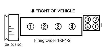

My car started having a rough idle then it got to where if I stopped at a light I had to jeep one foot on the brake and the other on the gas so ot wouldn't die. The idle got so rough the whole car would shake all over. Since the engine light was on I had it checked. The code sai the 2nd plug was misfiring and the #1 O2 was too lean. I changed the spark plugs and now the car won't even start. My husband says the timing is off. His nephew says it's the IAC sensor. Do you have any answers?

DAVE H
  • CAR REPAIR CONTRIBUTOR
  • 13,384 POSTS
make sure you have the plug leads on in the correct order .. if they are not on correctly the car will not fire up ..
https://images.2carpros.com/forum/automotive_pictures/266999_fire_1.jpg
