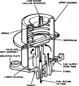

fuel pressure regulator how hard is it to change
Monday, January 11th, 2010 AT 10:42 AM
  • 75,992 POSTS
The fuel pressure regulator, Fig. 7 is located on the fuel supply manifold
https://www.2carpros.com/forum/automotive_pictures/12900_fp_regulator_1.jpg
Remove vacuum line at pressure regulator, then the regulator housing attaching screws.
Remove pressure regulator assembly, gasket and O-ring.
Reverse procedure to install, noting the following:
Lubricate fuel pressure regulator O-ring with suitable oil before installation.
Torque regulator housing attaching screws to 27 - 40 inch lbs. on 4-140, V6-183, 6-300 and V8-302 engines, or 71 - 102 inch lbs. on V6-177 engine.
