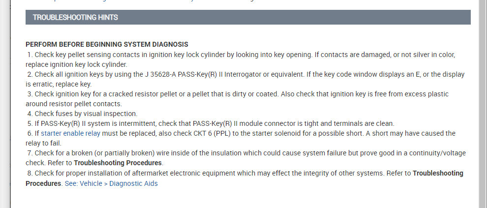

First thing I would suggest is to perform an anti-theft, security system reset. Here is the tutorial showing how to reset:
https://www.2carpros.com/articles/how-to-reset-a-security-system
Scroll the page to find the additional GM instructions.

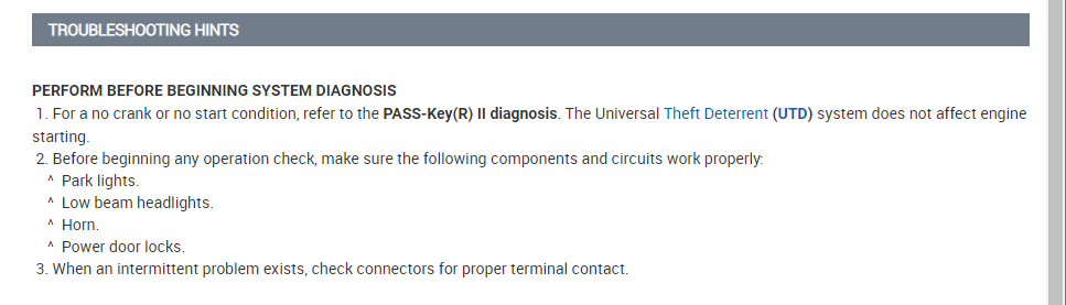

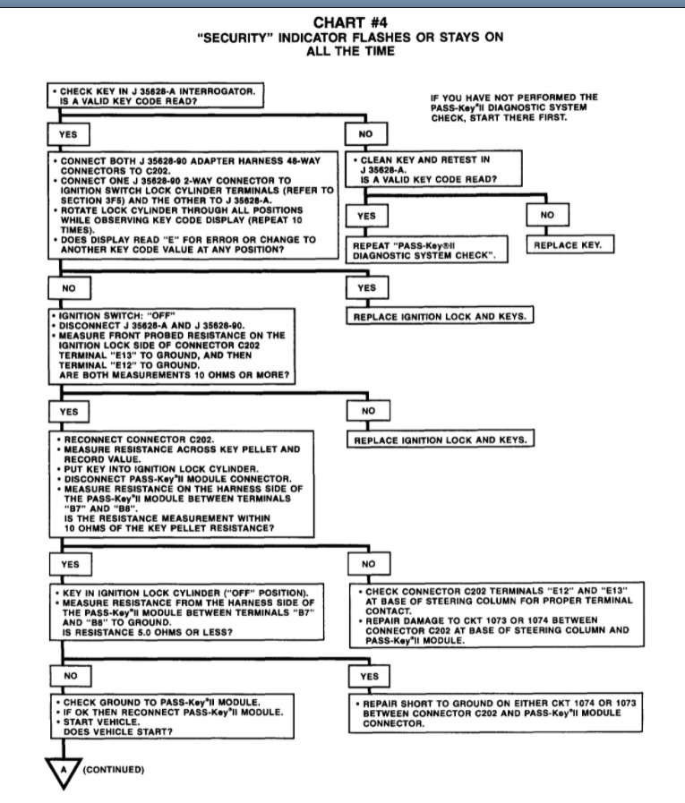

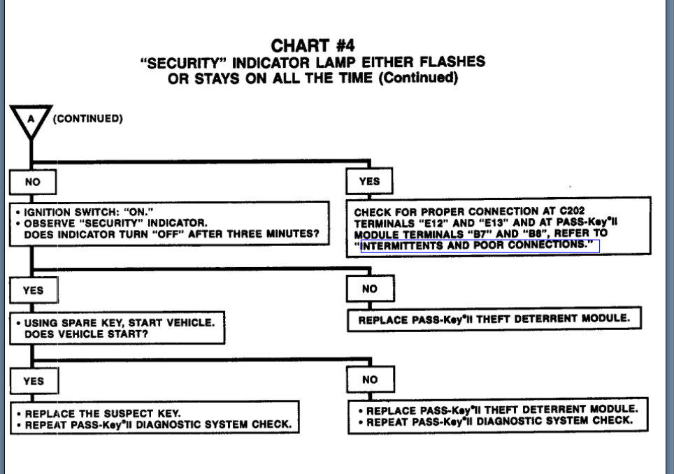

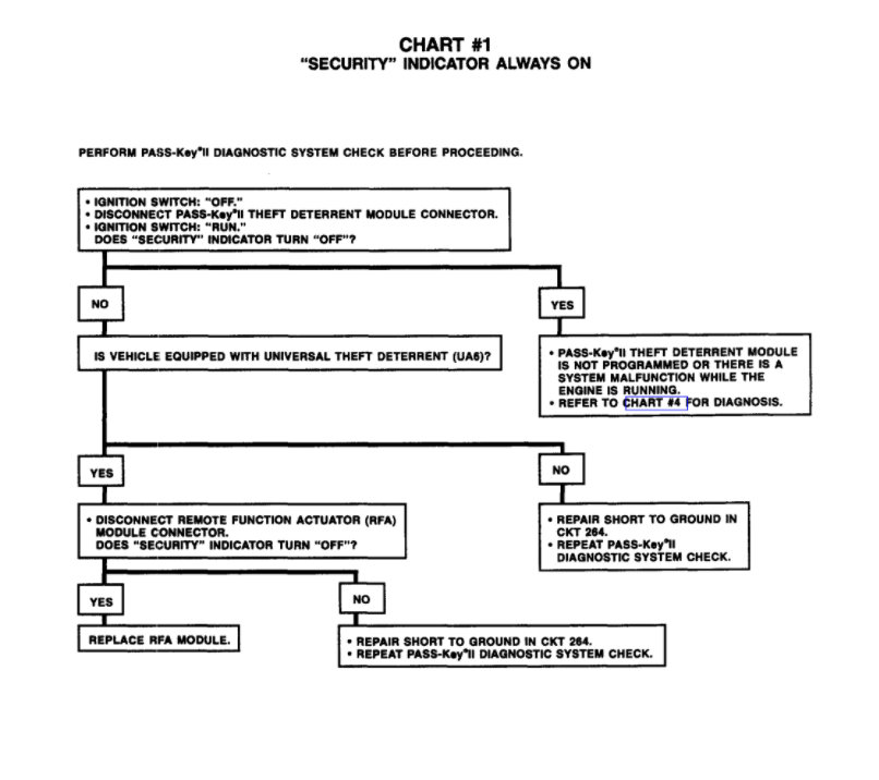

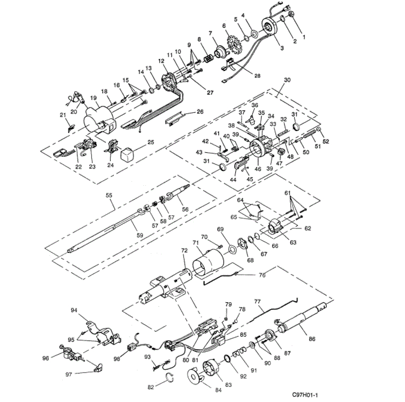

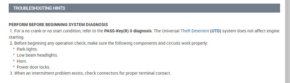

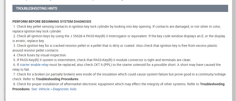

I am also attaching all the info from the manual that includes some flow charts that are for the theft light staying on all the time or flashing.
So let's run through all this info and go from there.

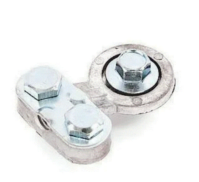

Also, the side mount battery terminal replacements are easy to find. Most parts stores will have them in stock.
I attached a pic below of what I believe you need.
See pic below.

Thanks for your suggestion for the part I need, but I already have purchased the battery terminal bolt (set of 2), and all on that concern has been taken care of.

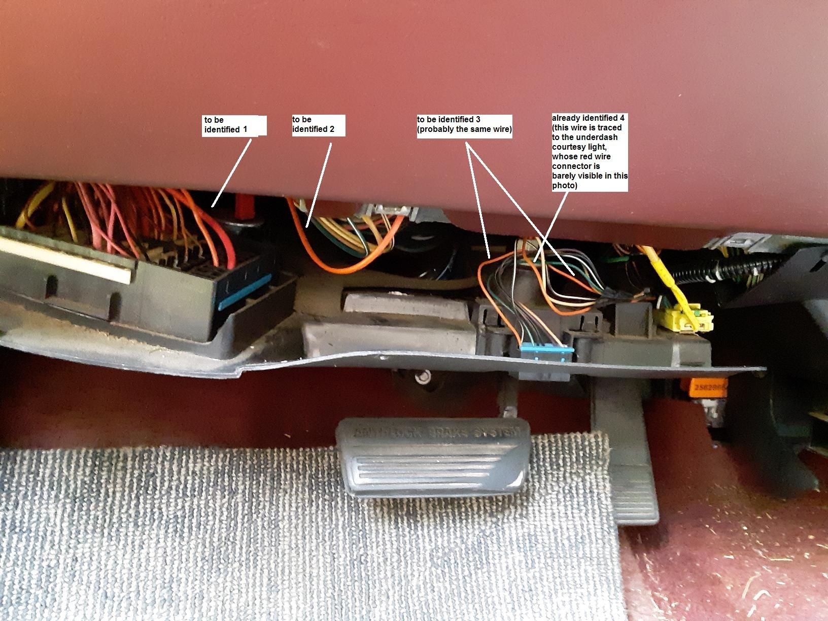

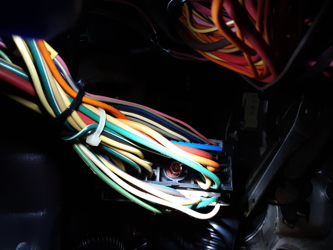

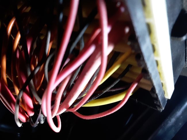

As I prepared to cut the ignition security sensor (orange) cable this afternoon, I discovered there seems to be two orange wires under the dash. One orange wire runs from the below-cash connector assembly (located to the right of the below-dash fuse box, and directly below the steering column), and the other orange wire seems to emerge from behind the main wire mass/bundle, upward, toward the ignition switch. Now that I reconsider, this could be the same orange wire, seeming to run upward, then looping down into my view, before disappearing upward again, to connect with the ignition switch.
Until I take apart more of the under-dash panels, I cannot say, at this point.
I have included two photos for your comment.
Sep 30, 2021 at 7:17 AM

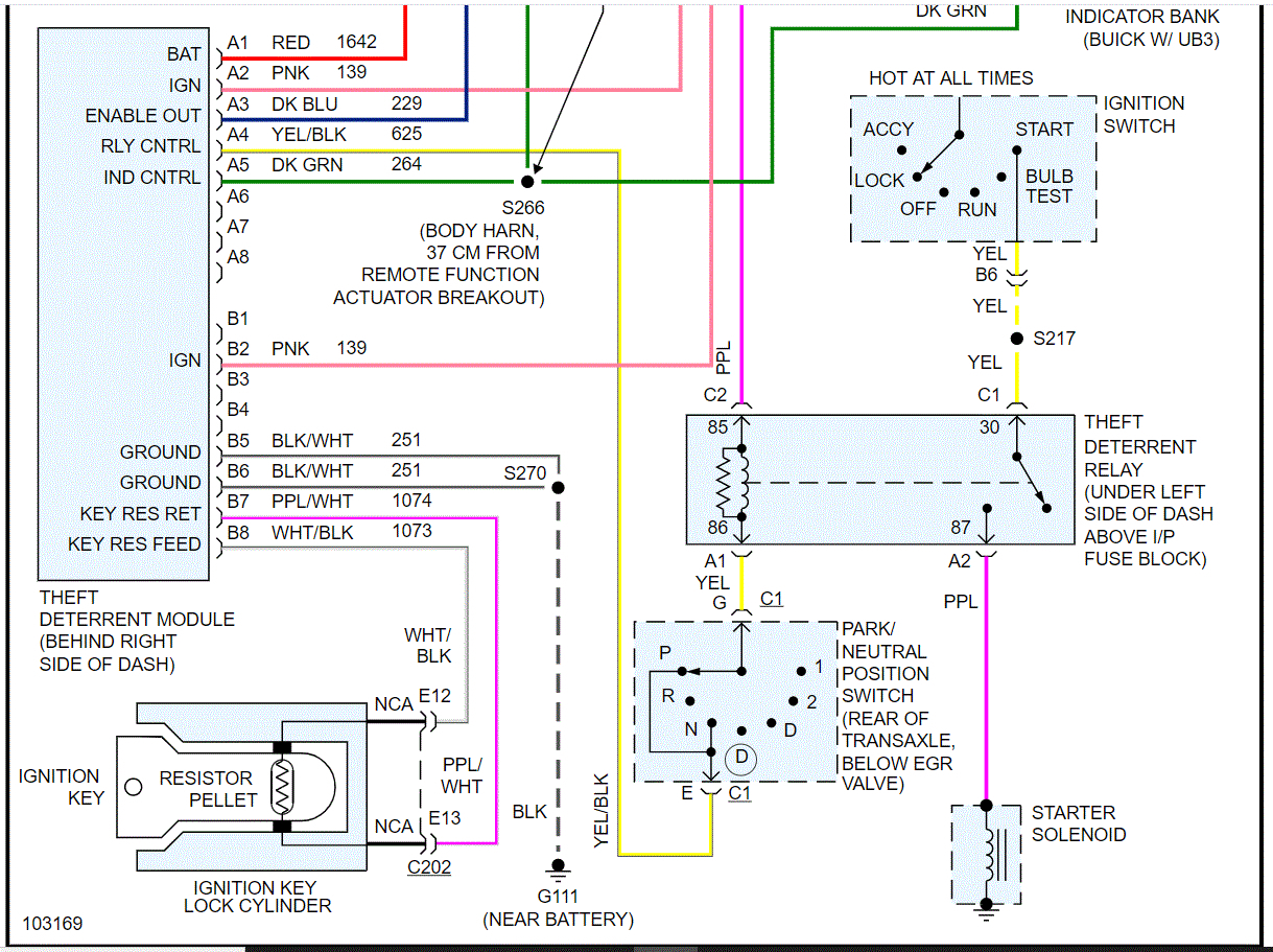

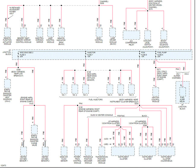

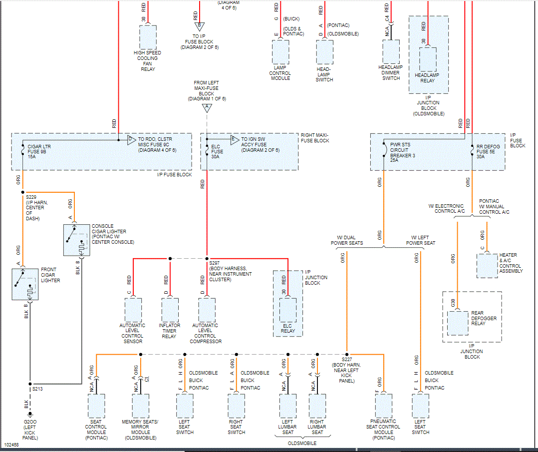

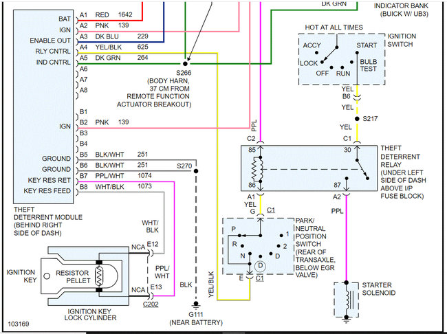

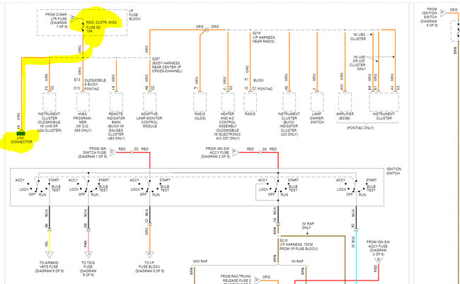

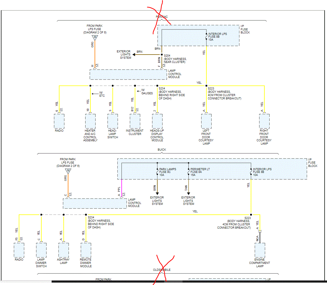

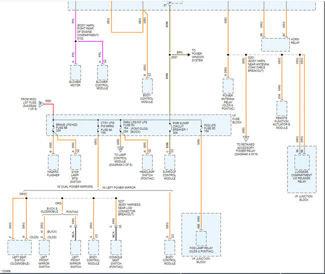

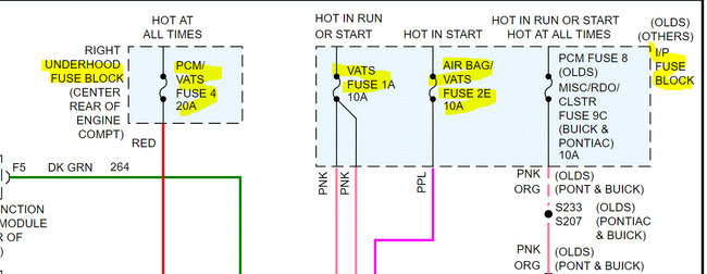

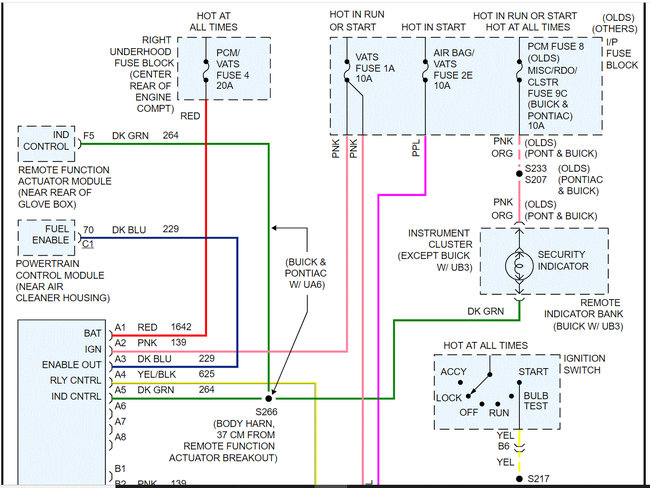

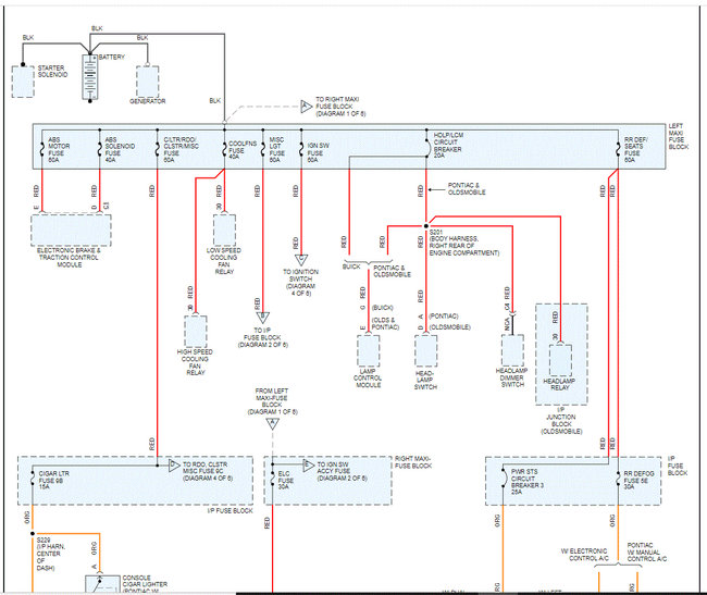

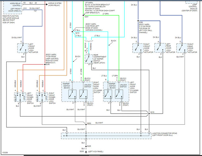

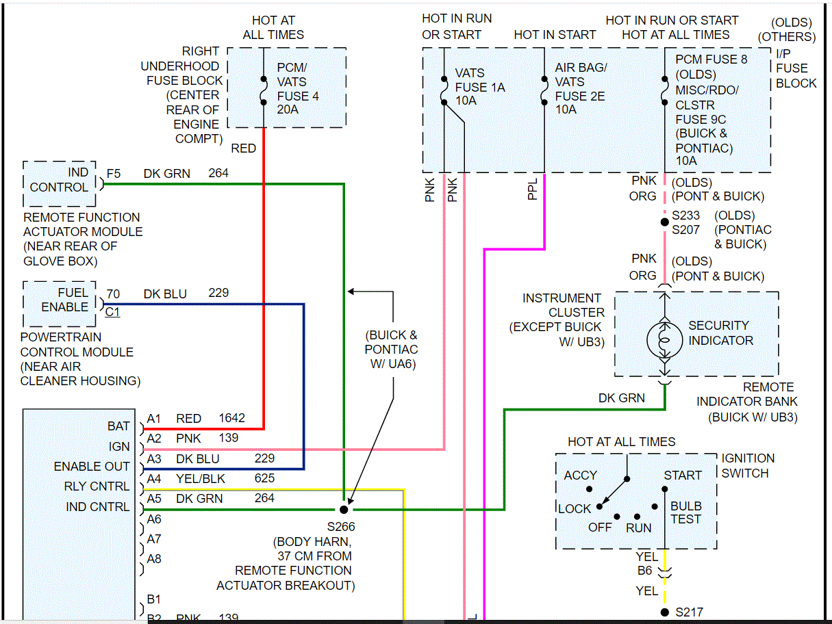

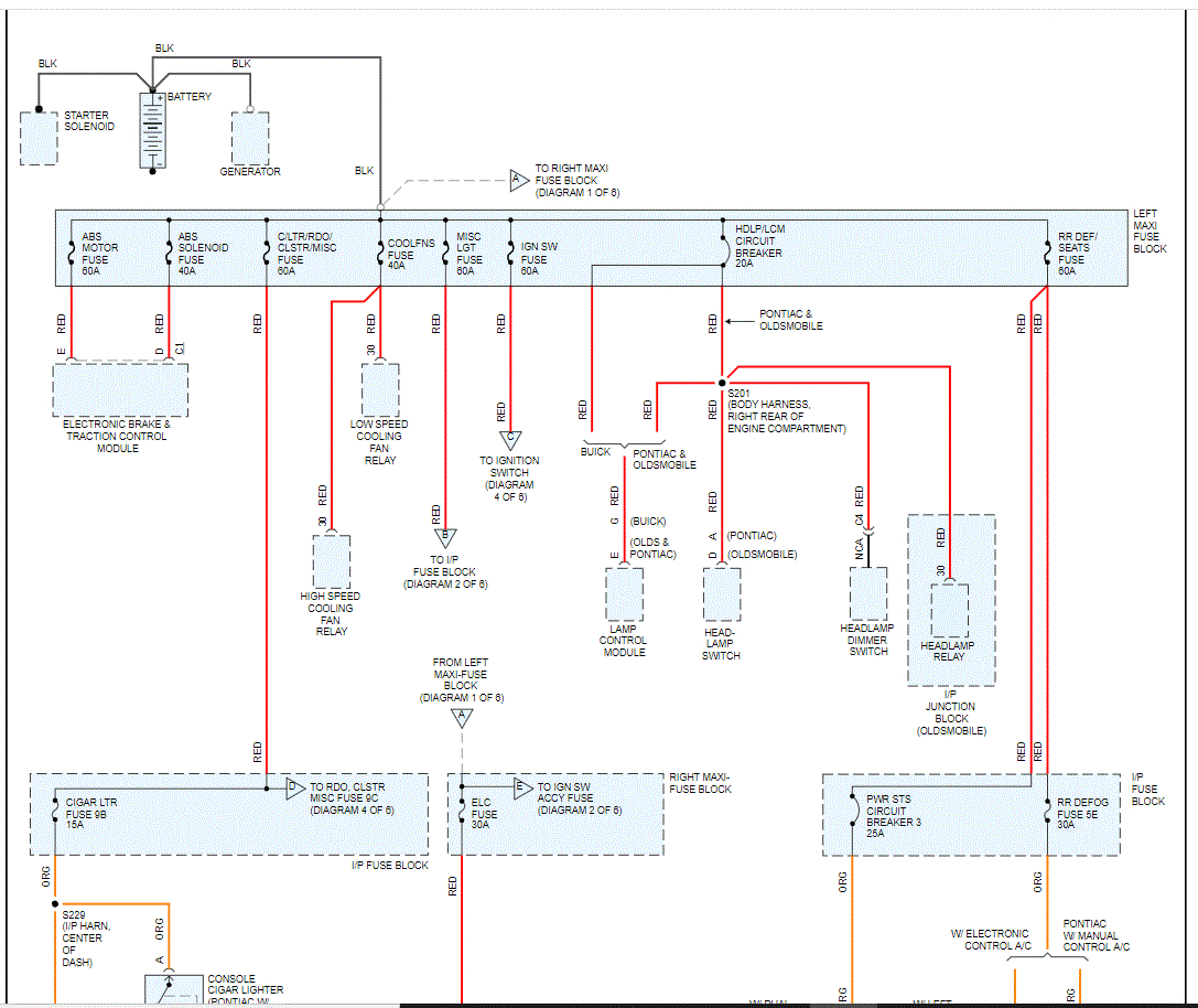

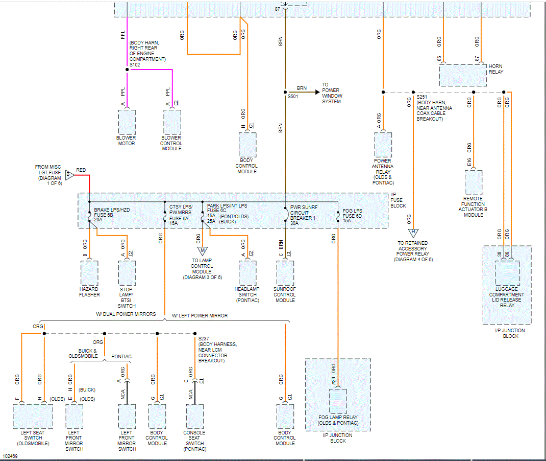

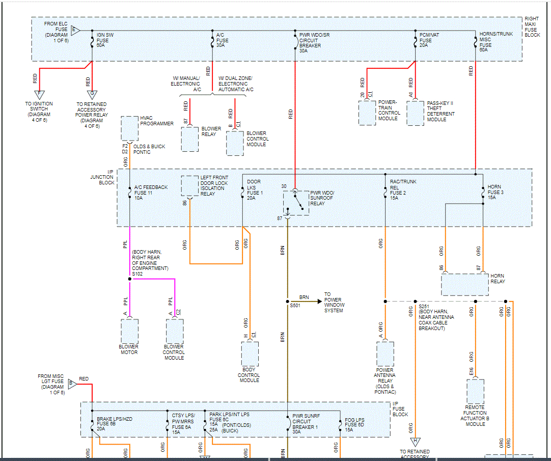

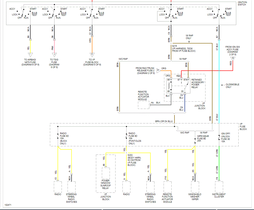

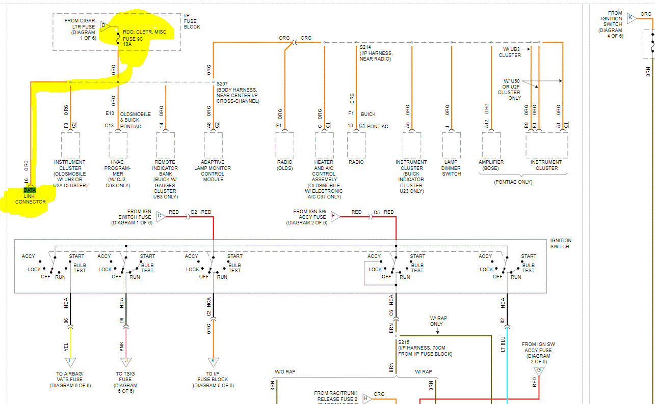

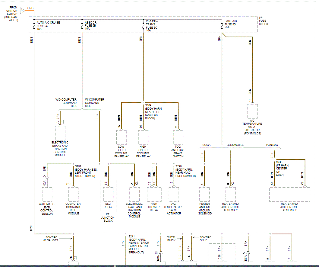

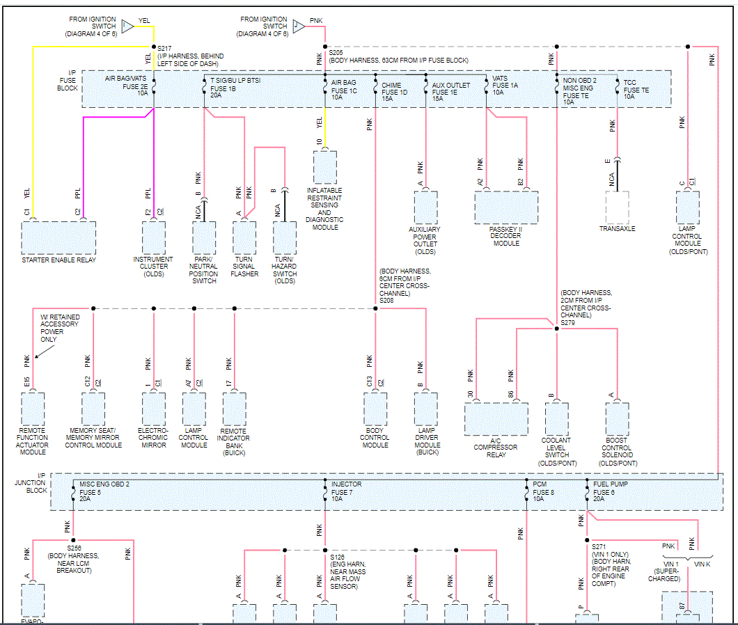

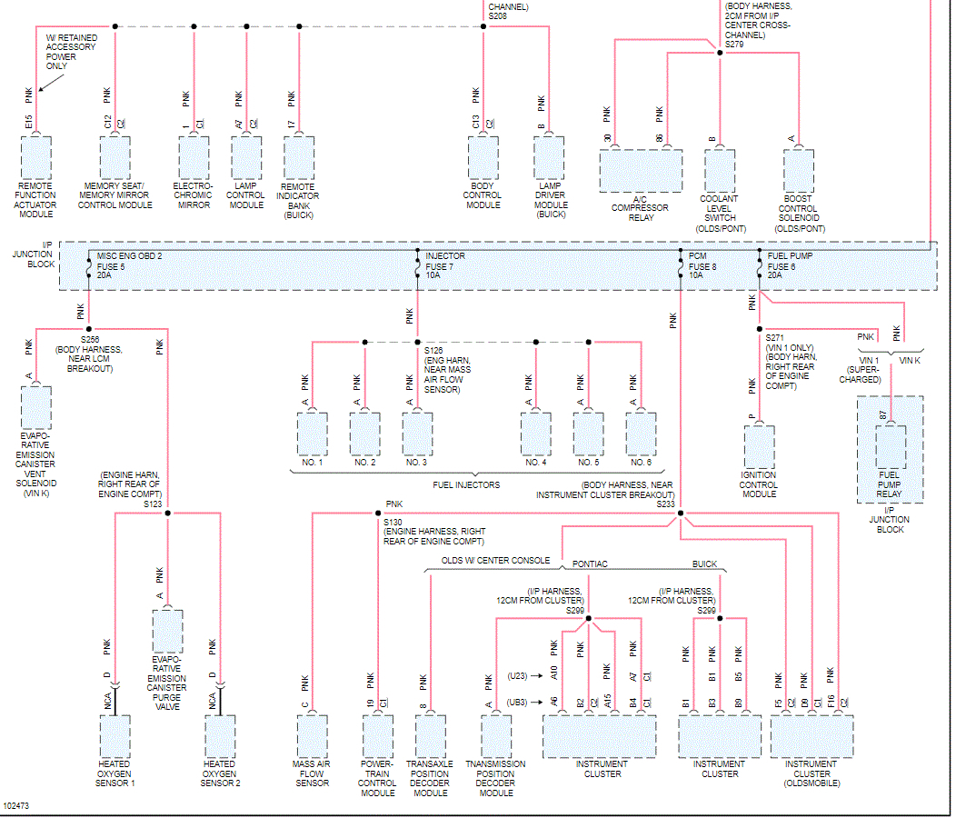

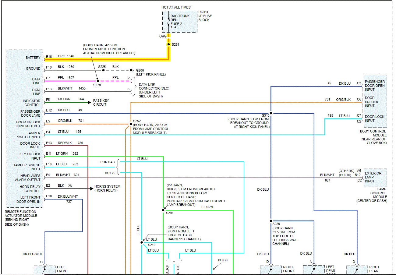

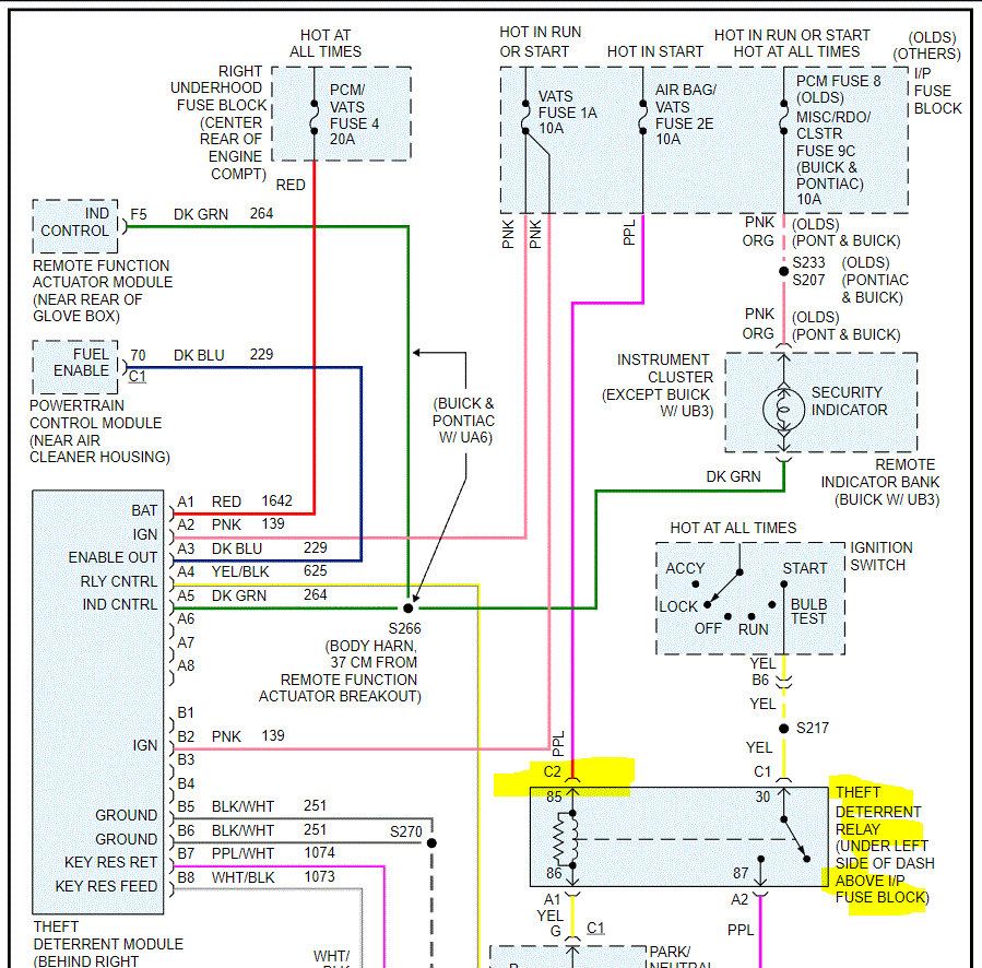

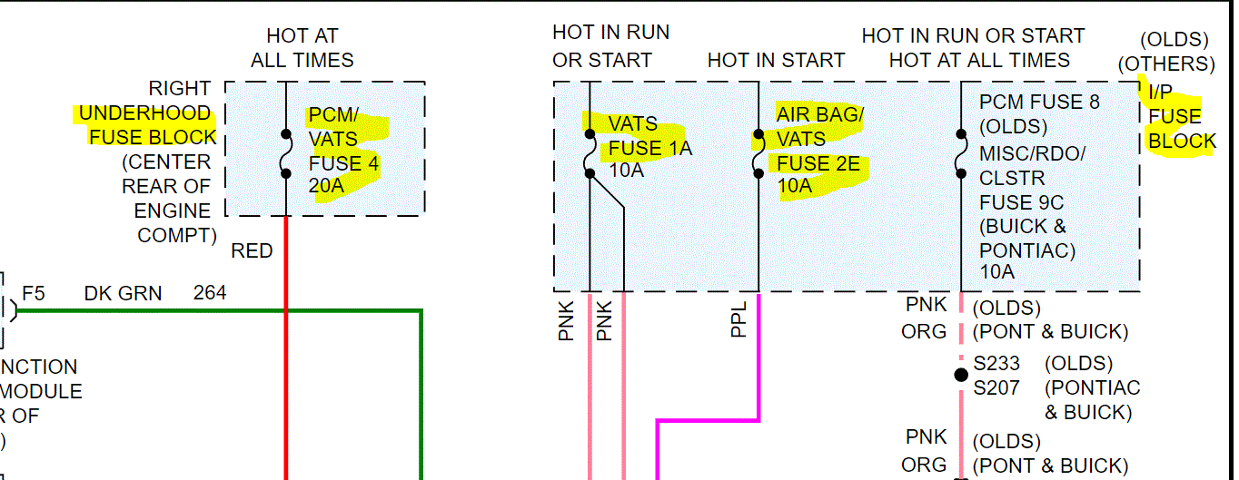

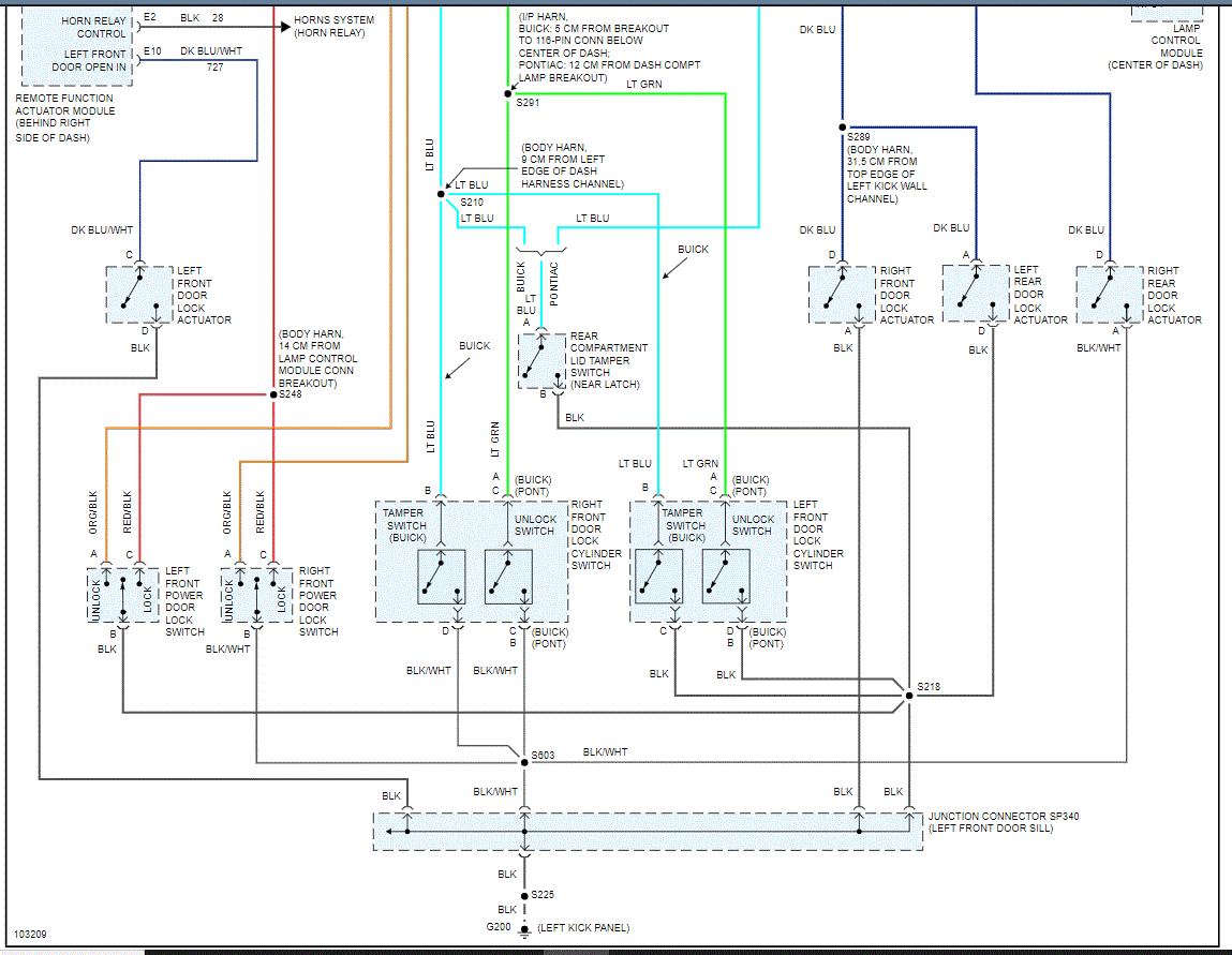

I attached the wiring schematics for both the pass key circuit and the forced entry circuits below.
Pic 1 and 2 are the forced entry circuit. I'm seeing one orange wire that supplies power to the remote actuator module. There are a few that are orange with a black tracer, but the pic appears to be solid orange.
Pics 3 and 4 are for the anti-theft pass key circuit. There are no orange wires.
Follow the orange wire and see if it goes to the right-side instrument panel fuse box.
See pic below: Note I had to cut each schematic in half to make them readable for you. I did overlap them so you can follow from one to the next.

Pics 3 and 4 for the anti-theft passkey circuit are the only diagrams that seem to apply to VATS and the ignition pellet key. Soon, I'll send photos of the actual wiring beneath the dash, in all their glorious colors (including orange) and all rendered in sharp focus.
Sep 30, 2021 at 2:18 PM

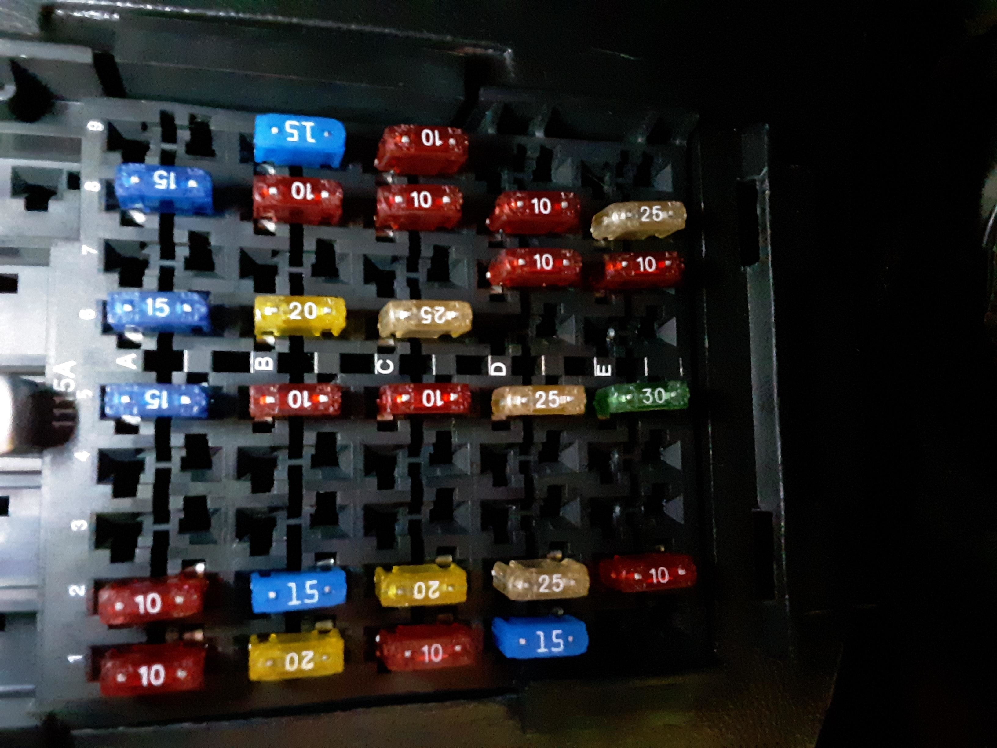

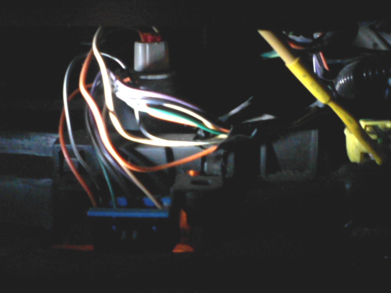

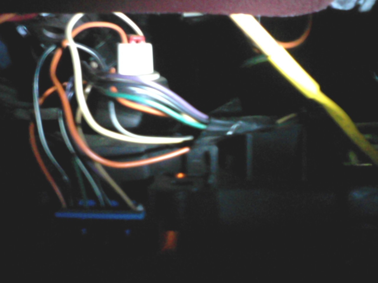

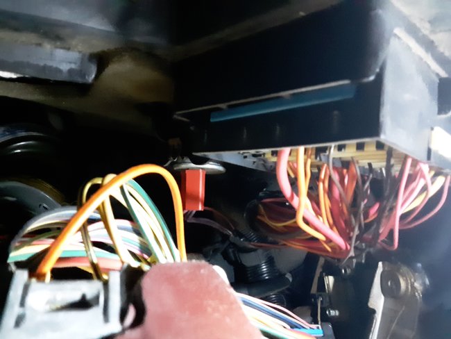

Here is a photo of the under-dash fuse panel, and a frontal view of under-dash wiring. I hope to select the correct orange wire which controls the VATS system from the ignition key. As you will see immediately, these photos are much better quality than the two (above) which were sent earlier.
In the photo of under-dash wiring, I have drawn arrows to the prospective orange wire to be cut. Regarding "To Be Identified" orange wires 3 and 4, they emerge from the same black tape-wrapped wire bundle (to the left of the airbag's yellow wire). Wire 4 has been traced to the under-dash courtesy light (with small red plastic connector), and Wire 3 runs from the wire bundle to the EBD socket. From the photo, alone, neither of those seems part of the VATS ignition wire circuit. Your wiring schematic 3/4 may have clues I missed.
Your own confirmation/advice will make the critical difference before I cut any orange wire. Of course, I could cut by trial-and-error, but rather would plan ahead, than regret, later, when possible.
In the photo of the interior fuse panel, I provide you a reference photo for other questions, later, if the orange wire trick does not work.
Oct 1, 2021 at 6:51 AM
  • 110,251 POSTS
The vats schematic doesn't indicate any orange wires, which is confusing me. I tried looking through the power distribution schematics (6 pages long) and there must be a hundred orange wires, none of which are related.
In the pic, the left wire appears to be going to a fuse box. What fuse is it powering? Also, since I don't have a schematic specific to the ignition switch, the best thing to do is follow the wire to see if it goes to the switch. It's near the bottom of the steering column. See pic 1.
Not being there is making me nervous to indicate which to cut. I don't want to arbitrarily pick one and be wrong causing you more work. I hope you understand.

Joe, thanks for the continued effort. As a (computer) tech support person, myself, I fully understand the task can be difficult. However, to be clear, I ask for only your advice, not to have you make the decision for me.
The immediate problem is to determine which orange wire leads to the ignition VATS module. What I plan to do is take apart the dash further and see whether I can trace physically the orange wire. Later, perhaps I can send a better photograph of the wiring paths.
Ideally, if I were able to go further into the steering column, I could do a continuity check between each of the orange wire(s) at the subdash connector panel and any orange wires going into the actual ignition switch area.

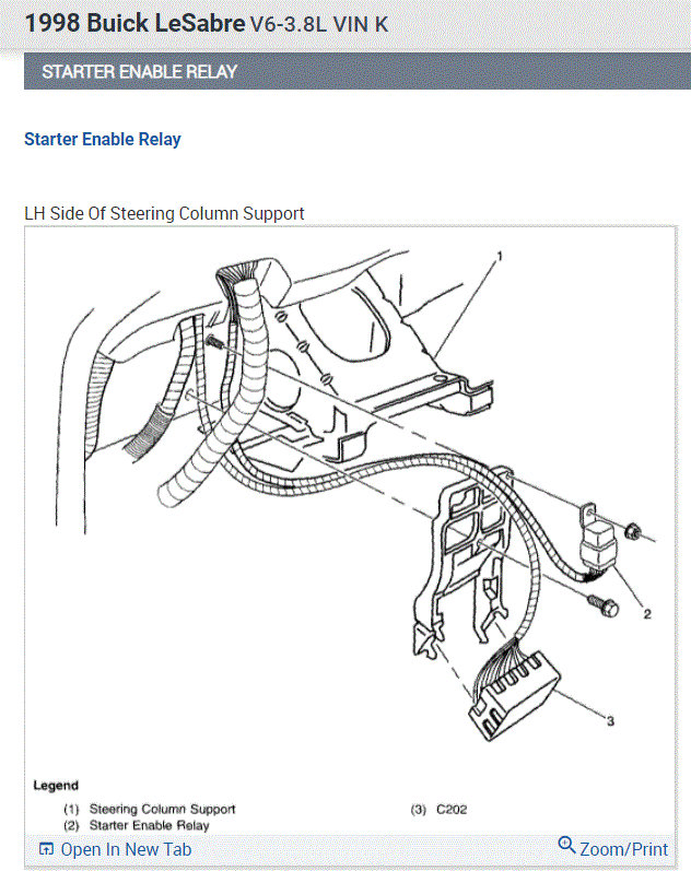

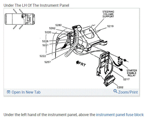

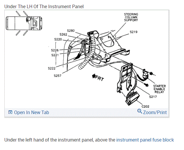

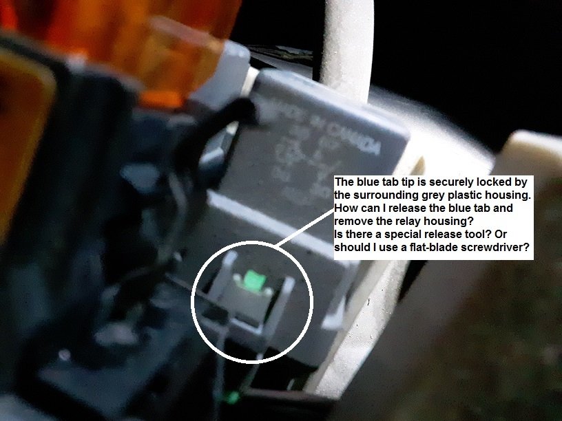

Question 3-- Looking ahead, how can I release the starter relay retainer clips-- one each each side of the relay? I don't want to break the aging plastic retainer clips. Obviously, I cannot simply pull off the relay housing cube with a large-span pair of pliers (Channel Lock or Vise-Grip). Would you insert a flat-blade screwdriver beneath the clip? Is there a special puller for a plastic cube relay? Do you need a photo?
Question 4-- Fuse Panels
While the shifter was in PARK and ignition was on (all warning lights on), but the key released from its start engine position, I checked the interior subdash fuse panel fuses with a circuit/continuity checker. All of row 2 fuses (A through E) are off/out when I touch the two contacts on each fuse. (Since all row positions 2A-2E are labeled "spare", that presumably means they are not connected to any circuit). Fuse 2E, according to the Fuse Usage label on the fuse panel cover, is a red 10a spare for "AIRBAG/VATS". Of all active fuses in the panel, there is only a single fuse labeled "VATS" on row position 1A, and that fuse is on when I touch each of its two contacts with the circuit tester.
I have not yet checked the Maxifuse panel above the engine but have succeeded in opening the fuse panel cover without breaking the white, twist-open plastic connectors. My next step is to check all fuses in that panel, as well as its relays.
4a-- Should I switch the ignition key on during that fuse panel check?
4b-- What about the relays-- is there any way to check them without pulling the plastic cube from the panel for a physical continuity check?

It sounds like we have our hands full. LOL I looked at the schematic again. There are three fuses related to VATS. See picture one below. Note, the pcm/vats fuse goes to the anti-theft control module. The interesting one is the airbag/vats fuse. I noted that it only gets power in the start position and in turn, it signals the theft deterrent relay under the dash.
Recheck those.
Now, with regards to your questions, see below.
Q1 -- I looked through the schematic again. At this point, I don't feel it could. I looked through the power distribution schematics and found one orange wire going to the DLC. See pics below. Note: I cut each of the six pages in half to make them readable. I did overlap them. If you look at pic seven below, I highlighted the DLC, wiring, and fuse. Unless that wire is spliced, I don't think that is the source. Take a look through the schematic (it's somewhat large) and note how many orange wires were used. LOL
Q2 -- As far as the airbag, you can disconnect it. However, it is very important to have the power disconnected both when disconnecting and reconnecting it. I always tell people to disconnect the battery for at least 30 minutes before working on it. You can remove the fuse as well. We just need to take the power away.

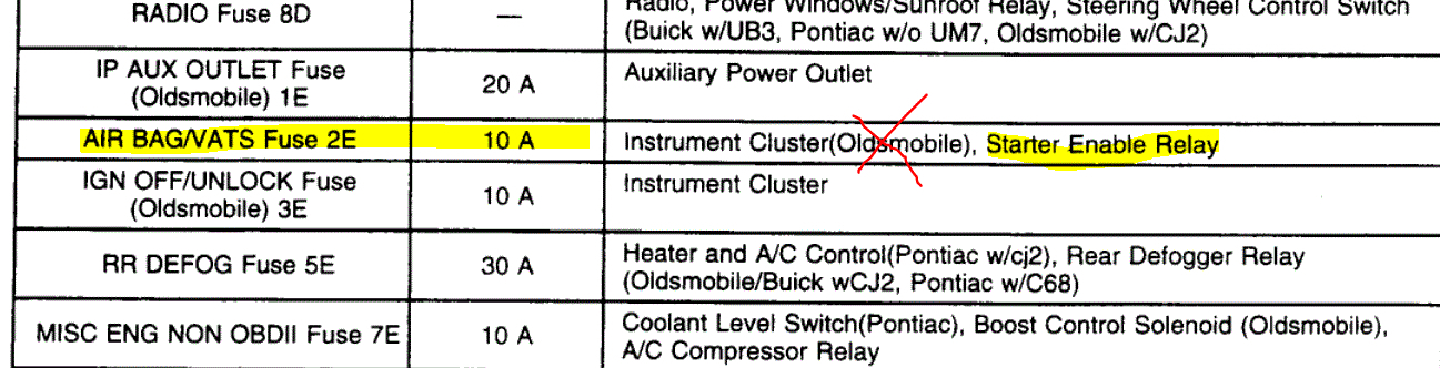

Q3 -- I think you are referring to the starter enable relay. Take a look at pics 13 and 14. Those are the directions. If it is something different, let me know.

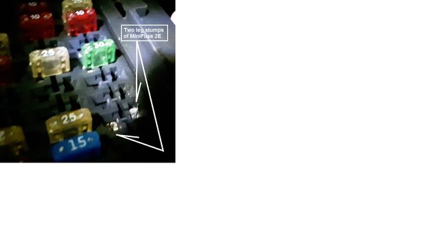

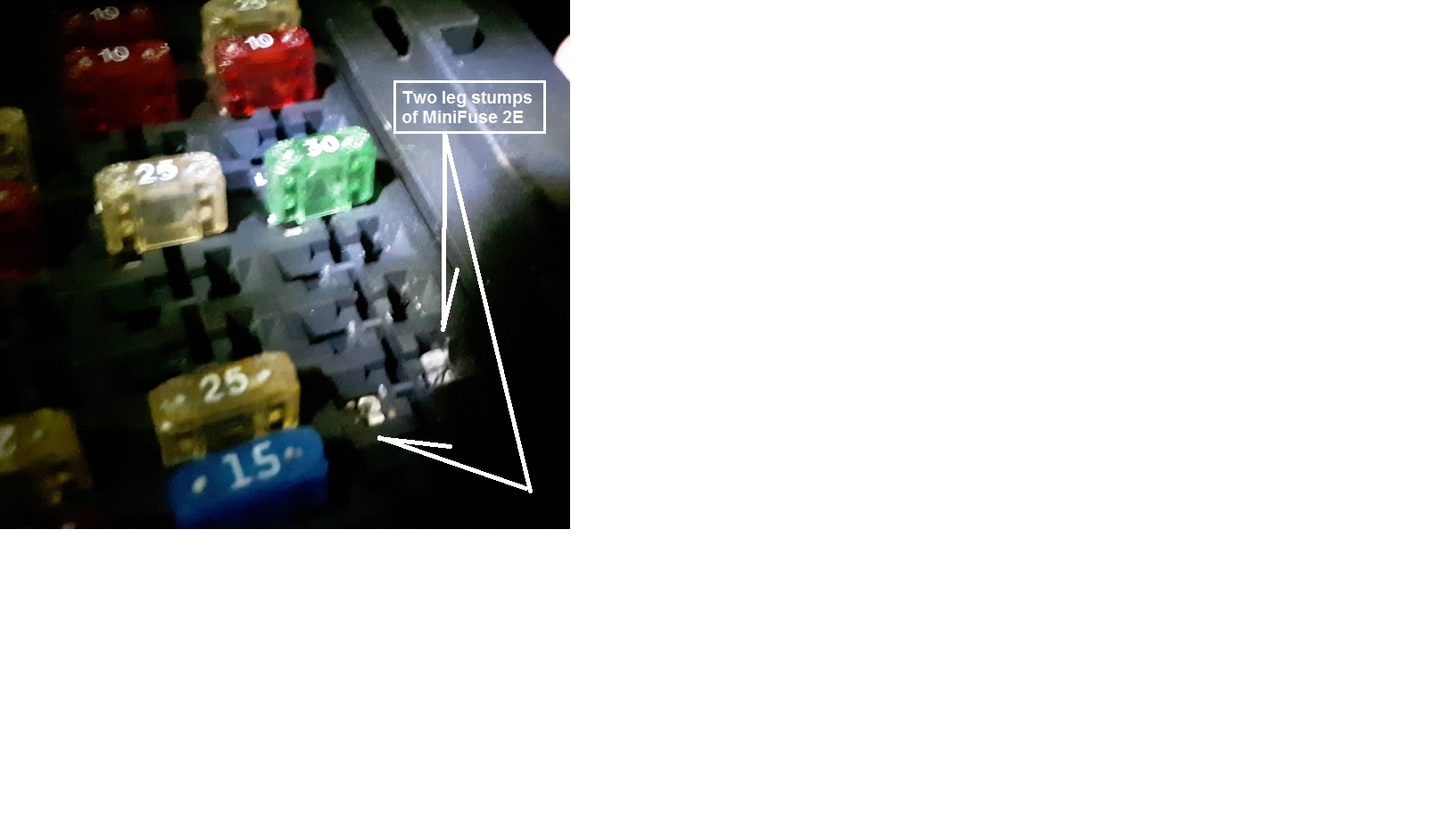

Q4 -- Fuse 2E is the starter enable relay fuse. That should have power in the start position. See pic 15 below. Note: I crossed out "Oldsmobile" because I believe that is a reference to the instrument cluster since it follows it.
Q5 -- The answer to Q5 is yes. The reset provided is a general reset. It works with many vehicles but not all.

Q2-- Airbag cable and fuse 2E--
Since fuse 2E is labeled Airbag/VATS, can I do all sub dash and under-hood work with the airbag fuse removed, and with the yellow airbag cable disconnected?
That is, if fuse 2E controls VATS, as well, could that pose a problem?
> As I read your reply, so long as I am careful to disconnect both battery and fuse 30 minutes before removing the airbag cable (yellow) and the airbag fuse, I should be okay.
** On reconnection of battery and fuse 2E, I now understand I must connect the fuse and airbag (yellow) cable before reconnecting the battery. (Appreciate the warning about a surge and accidental airbag deployment)
> My urgent question about fuse 2E is whether this Airbag/VATS fuse 2E-- if bad and/or loose in its socket-- could trigger the Security warning and VATS lockdown. The red 10A fuse fits very poorly in its socket. I cannot feel a solid insertion when I press on the fuse top, so it may be going in crookedly. As your diagram #15 indicates, the fuse must be tested in ignition position start to be active. (Of all sub dash and under-hood fuses, this is the only active (non-spare) fuse on fuse row 2.)
> Since the ignition switch must be in start position to test fuse 2E, must I have somebody else to turn the ignition key while I probe the fuse? Without a remote starter cable, is there another way for me to switch the ignition key with one hand, and probe 2E with the tester? Incidentally, with the ignition key in "run" (but not start), I have no light on my continuity/circuit tester, which is expected.
Q3-- Starter enable relay--
Except for the starter enable relay, located under dash, relays are located in the under-hood fuse blocks (left and right). For your convenience, I have attached a photo of the row of under-hood relays, so you can see why I am puzzled by physical removal difficulty. I have not been able simply to pull the relay cube housing outward, despite wiggling it.
> Could a Security lockdown warning be triggered by a faulty starter relay? I realize the PCM is the source of all security actions but did wonder.
Q4-- "Starter enable relay fuse 2E"--
> I was not aware the starter enable relay had a fuse. Fuse 2E is labeled Airbag/VATS on the fuse cover inside label.
> On the relay, itself, I plan to test ASAP, although my attention has been focused on the VATS warning. As in Q3, above, I still need to determine how to remove the relay from its socket, it order to test the relay on all its contact points. Even if the relay clicks when power is applied, could it still be faulty?

Before we do anything else, I need you to go back to fuse 2E. You indicated it doesn't feel correct when inserting a fuse and there is no power evident. Inspect the terminals to make sure one hasn't pushed inward preventing it to attach to the fuse.
Also, before you reconnect the battery, the fuse and connector to the airbag should be installed/connected. You don't want it disconnected and receive a power surge after the battery has been connected.

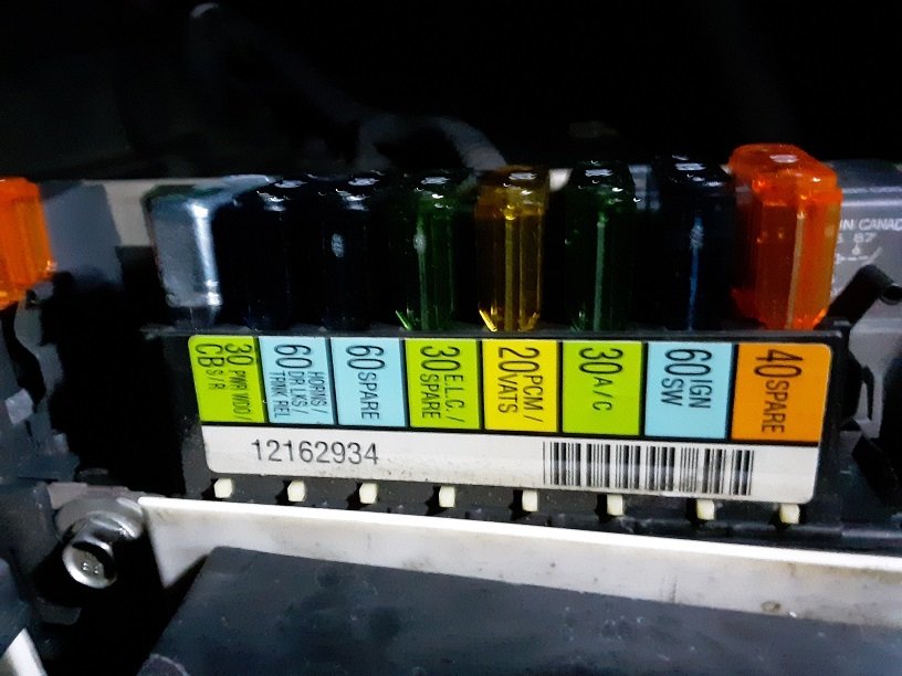

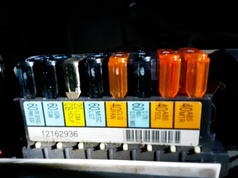

1. Fuse 2E is okay on both contact points-- somehow, I was able to hold the probe with one hand and try to start the engine with the other hand.
2. Attached are photos of the left and right under-hood Maxi fuse and relay panels. And a photo of the starter relay plastic housing clip that resists being opened. On that, I need to know how you would pull out the relay-- use a special tool, or continue pulling and wiggling?
Oct 3, 2021 at 2:30 PM
ALPHAA10
  • 247 POSTS
Here are the photos. From left to right.
1. under-hood relay, showing blue plastic retainer clip.
2. under dash Maxi fuse and relay panel, left.
3. under dash Maxi fuse and relay panel, right.

The blue tab will slide upwards. You don't need to fully remove it. It simply is a locking device to prevent the connector from coming apart. If you can't move it by hand, try a straight screwdriver.
Now, if fuse 2E is good, then we need to check if the power makes it to the theft deterrent relay via a purple wire. I have a feeling you will need a helper for this. Again, it will only get power when the key is in the start position.
See pic below
Let me know what you find.

Joe, late this afternoon, I may have found the elusive orange wire. After watching a few YouTube videos showing the resistor bypass technique, in which one of them briefly showed the under-dash area where the orange wire runs, I located the same area and the most likely candidate orange wire.
Not only that, but all the videos show the correct orange wire is actually an orange jacket containing two white-jacketed wires. It became a simple matter to identify the correct orange wire by its oval (oo), rather than round, cross-sectional shape. Fortunately, there is only one oval orange wire in the sub dash area of interest.
Eagerly, I finger-traced the oval orange wire to the junction block above the left under-dash fuse panel. At that location, the orange wire opens into two smaller, white wires, each of which disappears into the junction block.
As I tried to photograph the wire, rain began, but soon, I hope to attach the photos I was able to take of the orange wire and its surroundings. As soon as the rain ends (for a while), I can experimentally attach the resistor, leaving enough of the original orange wire hanging from the junction block for easy reattachment, if the plan fails. Is that a promising approach?
Oct 6, 2021 at 3:26 PM
ALPHAA10
  • 247 POSTS
Photos, left to right, were taken from an upside-down position, with my head below the dash, and trying to hold the flashlight beam steady with one hand, while keeping the camera focused on the area of interest with the other. For that reason, some of the photos may be considered upside-down, so you can flip or rotate them in your viewer to make them clearer.
1. Photo (correct orientation) of orange oval wire emerging from dark background, and entering into a flexible, black plastic conduit running upward into the ignition switch.
2. Photo (upside down) of oval orange wire entering the junction block. Nearby, the solid purple wire you mentioned enters a blue-plastic framed portion of the junction block.
3. Photo showing solid purple wire emerging from the back of the fuse panel. On the other side of the panel is fuse 2E. The circuit tester did not blink on when I probed the same purple wire at the junction box as I turned the ignition key, but I'll try to confirm that.
4. Photo (upside down) of orange oval wire looping down. In this photo, its oval cross-section is visible as a sharply defined reflection line.
Oct 6, 2021 at 5:52 PM
  • 110,251 POSTS
Looking and thinking, it should be okay to try. However, you indicated there is no power via the purple wire. That should be coming from fuse 2E. I read a more detailed section of the schematics and found it should have power in run and start positions.
Are you able to trace that purple wire back to the fuse to see if or where power is lost?
Oct 7, 2021 at 7:24 AM
ALPHAA10
  • 247 POSTS
In your October 4 message, you provided (thank you) a schematic for the connection from fuse 2E to the Theft Deterrent Relay. The fuse block shows 2E is hot in start but says nothing else about other hot positions for 2E, ie, nothing about run. Did I read that schematic incorrectly?
When the rain stops, I'll first check for 2E (purple wire) power to the junction block (located to the left and above the fuse panel). And make sure to determine whether 2E power is present for start and also run.
Oct 7, 2021 at 6:08 PM
  • 110,251 POSTS
That is what the schematic indicated. I read through a different one that indicated power in both the run and start position.
Let me know if you have questions or if I can help.

Good news, Joe. the car started after I installed a 2kOhm resistor across the orange sensor data line to the PCM. (Using shrink tubing, I sealed off each of the two-cut wire ends of the orange line running up into the ignition switch.)
All fuses are intact, including 2E, and the Maxi fuses are okay, too. Obviously, all the relays work, as well. Starting is not a problem, and current battery voltage is 12.78v, and the charging voltage from the alternator (measured across battery terminals) is 14.11v.

On re-examining MinuFuse socket 2E, I found both blade sockets are occupied by stumps of the original two blades. Since fuse 2E is on the starter solenoid trigger circuit, that could explain my no-crank problem.
The problem is how to remove the two metal stumps. To gain more access to the lower dash shroud containing the MiniFuse panel, I must disconnect the yellow airbag cable. Previously, you had said this can be done, provided I make sure the battery is not connected before the airbag cable is reconnected (otherwise, risking airbag deployment). There is also another set of wires that must be disconnected, but that seems relatively simple.
With the airbag cable disconnected and lower dash shroud more accessible, I surely would be able to see the minifuse panel more clearly, and explore methods of removing the two metallic stumps. My problem at that point is how to pull the stumps out of the socket, or failing that, to push them out with a slender pick from the socket backside. On preliminary attempts, while the lower dash shroud is still fully connected, I tried to pull the stumps with slender needle-nose pliers, but cannot grip the longest stump, so have not even tried the other stump.
On trying to back-probe socket 2E, I could not insert even the slimmest of my small pick tools past the occupying wire and its connector. * BTW-- Do you know whether a "puller" is available for removing MiniFuse socket wires from the socket back side?
If that does not work, I guess I could snip the two wires going into socket 2E, and solder them to a regular 10A MiniFuse. From prior notes, one of the socket 2E wires is a thick, white wire, and the other is a slim, dark-brown wire. Both wires clearly enter the back of socket 2E.

I'm wondering why the fuse came apart. Does it appear as though it was overheated? Also, your idea of simply using an inline fuse would certainly work. If the fuse cover appeared melted, you may have a weak connection causing heat. That may or may not be repairable.
Is it possible for you to take a pic of what you are trying to remove? Also, if you disconnect the battery, it will help prevent anything from shorting when working in the box.
Jul 19, 2023 at 1:05 PM
ALPHAA10
  • 247 POSTS
Thanks for responding, Joe. I had no other way to contact you directly on this matter we had discussed before. .
My best theory for the missing Minifuse--
When I originally mentioned to you MiniFuse 2E was reluctant to insert all the way into its socket, I removed it and tried reinsertion. The situation was no better, but the car started normally.
At that time, I had not looked inside the socket before I reinserted the fuse, but now I suspect the metallic stumps were already present in the socket, a remnant of someone's previous work on the car. The stumps had prevented full insertion, which accounted for the strange feel during insertion.
According to my theory, when I discovered a red-capped 10A MiniFuse on the floormat, I presumed the fuse was a left-over from previous maintenance. Since I never had seen a MiniFuse fall out, I did not check the MiniFuse 2E location in the MiniFuse panel. If I had, I would have noticed the fuse was missing. More than likely, during constant use, the fuse simply worked its way loose during its cooling cycle, after I had parked the car
This suggests I can insert another fuse, and successfully start the engine, which seems preferable to butchering the MiniFuse panel to remove the mysterious metal stumps I'll let you know what happens.
(Photo attached below-- the arrowed, white areas are simply metallic stumps, as best I can determine)

This afternoon, I tried to insert a 10A MiniFuse into socket 2E, but I met mechanical blockage. Despite the restrictive viewing angle, I saw enough to guess the socket seems blocked by the two bright metal objects you see in the photo.
Although I had interpreted the two metal objects as "stumps" of the original fuse, it is also possible the two metal objects are the original DC contact points for socket 2E.
If I am correct, that means I must use a small, straight-bladed screwdriver to open the contact points enough to admit the MiniFuse.
Why the fuse fell out is still a mystery, but if the socket were so mangled as I now suspect, any MiniFuse could fall out.
To provide a better working angle, I may remove the airbag cable and other, adjacent wires. This will permit me to move the right end of the lower dash shroud toward the firewall, while the MiniFuse panel swings toward me. That is the hope, anyway.
