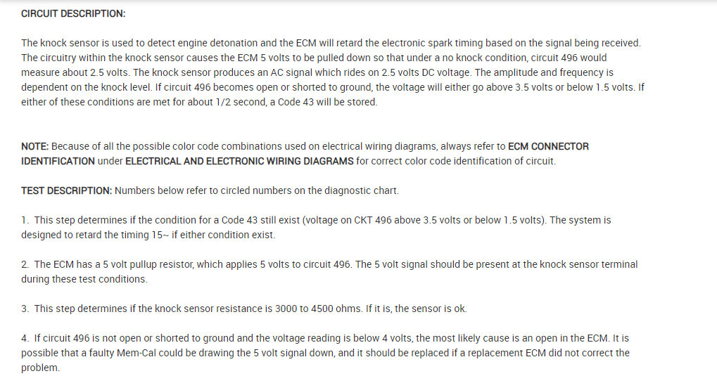

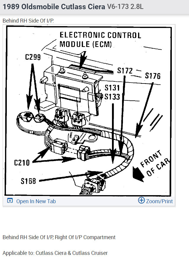

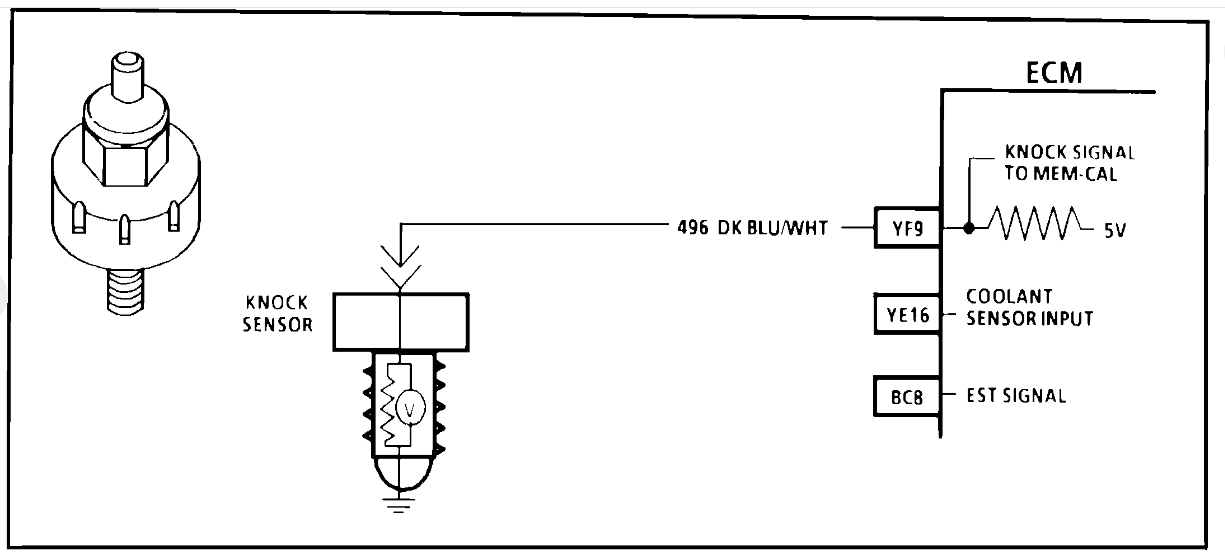

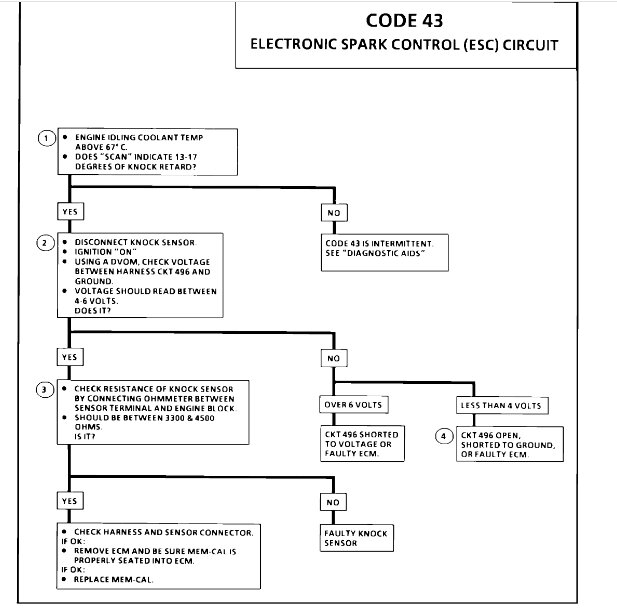

Hi:
The code is certainly related to a timing/knock sensor issue. However, it doesn't mean the sensor is the problem. It could be related to the ECM.
I attached diagnostics below. Let me know if you have already tried this.
See pics below
