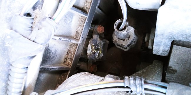

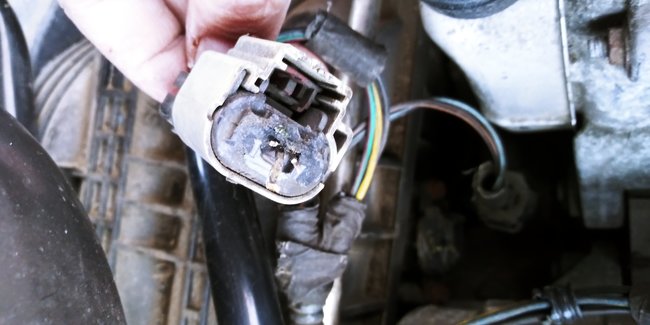

Oh boy. I finally went out to at least find and clean MAP Sensor I can't believe what I found. I'm adding pics. Now what. I can't even get old one out before dark to replace it and I have to drive 4 miles one way and back in the am. I promised a State Cop I'd sit with her dad while she goes to church. I don't know her but we have a mutual friend who asked me and there is no one else to go out there. Will driving 8 miles hurt this? I think that is the MAP Sensor. I finally got a repair book for this.
Saturday, March 13th, 2021 AT 2:52 PM
  • 108,310 POSTS
It won't run properly, but it shouldn't really hurt anything. Try to clean it up as best you can.
Let me know what I can do to help.

KLHUDOCK64
  • 91 POSTS
Well, it took about 2 hours to get the one half of broken sensor out of the harness and to use an 8mm hand wrench to turn the 2 tiny bolts holding the other half of MAP sensor 1/4 turn at a time. I was ready to scream. Now tomorrow I'll just put the new one in. Yeah, hopefully the bolts will go in quicker than they came out. Thanks so much.
Sunday, March 14th, 2021 AT 4:40 PM
  • 108,310 POSTS
You're very welcome. They can be a pain. LOL Regardless, let me know how things turn out for you and it takes care of the problem.
+1
Sunday, March 14th, 2021 AT 7:22 PM
KLHUDOCK64
  • 91 POSTS
Okay, so 6 hours later the new MAP sensor is in. Both the Map sensor and O2 sensor codes are gone and the check engine light is off. I will clean that new MAP sensor every so often because I don't ever want to have to work in that tight of a space again, Lol. Thank you for all of your support and answering my questions. Glad I changed the MAP Sensor before the O2 sensor because the one took care of both. I guess things aren't always what they seem to be and that's why you are a mechanic and I'm not. Hope you have a great day!

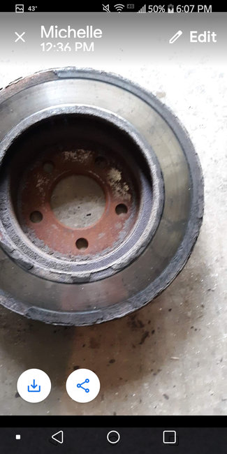

  • 91 POSTS
Okay, so I bought the two catalytic converters tailpipe and muffler. The y pipe is okay because the estimate I got at a local shop just had the converters tailpipe and muffler listed in their estimate. I found and bought the exact part numbers and am having that put on hopefully tomorrow after the powers steering pump is finished. Today it was front and rear brakes and power steering pump. I left replies for that on one of my questions about tires feel funny. And my power steering question. Along with a gouged rotor and brakes put on backwards. I know this guy buys and sells cars all day long but I don't think he should be because who puts brakes on inside out or backwards and that rotor had a huge gouge on the inside. Well at least with all repairs it should last a few years with maintenance.
Friday, April 16th, 2021 AT 3:21 PM
  • 108,310 POSTS
I have no idea how the brakes were put on backward. Ugh! That means the steel backing plate on the brake pad was stopping you. No wonder the rotor was bad.
Let me know how everything turns out for you. I'm really interested in knowing.
Take care and thanks for the update.
Friday, April 16th, 2021 AT 8:13 PM

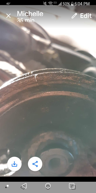

KLHUDOCK64
  • 91 POSTS
Thanks at least it's all getting done. And done correctly. I'll post pics of my new exhaust. I did get a new O2 sensor the other one was welded to the flex pipe. Yeah, I had to get a new pulley as you can see the other one needs replaced in the pic and yeah that rotor. I knew there was something I just couldn't put my finger on. My brake pedal didn't feel right. I was going to bleed them then that rotor was found. Thanks for everything.
Friday, April 16th, 2021 AT 11:40 PM
  • 108,310 POSTS
Wow! That looks rough.
Let me know how things turn out for you.
Saturday, April 17th, 2021 AT 7:52 PM
