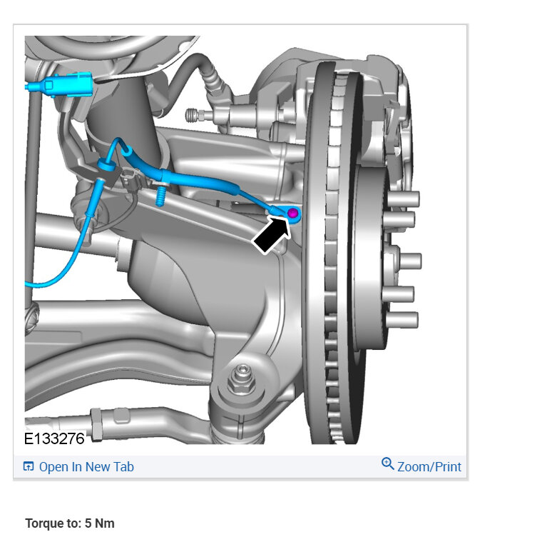

Whenever I drive my car, I get the amber warning lights of " HDC not available system fault, gearbox fault, and traction control not available drive with care. " but the car shifts normal and drives normal.
Jan 16, 2023 at 6:55 AM
  • CAR REPAIR CONTRIBUTOR
  • 54,433 POSTS

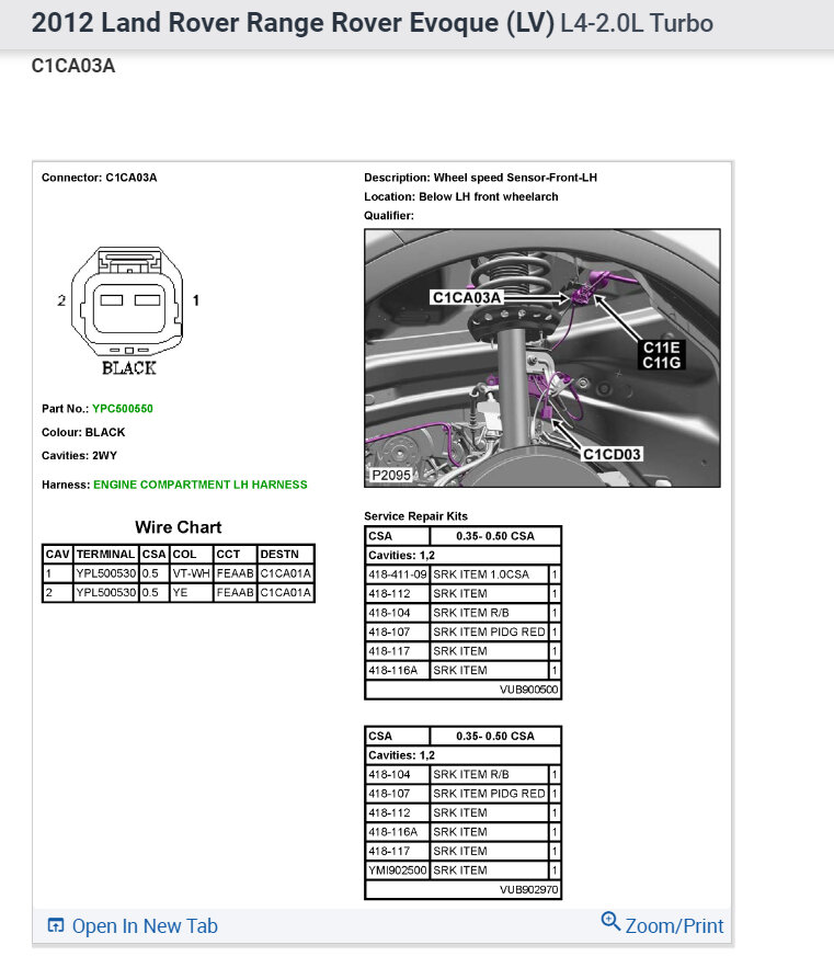

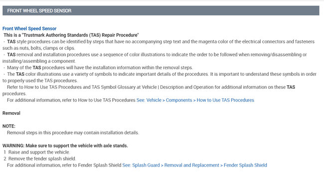

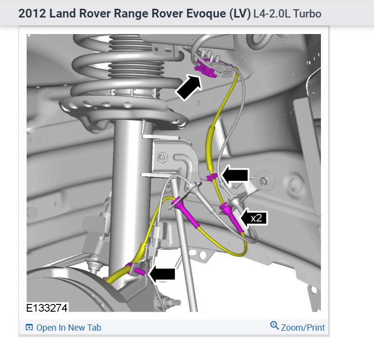

Yep, this happens when one of the ABS wheel speed sensors goes out. You will need to run the ABS codes to see which one it is. Please follow this guide and I have included how to change out the ABS sensors in case you need them:
https://www.2carpros.com/articles/anti-lock-system-testing-and-repair-abs
Check out the images (below). Let us know what happens and please upload pictures or videos of the problem.
