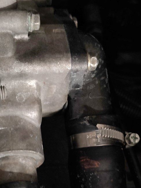

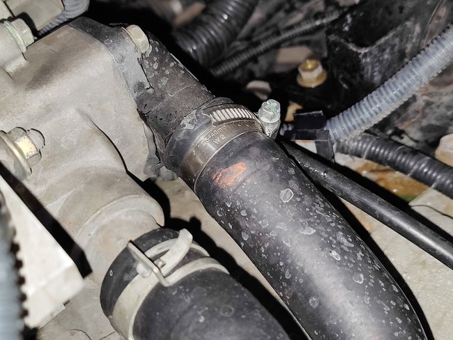

Hey SQM, I saw this, when I turned down my car. It is the lower hose, I think.
Friday, July 29th, 2022 AT 10:02 PM
SQM
  • 6,383 POSTS
Is it leaking out of that hose?
Friday, July 29th, 2022 AT 10:12 PM
DHWANIL123
  • 21 POSTS
I saw smoke, so I opened bonnet and saw that, still not sure if that is it though.
Friday, July 29th, 2022 AT 10:34 PM
SQM
  • 6,383 POSTS
Typically, when coolant leaks it will get on the hot surface of the engine or exhaust and that will create smoke.
Try starting up with the hood open and see if it is leaking out of the hose. If it is, then that will have to be replaced.
