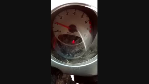

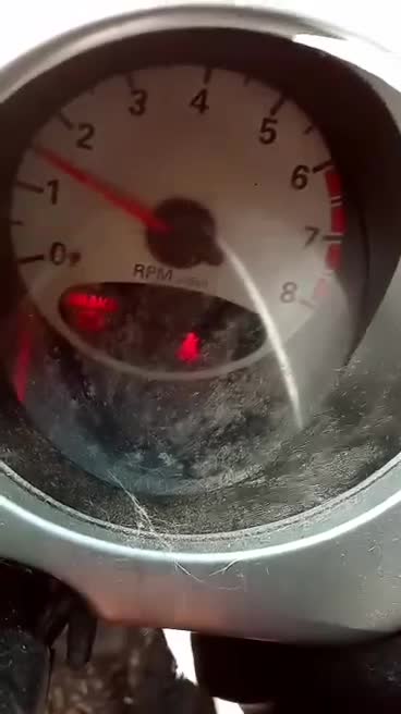

Idles great when RPMs hit 2,000 the RPMs surge up and down. Replaced cam and crank shaft sensor, idle control sensor, and still does it. Also replaced wiring harness connector to cam. It ran fine before replacing manual transmission. Help, no one can fix it.

It's not a feeling of a surge the car is in neutral and at 2,000 RPMs it will drop to 1,500 and surge back up and down. The car isn't in gear or moving.

Below is a video of the revving it does at 2,000 RPMs.

That's with the car in neutral.
Tuesday, April 26th, 2022 AT 10:23 AM
Got it. Thanks for supplying the video as that is what I suspect this was with this additional info. That is called a rev limiter and is 100% normal.
That is protecting the engine from over revving when there is no load on it.
Basically, the PCM is seeing that the vehicle is not in gear and watches the throttle input for when you are holding it down. The PCM then cuts fuel input to keep the engine from over revving and this creates the surging that you are seeing.
