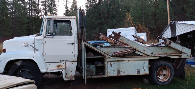

Well, I got the truck out of the wood and I poled it backwards and I got it to move or so that I could move it but as so as I try to put it in gear it locks back up until I pull it backwards again then it unlocks even when it is able to roll it still stalls out release the clutch here is a picture of the truck I been asking about.. I also need help with the series polarity switch there is one wire that I don't know where it goes it's a white wire and I don't even know if I have the right switch for the truck so far the one I bought is working. could you send me a picture of the right part that I need to get?

If pulling it backwards let it move, I would suspect you will need to pull the transmission out to get the top off to get to the shafts. Once you have a chance you can get the ID info off the tags, there are places you can buy the factory service info but if it was built like most trucks you will end up needing a few manuals, a Ford chassis and electrical manual, then a book on the engine and one for the transmission. I'm working off memory on them myself.
