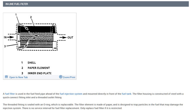

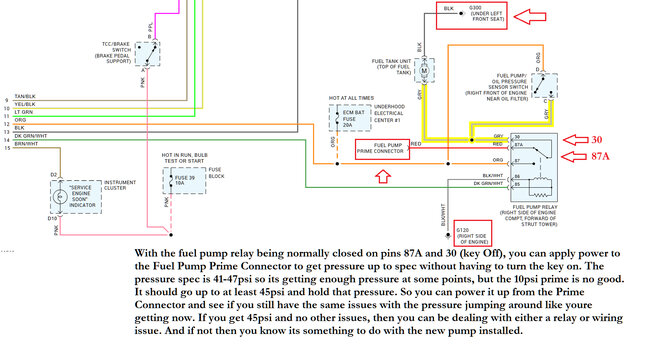

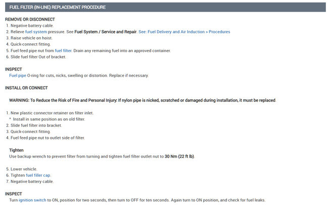

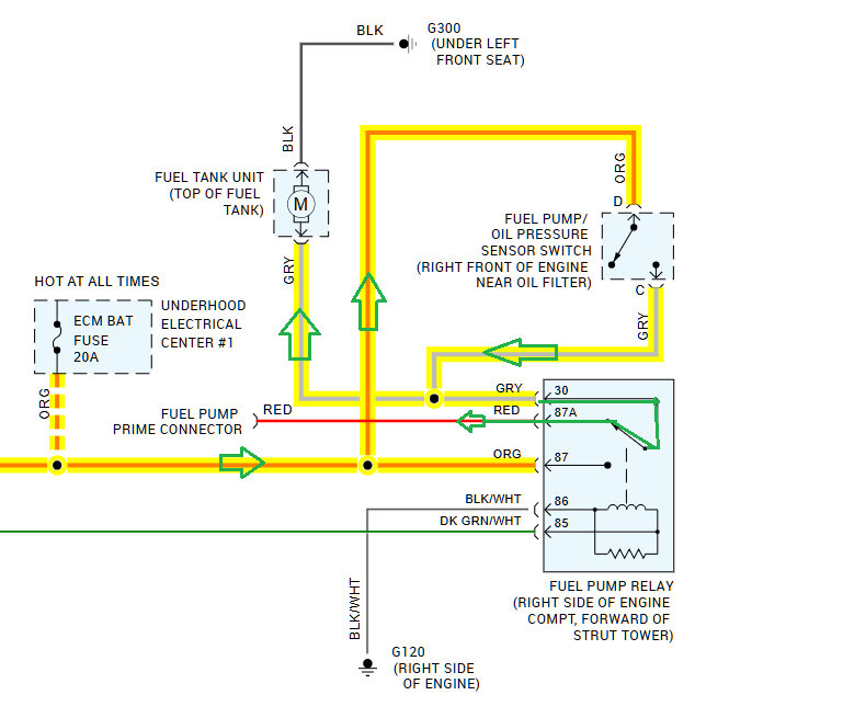

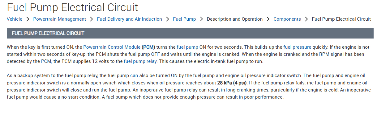

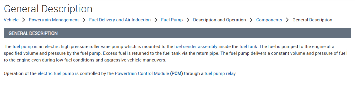

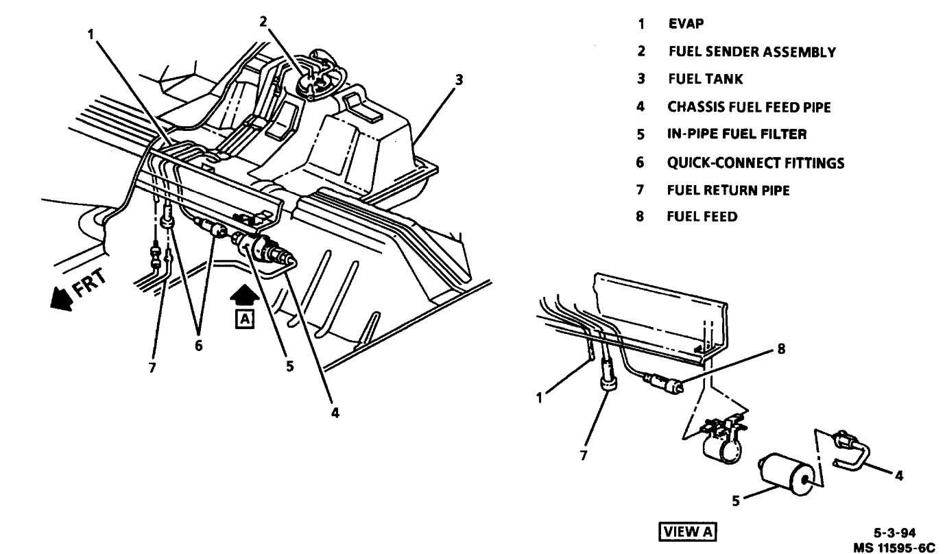

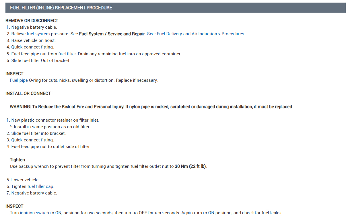

Here are the wiring diagrams for the pump, the fuel pumps operations and the fuel filter info.

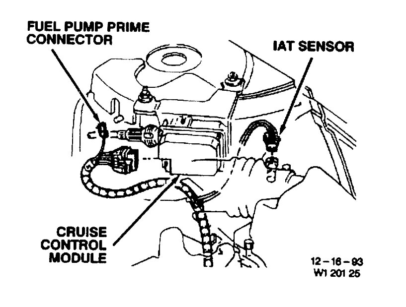

4. Where is the fuel pump prime connector?? I have looked everywhere in the engine bay. I did find the tach connection, a single green wire with clip close to the water temp sensor but no single gray wire (from what I've read) anywhere. Your diagram shows a red wire but no can find it.
5. What source do I use for the 12 volts to test the pump prime connector? Can I use the battery?

oops again. I found a single red wire on the driver's side near the w/s washer pump. I think that's the one. I can't find how to exactly perform the test.

Well, you should have battery power at the fuel pump harness plug, 8volts is very low, and when the circuit is loaded by the pump the voltage drops even lower. Since the pump is holding pressure, the check valve in the pump seems to be okay, did you replace the filter as well when doing the pump?
It sounds like there is just low voltage back at the tank. I would check the fuel pump relay, these would corrode from underneath the fuse/relay boxes and cause all kinds of problems, many times the connectors for relays or fuses would just end up breaking off. Since the fuel pump relay is in the engine compartment fuse panel, its exposed to the elements. Pull the relay out and check for corrosion there as well as a voltage reading, see if its low at that point also. With the relay removed there should be one pin that has power all the time, thats the power wire that feeds the pump when the relay is energized, the Orange wire (pin 87) from the ECM BAT Fuse 20amp. If you have full battery power at that location, we can work our way back to the pump from there to locate the problem area.
Theres also going to be a purple wire at the tank connector, that's for the gauge, you want the grey wire (B+) and the black wire. The pump may be making a low frequency noise due to low voltage.
So your test light hooked to B+ and touching the prime connector was grounding through the pump itself.
Technically you could put battery voltage to the prime connector and the pump should run, I'd use a fused wire to do so though. You can also use the prime connector as a test point, with the fuel pump connector unplugged, put power to the prime connector (red wire) and see if you're getting the same voltage reading at the pump's grey wire. If you put 12-volts to it and only get 7-8volts at the pump, you know there's an issue with either the relay circuit or grey wire running to the back of the vehicle. But the low voltage is going to be the reason you didnt get any fuel volume out of the pressure gauge.

1. replaced fuel filter with new pump.

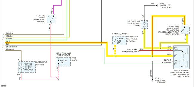

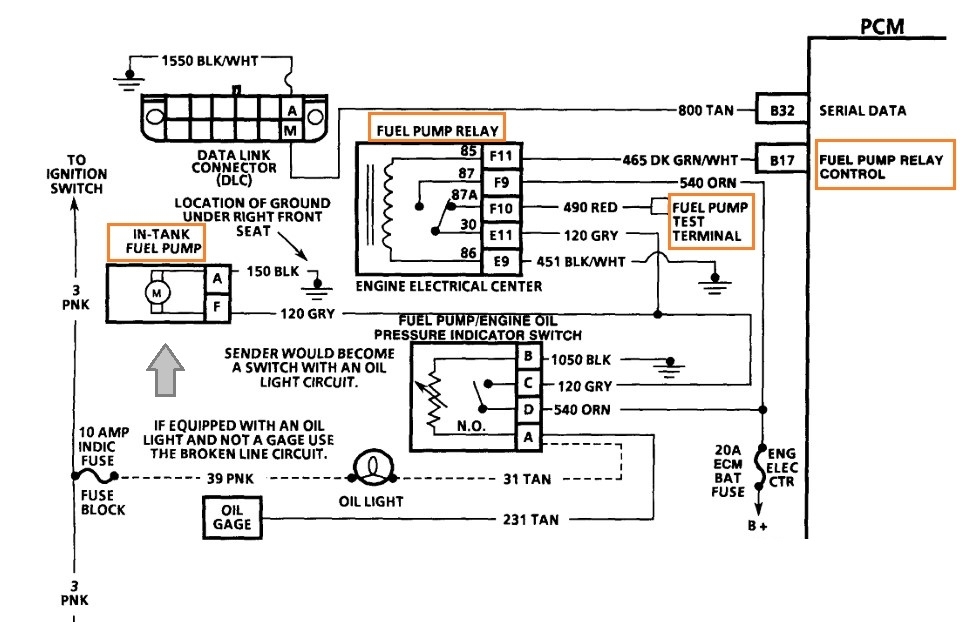

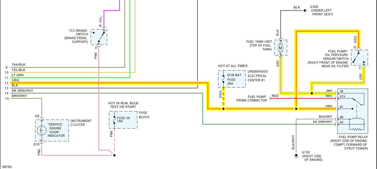

If you had pins 30 and 87 jumped out and the pump was running there had to be power on the grey wire, my guess is the probe pin wasnt making contact. Since the grey wire is the only power feed to the pump.
This is the oem wiring diagram, but at key On youre only going to get that 2 sec power and prime, and then power again when you start to crank the engine. Im not sure why you werent getting power from the prime connector back at the pump, its possible something is going on with the relay or the Red prime wire is open circuit. You can check for continuity from the prime connector to the relay 87A pin. Having the meter set on the Ohms setting one of the relay pins should read close to 0 ohms. If not, it isnt the biggest deal.
If you jump pins 30 and 87 do you get full fuel pressure at the fuel rail and then also 12volts on the Grey wire with the FP connector unplugged? So you can get a reading directly from the connector without having to probe the back of the connector. We need to make sure the wiring is good back to the pump. Double check your back probe pin, some can be difficult to make good contact inside connectors.

1.continuity from fuel prime conn to pin 87a.
2.jumped 30 87, pump running 0lbs at rail with key off. 18lbs with engine "running"
3. 12v to grey wire with 30 87 jumped and engine off.
4. 12v to f. prime, now pump runs (:
(obviously did something wrong the other day)

I'm surprised it runs with only 18 PSI, do you have an amp clamp that can read DC current? But if you read through the service info on the fuel pump, it describes the circuit's operation where if the fuel pump relay fails, the fuel pump can be fed power through the oil pressure switch. You can bring the pump back to O'Reilly's and try a new one or different brand.
