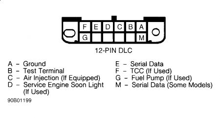

Try this find DLC underdash see diagram jumper from A to B paper clip works. Turn key on count flashes on MIL. So flash, flash pause flash, flash,flash = 23
Let me know
https://www.2carpros.com/forum/automotive_pictures/198357_Graphic_237.jpg

Based on your posted diagram image and one I found at this site https://www.2carpros.com/articles/mitchell1eautorepair-car-repair-manuals, my OBD-I connector has no B wire run to it, but only 3 at the locations of A, M, and J. I've been unable to find any information online about such a setup. Thanks for the info so far - please get back to me.

Car has pre OBDII 16 pin and needs scanner to get codes. That site has what you need you may check with local GM dealer they may have an old scanner.
Other option is check basics compression, vacuum, fuel pressure, ignition coils and EI module, crank and cam sensors and MAF

I've considered that it may be the OBD 1.5 hybrid, which uses a 16-pin plug, but I am positive that it is a 12-pin connector. Thank you for the suggestions - I guess I'll need to find a new mechanic with better tools sometime soon.
