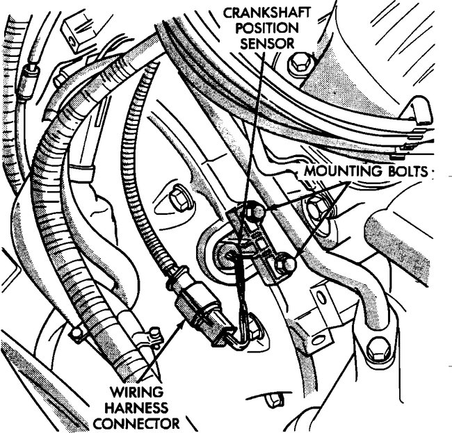

If you find there is no spark, the crankshaft position sensor may be bad. Look through this link.
Here are general directions for replacement.
The crankshaft position sensor is located on the transmission bell housing of the vehicle. I have attached a picture of it to help you locate it. Keep in mind, often times these sensors only fail when they are hot. When you shut the engine, there is no longer air flow which could allow it to get hot enough to fail and then work again when it cools.
I hope this helps. Let me know what you find and if you have other questions.
