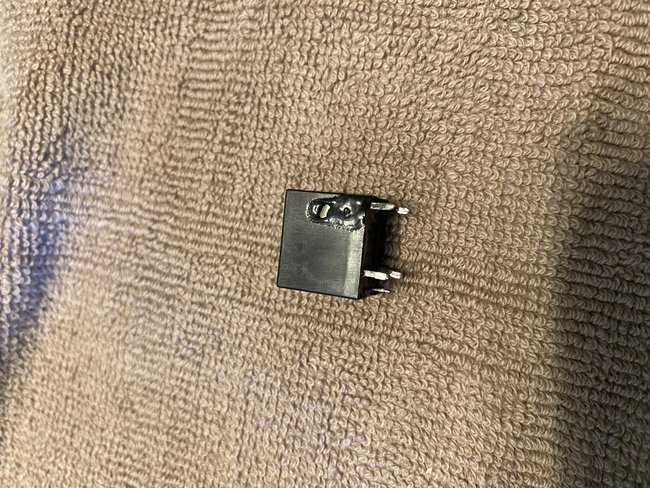

Hey, it was the relay, it had a hole melted in it.

Here is the relay:
Saturday, August 13th, 2022 AT 3:33 AM
KEN L
  • MASTER CERTIFIED MECHANIC
  • 55,488 POSTS
Ooops that looks like it is the problem, good find, we are here to help, please use 2CarPros anytime.

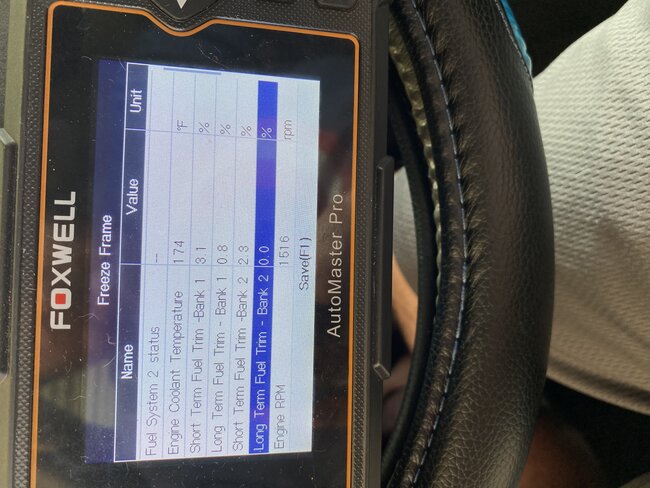

Okay, if you have a live data scan tool, you can simply let me know what the short-term fuel trims are. Also, when the engine is cold, with the scanner check if the temperature reading is close to ambient temperature.

This is what I got when I had access to a scanner.

The trims look okay. However, the engine temperature is a little on the cool side. Was this after it was fully warmed up?

If the engine is warmer than what is indicated by the coolant temperature sensor, it can cause a rich fuel mixture. What was the approximate temperature the day it was checked? Also, we need to confirm it was fully at operating temperature. If it was, then the sensor may be the issue.
