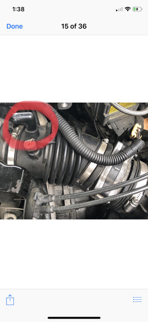

GUY WILSON
I’m having the same Problem what is this that broken off
Wednesday, January 20th, 2021 AT 10:40 AM (Merged)
  • 52,797 POSTS
That is a breather tube.
Feel free to start a new question and we will be glad to help you.
