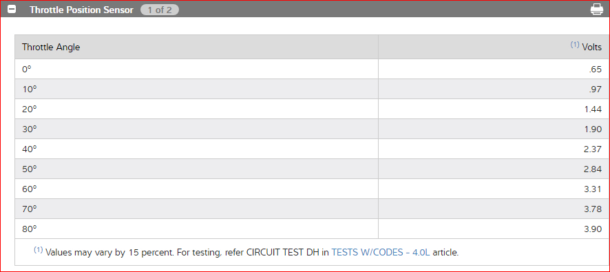

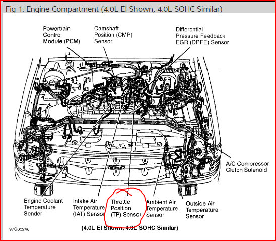

Have to hold the pedal to floor to start, idles fine, does when you put it in gear. No codes flashing no dummy lights on. New fuel pump.

It seems you might be having an issue with you throttle position sensor. It is located on the throttle body. I have attached a picture and the sensors values when tested. Hope this helps and feel free to ask any questions if needed. Thanks for using 2CarPros.
