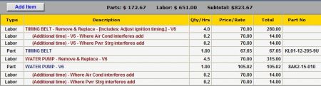

The car was making weird sounds and I took it in they told me I needed a new waterpump and timing belt and quoted me $1000. I looked up the price of the parts online and it only came out to about $165. Even if they're charging $70 an hour for labor it comes out to almost 12 hours of work. Is that actually how long it will take or are they trying to take me for a ride.
Thanks for your help
Friday, August 2nd, 2019 AT 4:58 PM (Merged)
BLUELIGHTNIN6
  • 16,542 POSTS
1k is slightly higher than what it should cost..

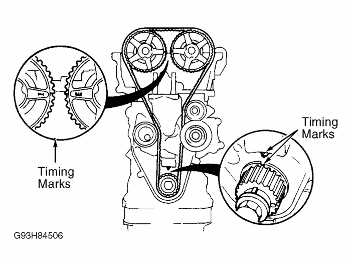

Need to know the placement of timing belt marks
mazada 626 2000
+2
DOCFIXIT
  • 18,828 POSTS
See diagram
-2
WRENCHTECH
  • 20,761 POSTS
https://www.2carpros.com/images/external/84982368.gif
+1

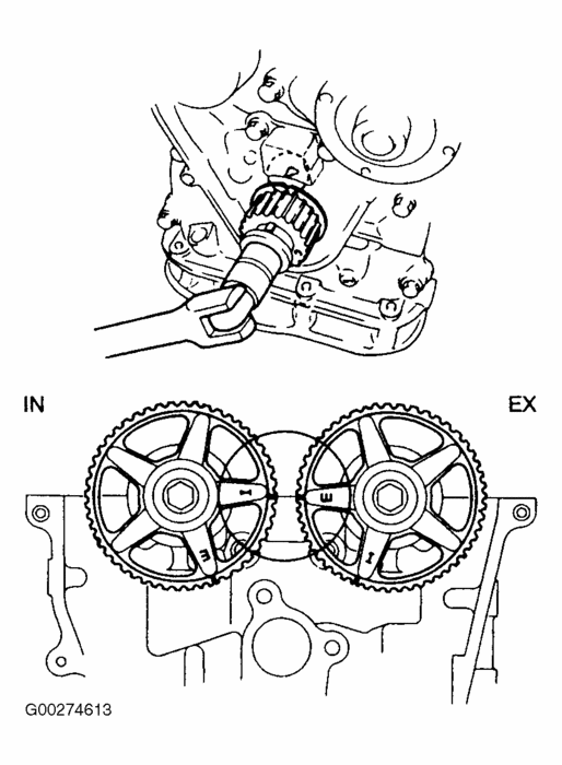

TWEETYROSE
  • 1998 MAZDA 626
Which timing marks on the camshaft sprockets do I align with each other. Do I align E with I or I with E or E with E or I with I.
MWHITNEY
  • 63 POSTS
On the cam for the exhaust side the first lobe should point to the exhaust manifold. The intake cam first lobe should point to the intake manifold. This should almost align two little marks on the spockets. Then it is in time. Let me if any more questions.
+1
COSMO
  • 347 POSTS
The I on the intake cam should line up with the E on the exhaust cam in the middle. They are a pain to hold still while you line up the cams and the crank sproket. I have a tool that fits in the sprokets to hold the cams still while lining up the crank.
Cosmo. Mazda Tech
+4

How to line up Timing marks
Friday, August 2nd, 2019 AT 4:59 PM (Merged)
BLUELIGHTNIN6
  • 16,542 POSTS
Install the camshaft sprocket, aligning the dowel with the number 1 mark.
Install the camshaft sprocket bolt. Hold the camshaft, on the cast hexagon, with the wrench and tighten the bolt to 35-48 ft. lbs. (47-65 Nm).
Install the crankshaft sprocket and key. Align the keyway with the timing mark on the oil pump housing.
Install the crankshaft sprocket bolt. Install the flywheel locking tool, if equipped with automatic transaxle, or place the shift lever in 4th gear and apply the parking brake, if equipped with manual transaxle. Tighten the bolt to 108-116 ft. lbs. (1-11 Nm).
Make sure the timing marks on the camshaft and crankshaft sprockets are still aligned.
Install the timing belt. If reusing the original timing belt, make sure it is installed in the same direction of rotation.
Turn the tensioner clockwise with an Allen wrench and install the tensioner spring. Remove the holding tool from between the camshaft sprockets.
Rotate the crankshaft 2 turns in the normal direction of rotation and align the timing marks. Make sure all marks are still correctly aligned.
Remove the crankshaft pulley bolt and install the timing belt covers.
Connect the negative battery cable.
https://www.2carpros.com/forum/automotive_pictures/261618_1_96.jpg
