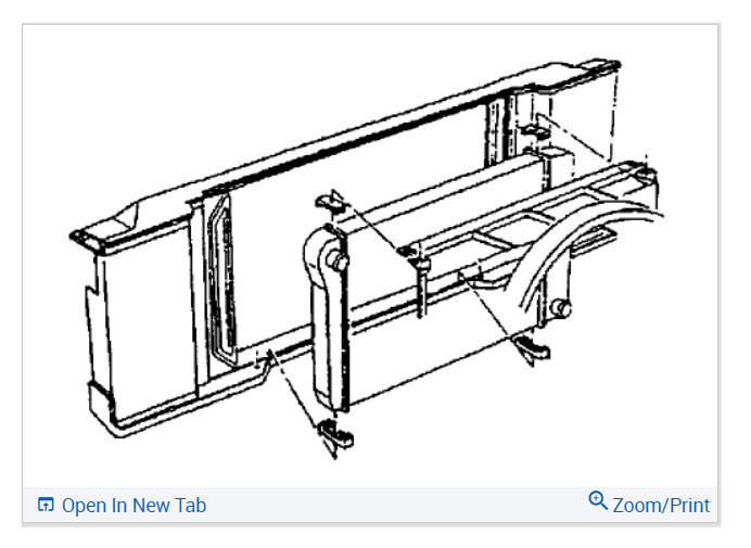

My engine has only 30,000 miles on a rebuilt engine. It is overheating. I have a new water pump, new radiator, new thermostat and new hoses. My fan clutch seems to be okay. I was having the same problem before changing engines. Help! FYI I am not losing any coolant.

How is the fan shroud? It must be in good condition, or the engine will overheat. Also, when the engine is overheating can you hear the fan clutch kick in (start to roar)? Here is an image of the fan shroud so you can confirm the part is installed correctly. It only shows the top half it should be completely around the radiator. This guide can help as well:

Hi Ken. The shroud is also in good shape and installed properly (both top and bottom). I'm at my wits end. The fan runs constantly. I tried to check the fan clutch in all methods I could find and could find no problems with it either.
