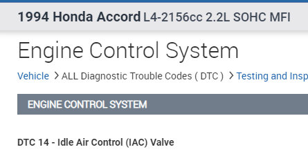

The engine light tells me Code 14 Idle air control valve or bad ECM.

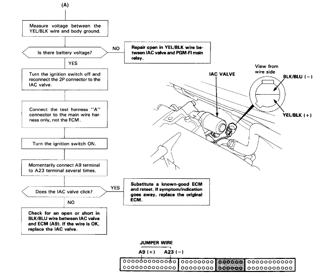

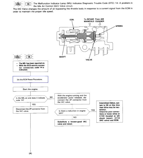

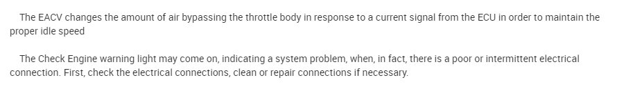

Does the misfire only happen at idle? I ask because once you press the throttle, the IAC is bypassed, and air enters via the throttle body/throttle plate.
As far as the code, I attached the description and diagnostics specific to the code and this vehicle. Take a look through them and let me know if you are comfortable performing them.

That is very possible. The IAC receives a signal from the ECM when an added load is placed on the engine to increase engine speed to compensate for the load.
If you can, reinspect the connector. Make sure it is in good condition and tight. Also, remove the IAC and inspect it.
While the IAC is out, reconnect the wiring to it. Have a helper cycle the ignition key from off to on while you watch the pintle. It should move a bit each time the ignition is turned on and off.
See if that happens. Also, if a new one isn't too expensive, you may want to replace it.
