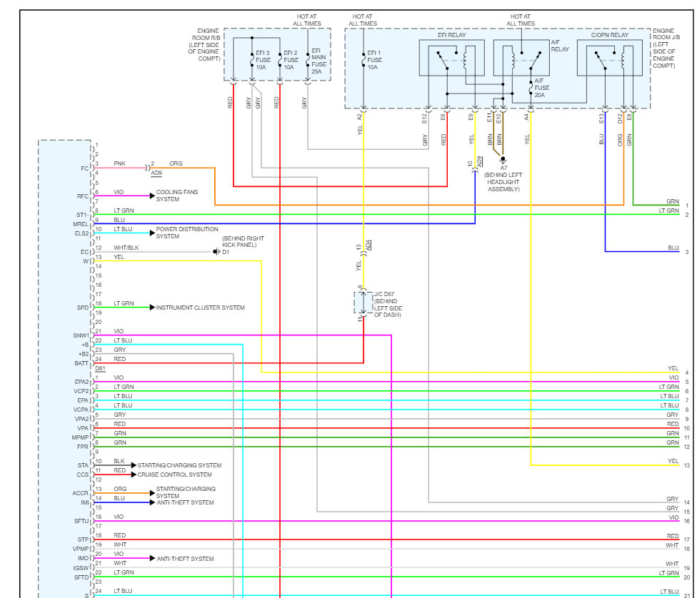

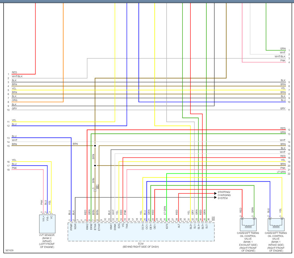

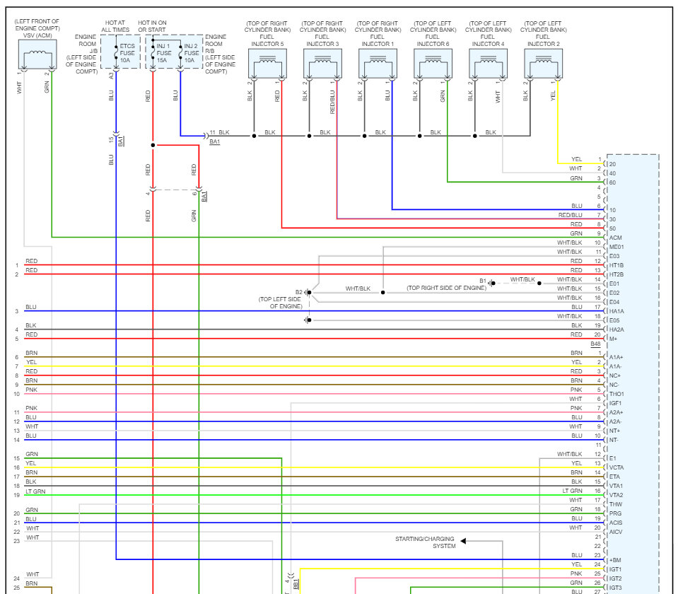

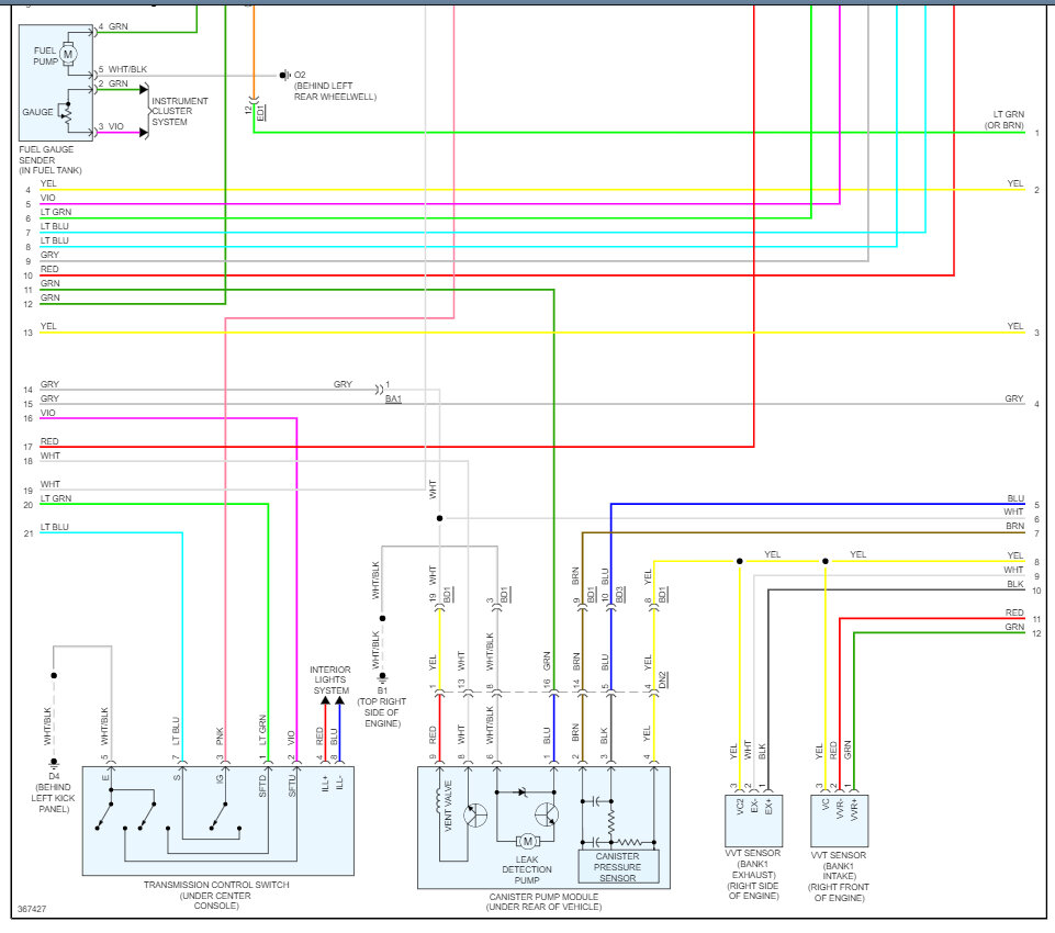

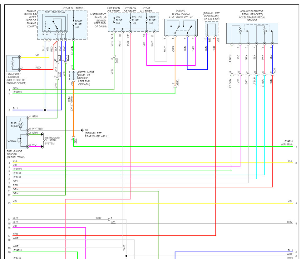

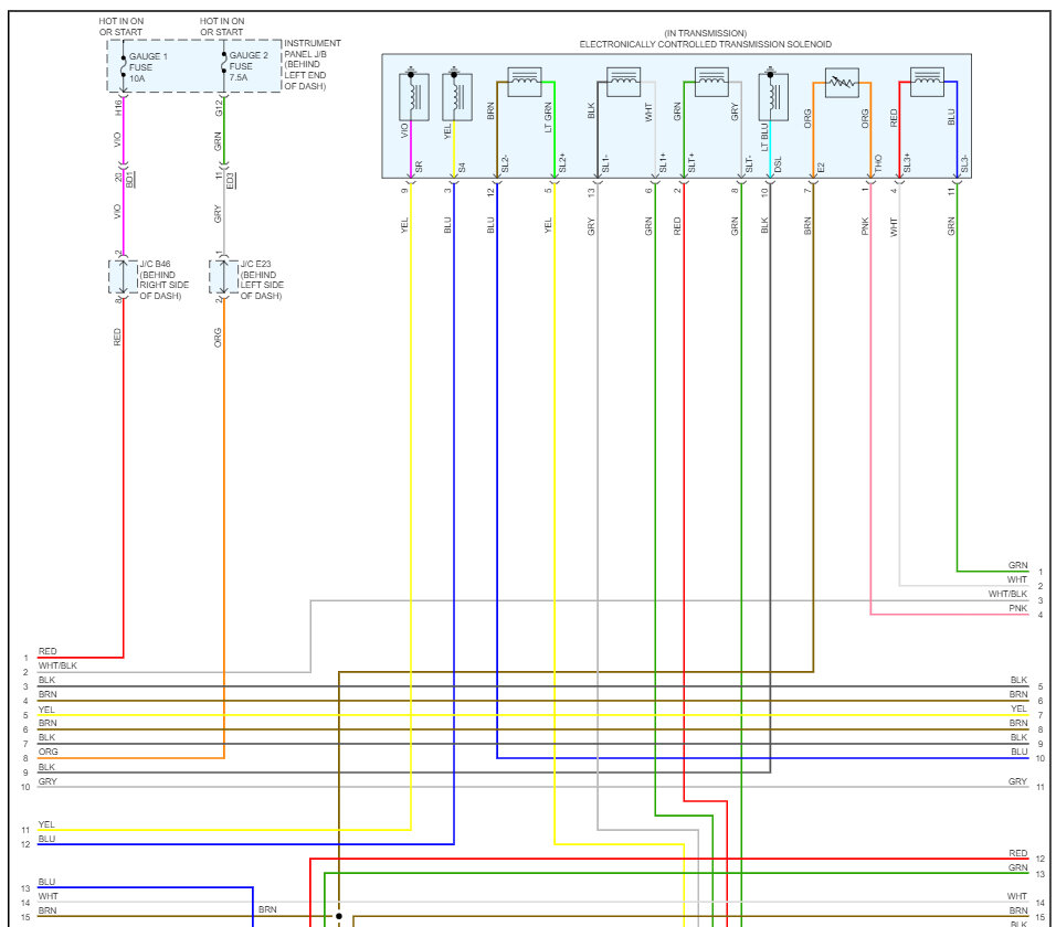

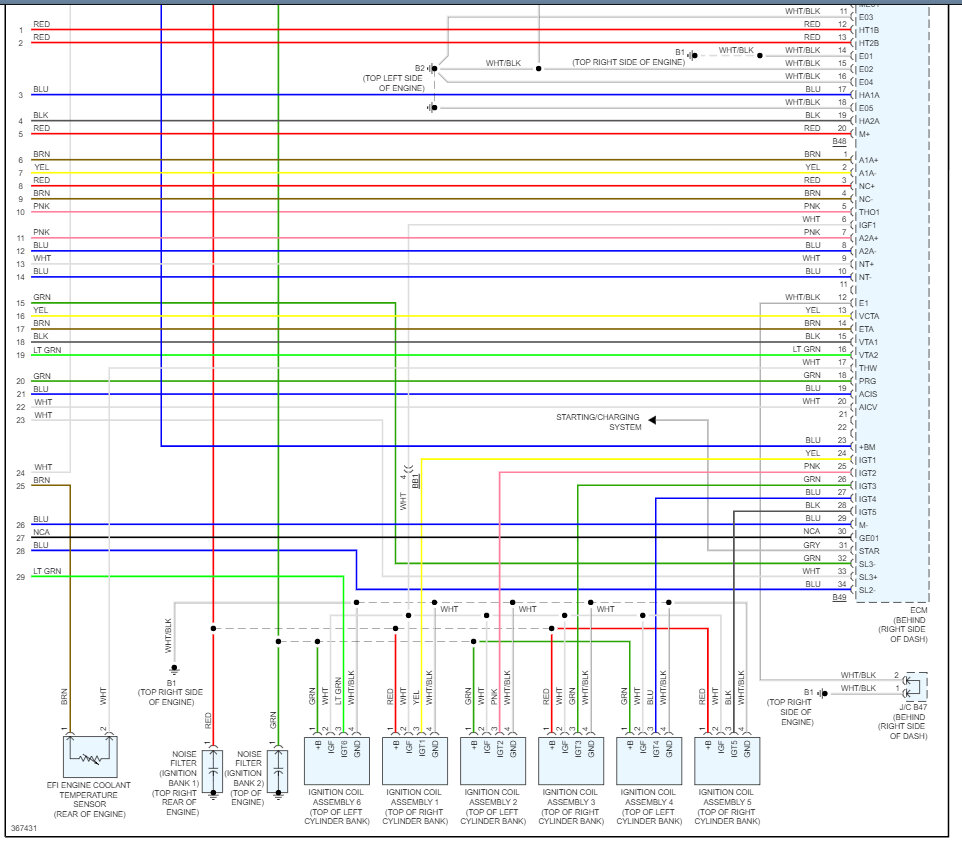

The vehicle had a burnt gasket, the gasket was replaced but it had misfire in cylinder three according to the scanner, it was checked and confirmed because the plug was soaked with fuel. The spark plugs and coil has been replaced but it seems to be the same. The coil is not to fire well. Please could you help me with the Engine Performance Circuit diagram?
Mar 3, 2023 at 7:40 PM
  • CAR REPAIR CONTRIBUTOR
  • 54,354 POSTS

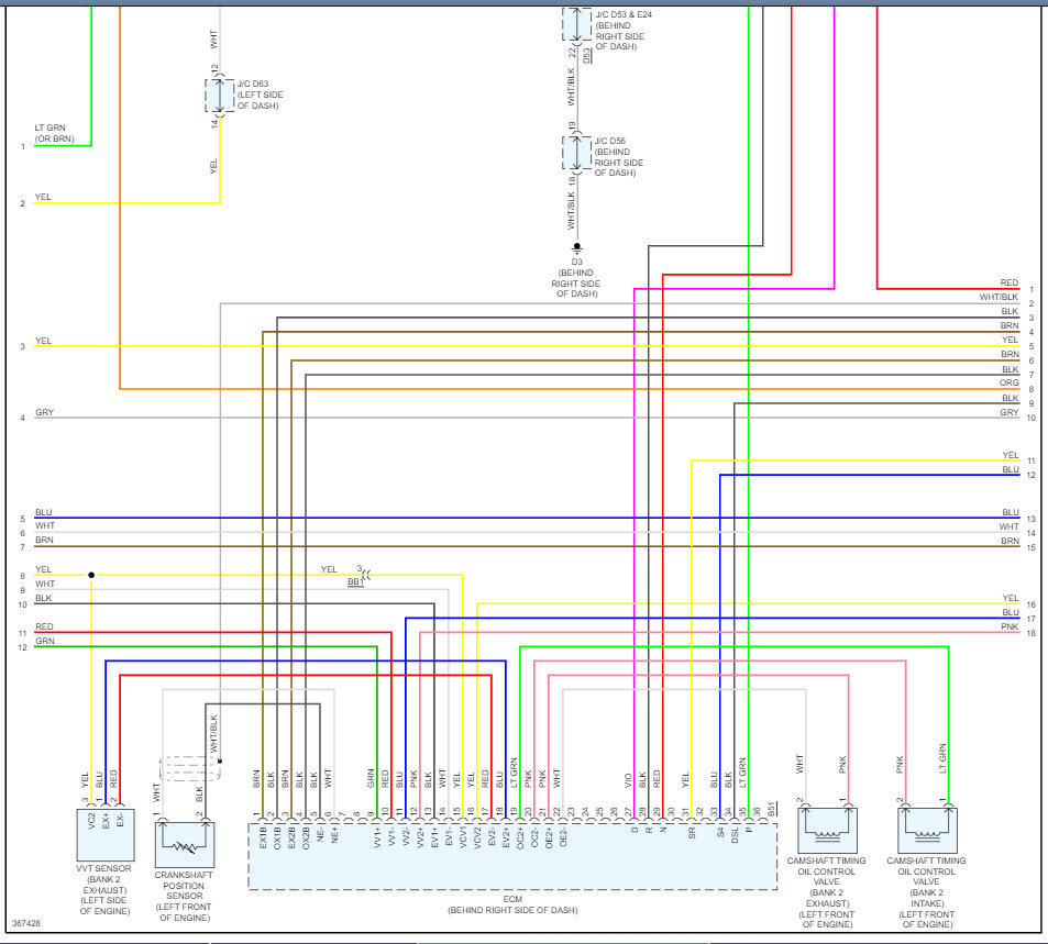

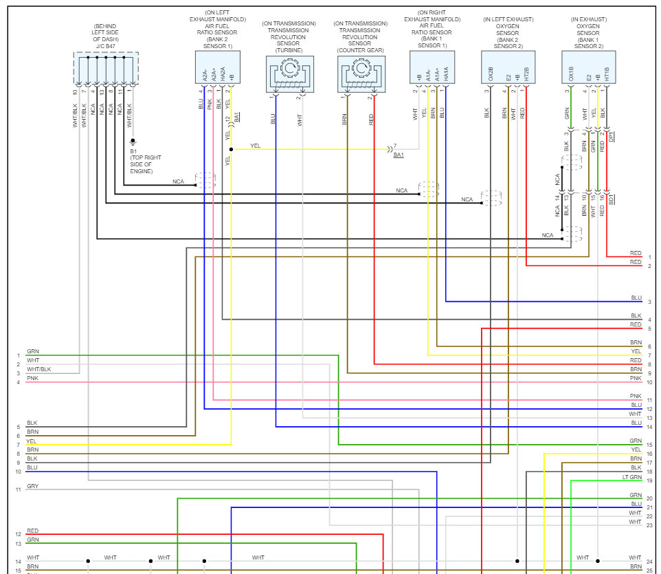

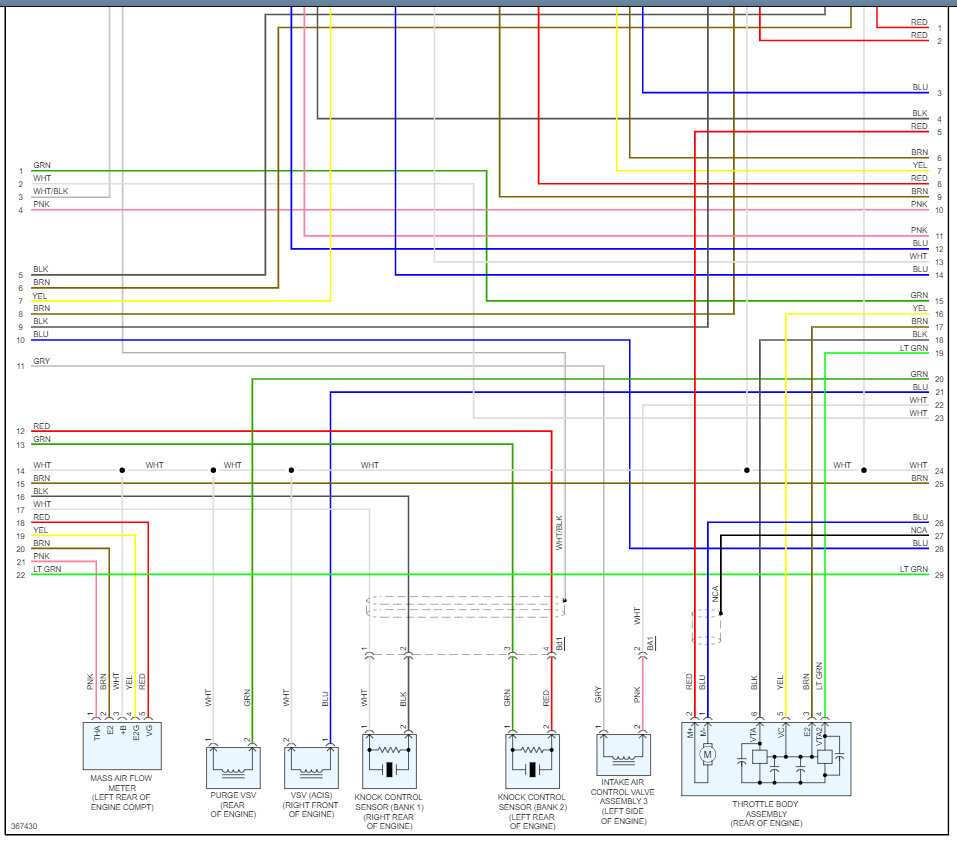

Sure, will do, but I need to ask does the cylinder have compression and if so, it could be the fuel injectors tuck on soaking the spark plug down. here is a guide that can help, and I have included the engine wiring diagrams in the images below so you can see how the system works and which wires to test.
Check out the images (below). Please let us know what you find.

I loosened the air intake manifold and found Engine oil inside of it. Is there any way for someone to test or know if the injectors are kept open?
Mar 4, 2023 at 6:26 PM
  • 54,354 POSTS
Yep, here is the test but the injector needs ro be removed first.
https://www.2carpros.com/articles/how-to-test-a-fuel-injector
Let me know what happens.

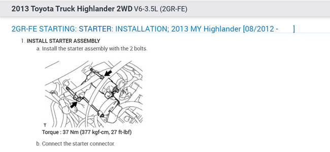

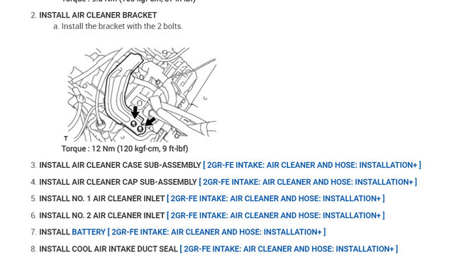

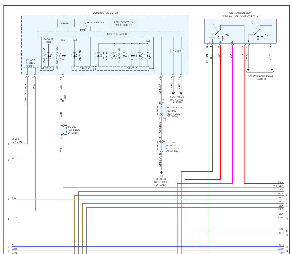

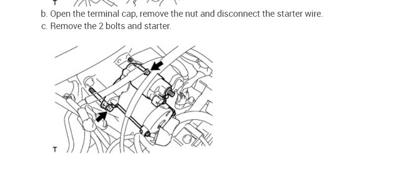

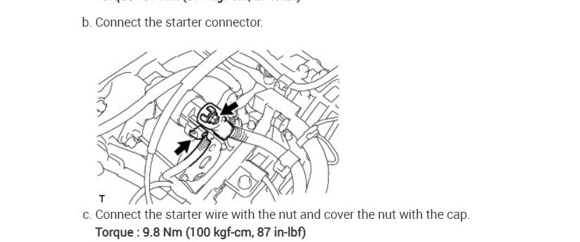

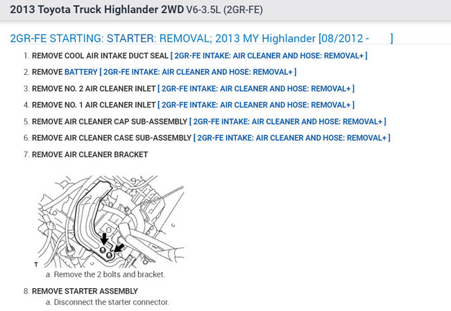

Good morning, sir, the vehicle had a blown head gasket, which was replaced, and the vehicle performed very well for the first 30 minutes on idle speed, then it stripped off by itself without knowing the cause of it. The engine was cranked, and it started running but tripped off again. As this time, the engine refuses to start, it will crank slowly as if it has low battery. The vehicle was scanned, and the code found was P1604. The starter is in good condition.
Mar 12, 2023 at 7:01 PM (Merged)
  • 54,354 POSTS

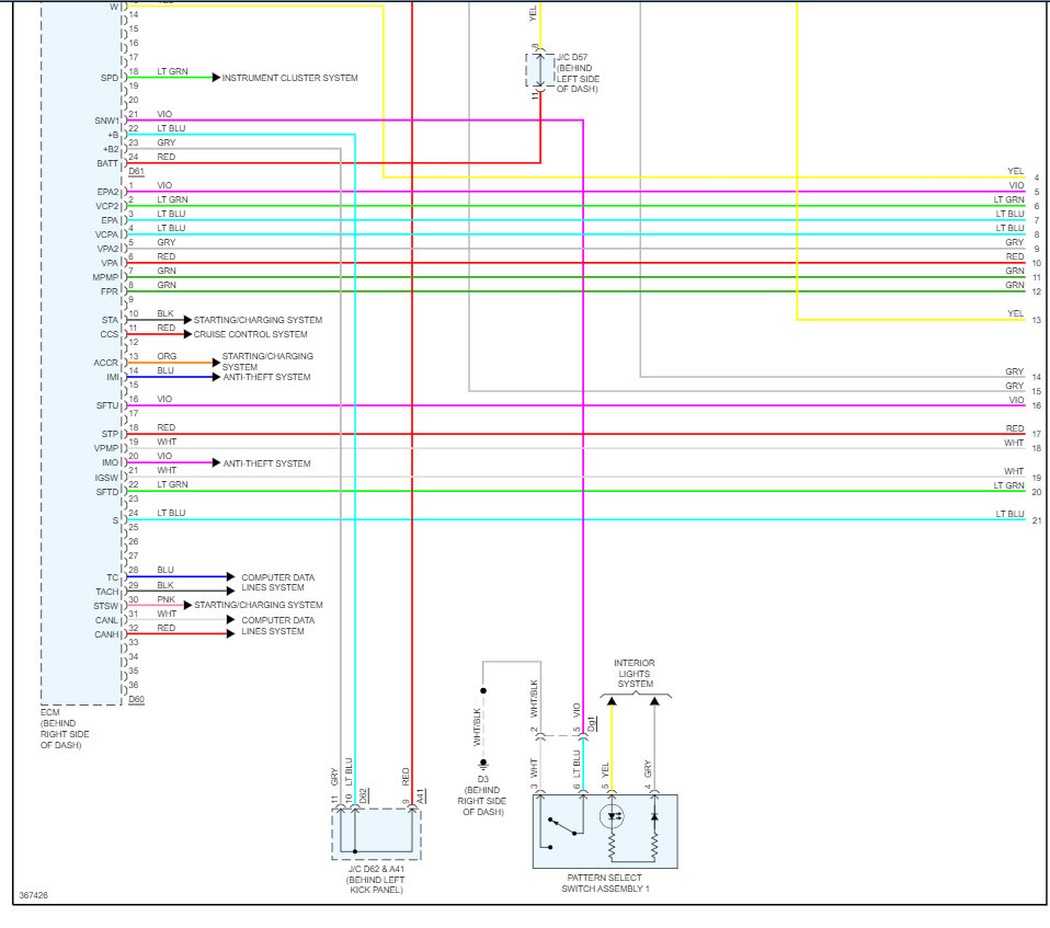

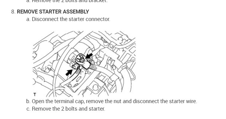

It sounds like the ground was not connected from the battery to the engine block, can you please confirm the ground is working? connoted and in good shape? Please check the images below for the diagram of the negative battery cable. Also, you can try to remove all of the spark plugs to see if the engine cranks the same and if not recheck the positive connections as well and then replace the defective starter.
Please check out these guides:
https://www.2carpros.com/articles/7-common-symptoms-of-a-bad-automotive-starter
and
Check out the images (below). Let us know what happens and please upload pictures or videos of the problem.
