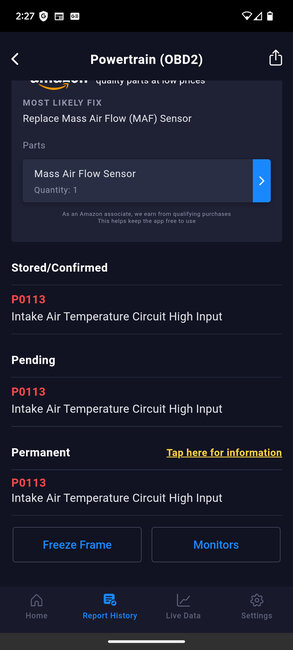

My car has an issue periodically the check engine light and trac control light comes on. I have scanned it and I get a P0113 code. I replaced the Mass airflow sensor with a quality part. What else could it be?

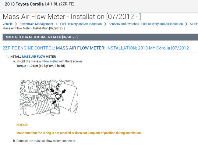

To be clear this is the part you replaced correct? Check out the images (below).

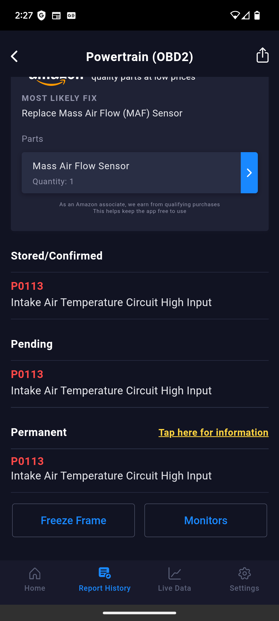

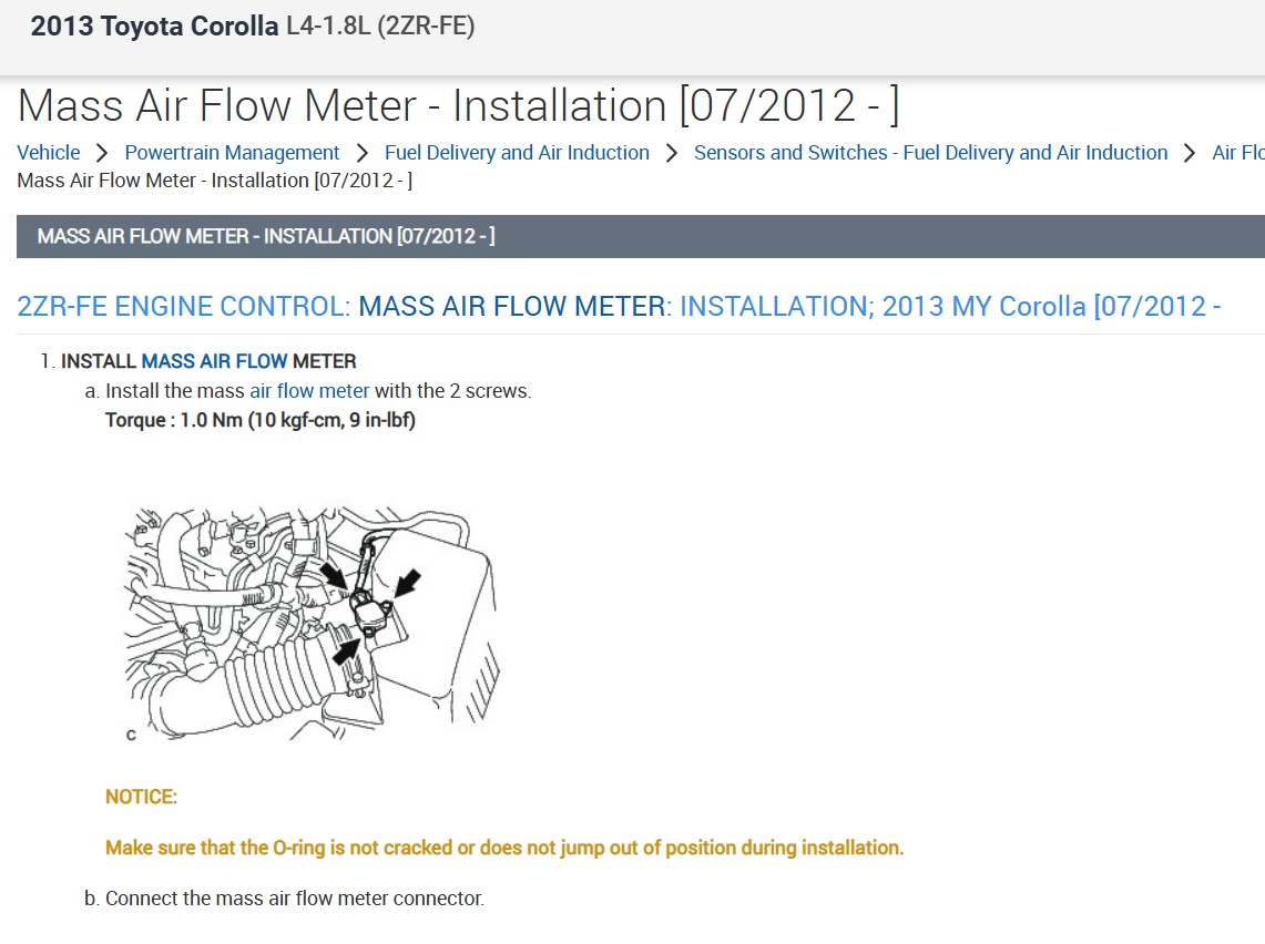

Yes, I cleared the code after installing the Mass Airflow sensor. I installed it about 2 months ago and didn't have any problem until yesterday day and today. Here is a screenshot of the codes I got today. I took out the Mass Airflow sensor and looked for the gasket, is it the one on the sensor?

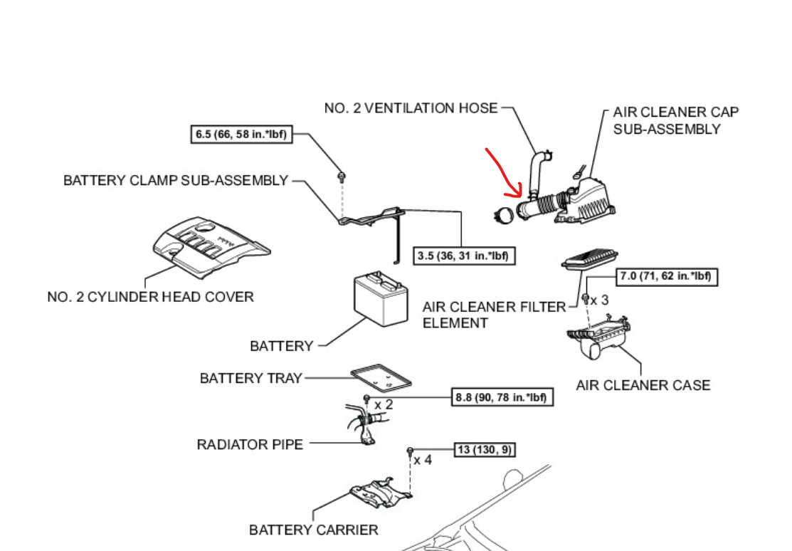

I would look for leaks before the MAF sensor in the air intake tube to the throttle body. If that looks okay the MAF must have gone bad, can I ask which brand it is? Also, if the engine has too much blow by it will fool the MAF sensor into this code. Check out the images (below).

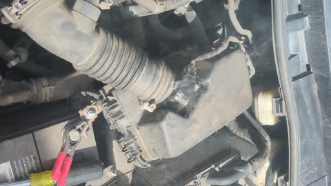

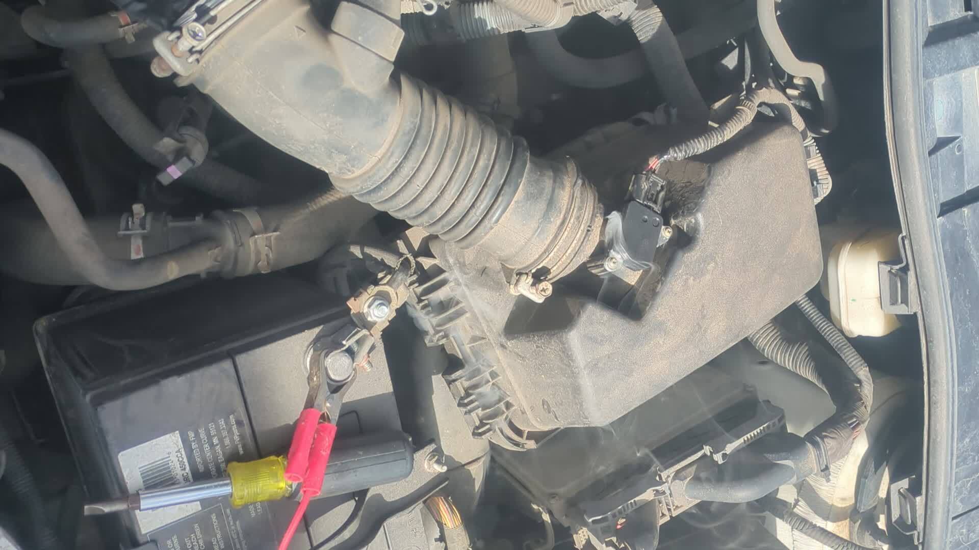

I put my smoke machine on the line and the only place it leaked is at the Mass Airflow sensor (see video). Am I missing a gasket?

Yep, that is a leak at the MAF sensor, can you remove the sensor and check the gasket?

Hi Ken, I have searched for a gasket for the MAS airflow sensor for our 2013 Toyota Corolla and haven't been able to find one. So I think it is the one on the sensor. We recently drove the car 573 miles and did no have a check engine light the whole way. While there the check engine light came on, then disappeared the next day. Do you think this points to an electric issue?

It is a P0113 code. As I said, we drove over 500 miles without having an engine code on. Then it came on and disappeared multiple times.

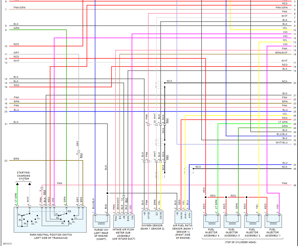

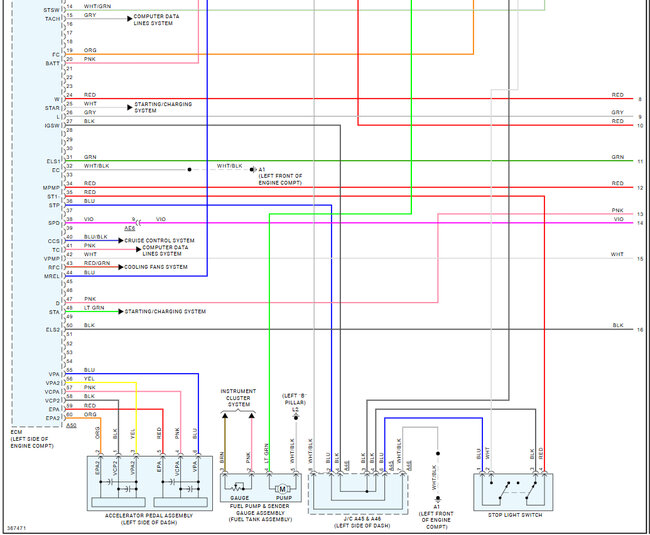

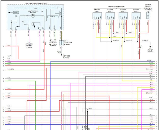

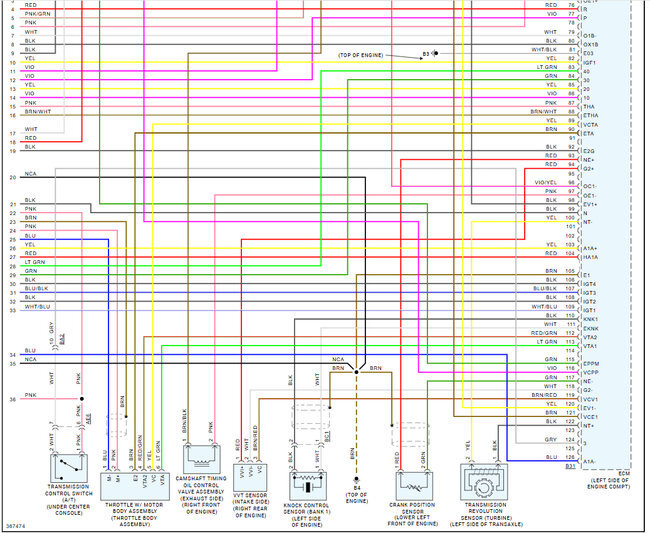

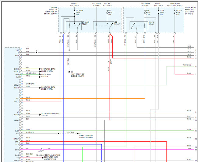

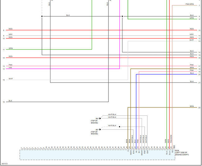

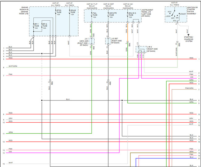

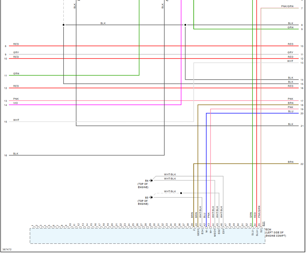

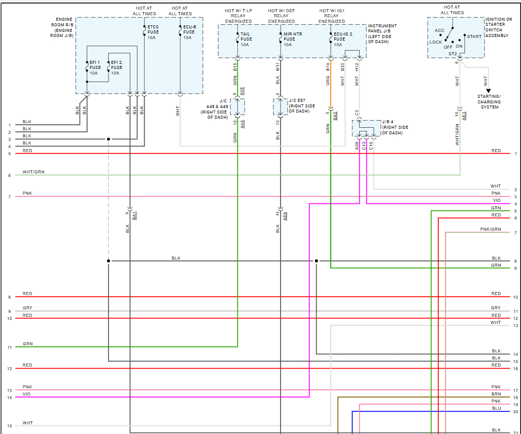

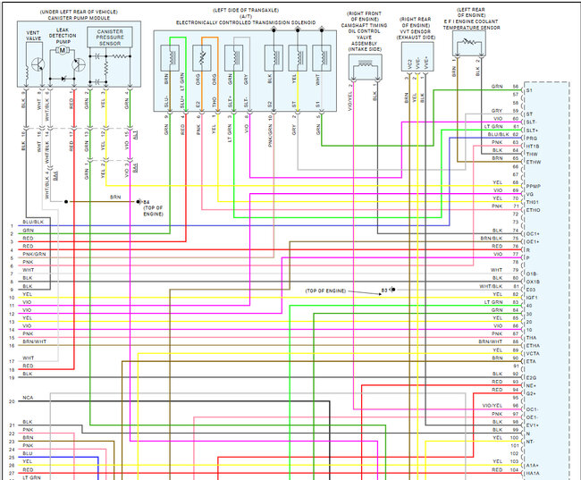

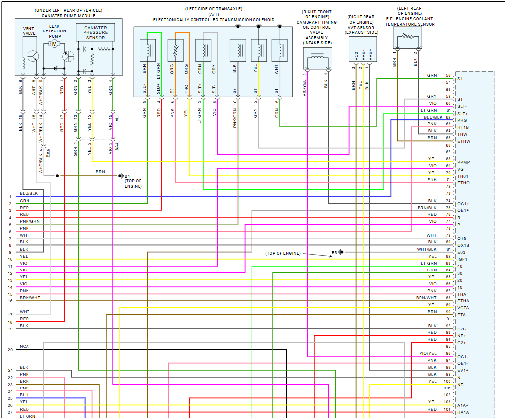

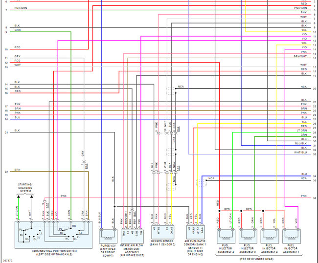

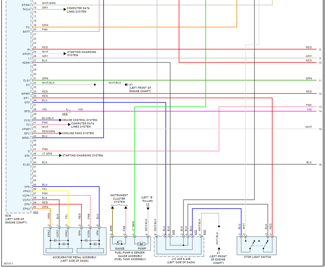

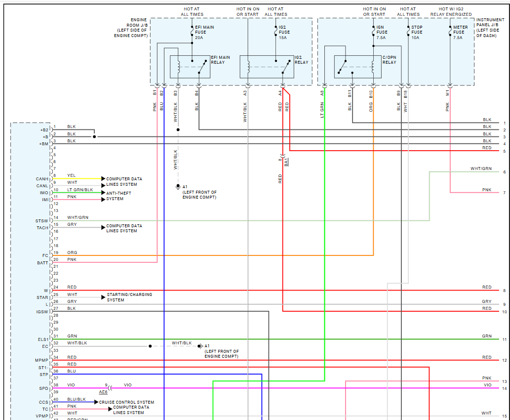

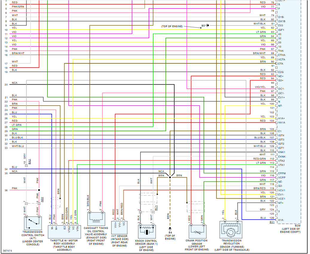

That is difficult, I would remove it and send it in for testing. But let's check the wiring connections first, this guide can help, and I included the PCM-engine and MAF wiring diagrams as well.

Yes, that is why I gave the wiring diagrams and a guide and how to test the connections. Also, I would try another sensor MAF to be sure.

The air intake sensor is inside the MAF, the code is circuit high, which means the sensor is getting too much value. I would try a name brand sensor like Denso. Also did you check the wiring connections with a meter?
