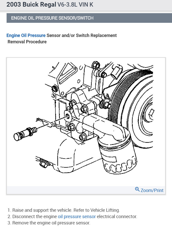

I recently found my scanner after moving, and plugged it in, there was no check engine light ever, but found a fault code: P1189 "Engine Oil Pressure Switch Circuit"
It does seem possible, that if the computer sees no oil pressure, it might shut the engine down, but then it is running again, just that quickly. I would think if it saw no oil pressure and shut it down, it would not restart in its own. I have never yet had to engage the starter to get it running again. It just resumes running again, as if ignition or fuel suddenly returned.
To be safe, I picked-up a new pressure switch, but for a few days now, I have checked for the code to return, and it has not.

That is exactly what is happening. The computer thinks there is no oil pressure due to a faulty sensor or wiring connection at he sensor is the problem most of the time. Do you have an oil gauge or light? If the oil pressure is good I would replace the sensor and check the connection here is the location.

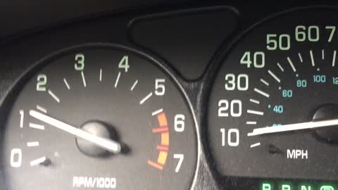

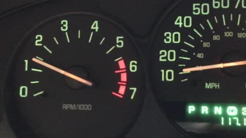

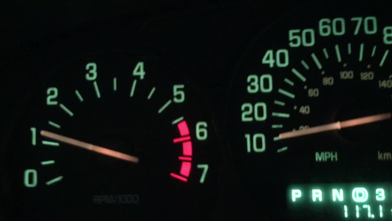

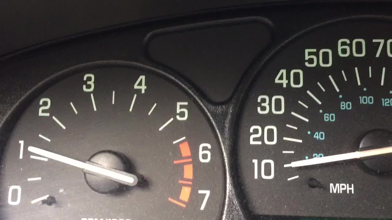

Here is a video or two, showing tachometer behavior during the brief (microsecond) engine cutout events.

PATRICK FLOHE
  • 20 POSTS
Here is one:
Monday, September 10th, 2018 AT 5:54 PM
PATRICK FLOHE
  • 20 POSTS
In both of these, you can see the tachometer jump upward, whenever the engine cuts-out.
