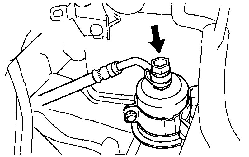

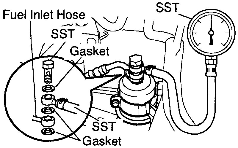

Now, I would also recommend checking fuel pressure. Here is a link that shows in general how it is done:
Here are the specific directions for your vehicle to check fuel pressure. The attached pictures correlate with these directions and the pressure specs are included in the directions. Keep in mind, even a partially plugged fuel filter can cause the problem.
_________________________________
FUEL PRESSURE INSPECTION
CHECK FUEL PRESSURE
(a)Check the battery positive voltage is above 12 V.
(b)Disconnect the negative (-) terminal cable from the battery.
see picture 1
(c)Remove the union bolt and 2 gaskets and disconnect the fuel inlet hose from the fuel filter outlet.

(d)Install the fuel inlet hose and SST (pressure gauge) to the fuel filter outlet with the 3 gaskets and SST (union bolt). SST 09268-45012
Torque: 29 N.m (300 kgf.cm, 21 ft.lbf)

(h)Measure the fuel pressure.
Fuel pressure: 301 - 347 kPa (3.1 - 3.5 kgf/sq.cm, 44 - 50 psi)
If pressure is high, replace the fuel pressure regulator. If pressure is low, check these parts:
- Fuel hoses and connections
- Fuel pump
- Fuel filter
- Fuel pressure regulator
