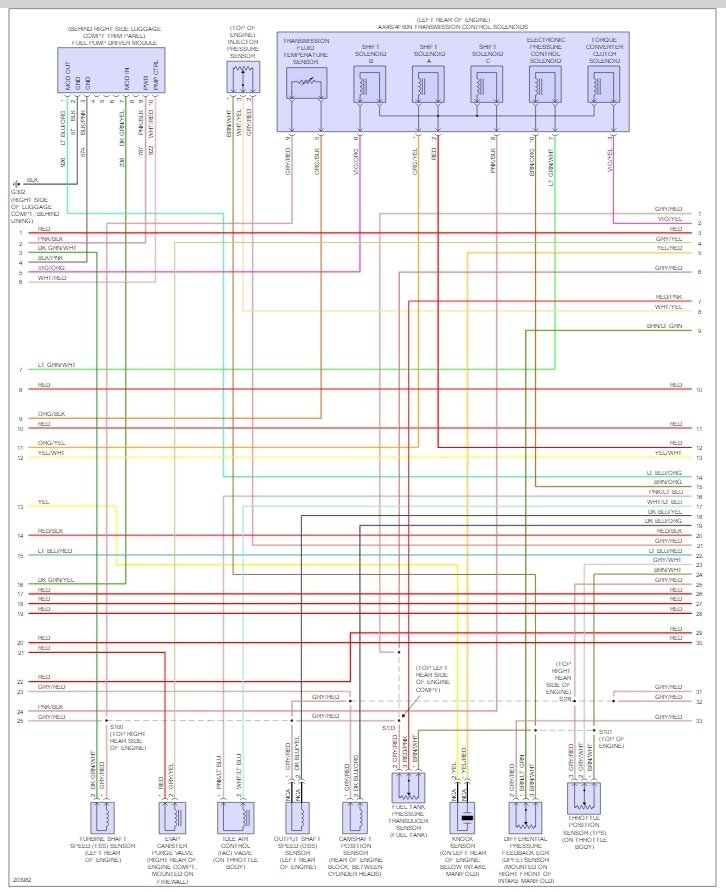

Why is idle air control valve getting a constant 12 volts causing the engine to idle at 3000+ rpm? I had to disconnect it.

12 volts is applied to the idle air control solenoid on the same circuit that supplies the injectors and other parts. Idle speed is controlled by the Engine Computer bringing the other side closer to ground.
Ford had a pile of trouble with the coolant temperature sensors in the early '90s. There's only one part inside it so they're normally extremely reliable, except for these. The resistance can bounce around confusing the computer into thinking it needs to raise engine speed in response to cold air coming in. That's a good suspect to start with.

I did all the above changes plus installed a refurbished ECM by Cardone. The car is now running and drivable but the IACV is still not working correctly so I put some resistance in line and got the idle speed down to 1100 with AC off and car in neutral.
Now with the different computer, the shift points are higher than they should be, similar in the older cars to the TV rod being out of adjustment.

Sometimes it takes time for the new computer to learn the transmission, here is a wiring diagram, you can see the wires come right off of the computer, have you done a pin to pin check?

Sorry here you go, please let me know.
