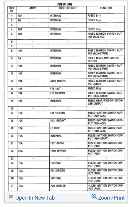

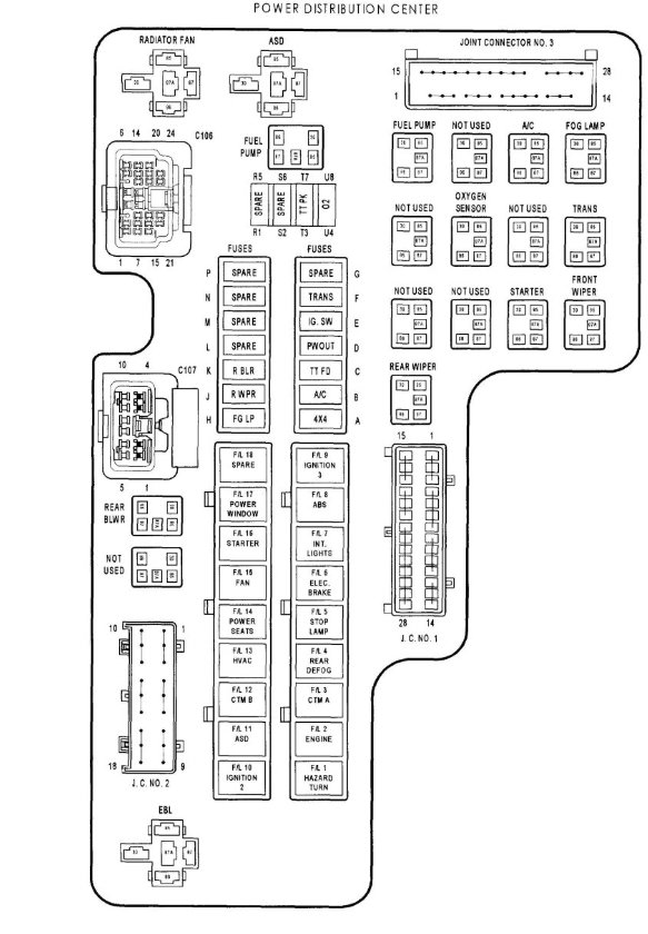

This is a common problem when the ASD relay goes out which is easy to replace because it self initializes. Here are the instructions to test unit and its location:
