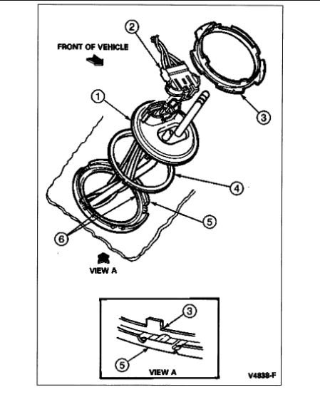

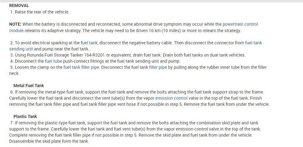

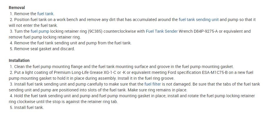

1. Low fuel pressure. If the pressure is low, it could not have sufficient fuel in the engine to rev up.
https://www.2carpros.com/articles/how-to-replace-an-electric-fuel-pump

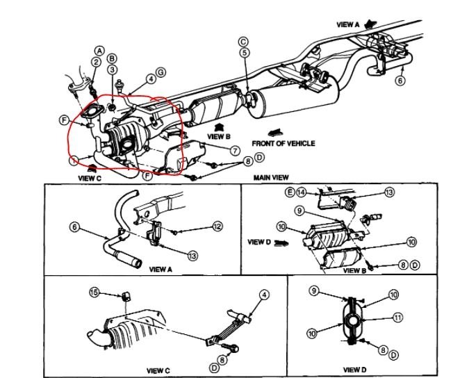

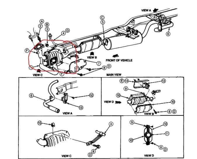

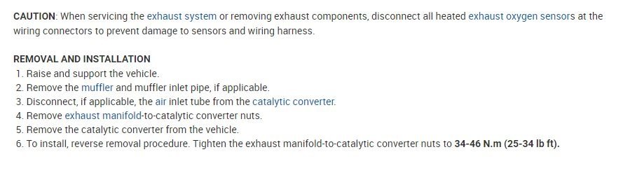

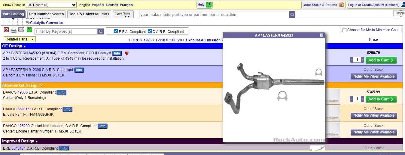

2. clogged catalytic converters. If the exhaust is blocked, it cannot breathe and there will be low or no power. You can check it by either using a back pressure gauge attached to one of the upstream O2 sensors or you can unbolt the head pipe from the manifolds and take it for a ride and see if the power has returned. I attached a picture of the part for you from Rock Auto.
https://www.2carpros.com/articles/catalytic-converter-replacement
