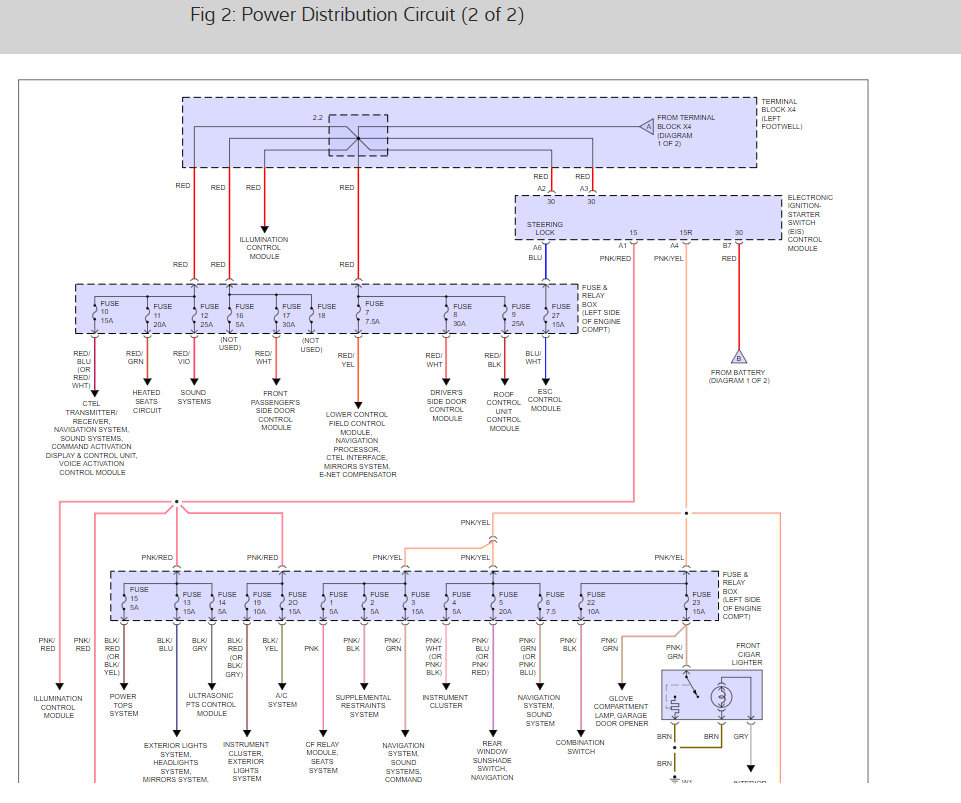

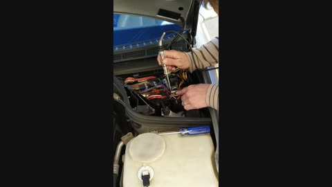

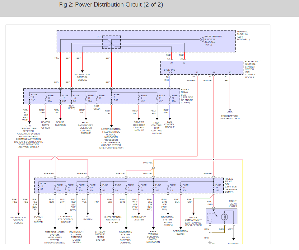

I let you in on what I've done to the car if I change to sandwiches. I changed the blinker switch twice. I've checked all the realizing change number changed. all the fuses. I've changed the gear, the gear shift. I changed the cable that goes to the transmission. put new light globes in the front after new light globes and stop lights in the back Nearly here I've checked everywhere with the multi-meter and the blinker switch is only getting half the power. the clock spring is getting power but only half the power through it all and the fuses are getting half the power. so I don't know. I change the battery as well. so that is everything I've done to the car.

would it be an open circuit problem that would that would cause the wipers the blinkers the air conditioning and the boot opening switch inside and the sunroof not to work properly and the horn?

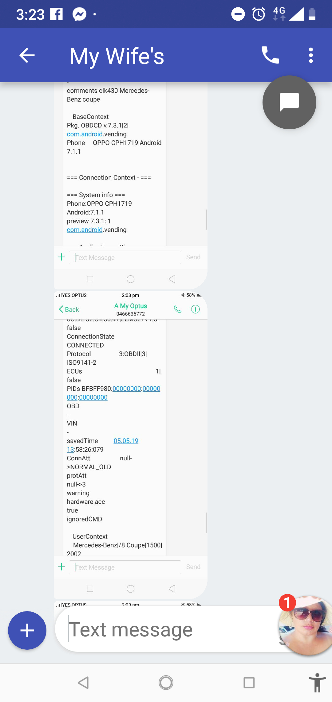

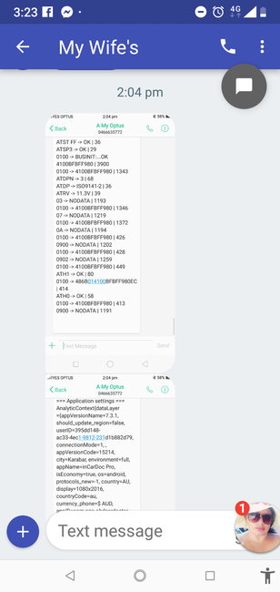

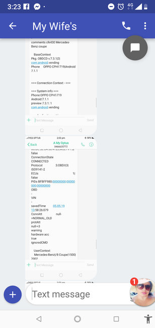

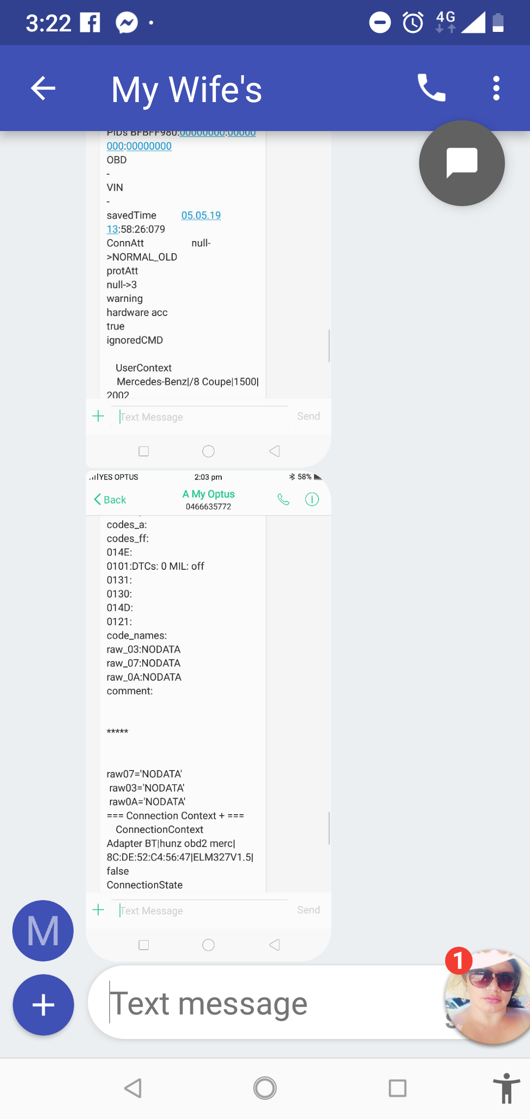

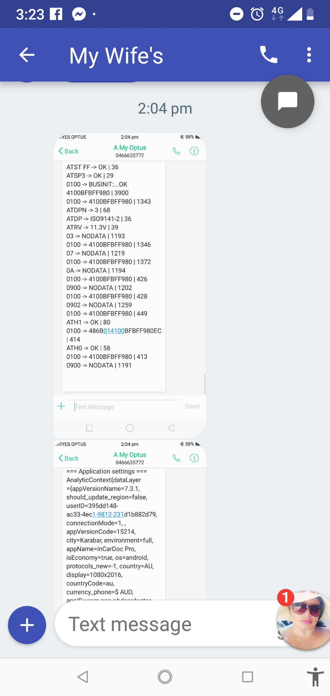

just replace the clock spring on my clk 430 and that means I replace the clock spring the same module the blinker switch all the relays and the fuses check the Earth and I've still got the same problem what I wanted to ask you is the instrument cluster on the dashboard has that got anything to do with the blinkers and the wipers?
Jun 5, 2019 at 6:12 PM
  • CAR REPAIR CONTRIBUTOR
  • 54,199 POSTS

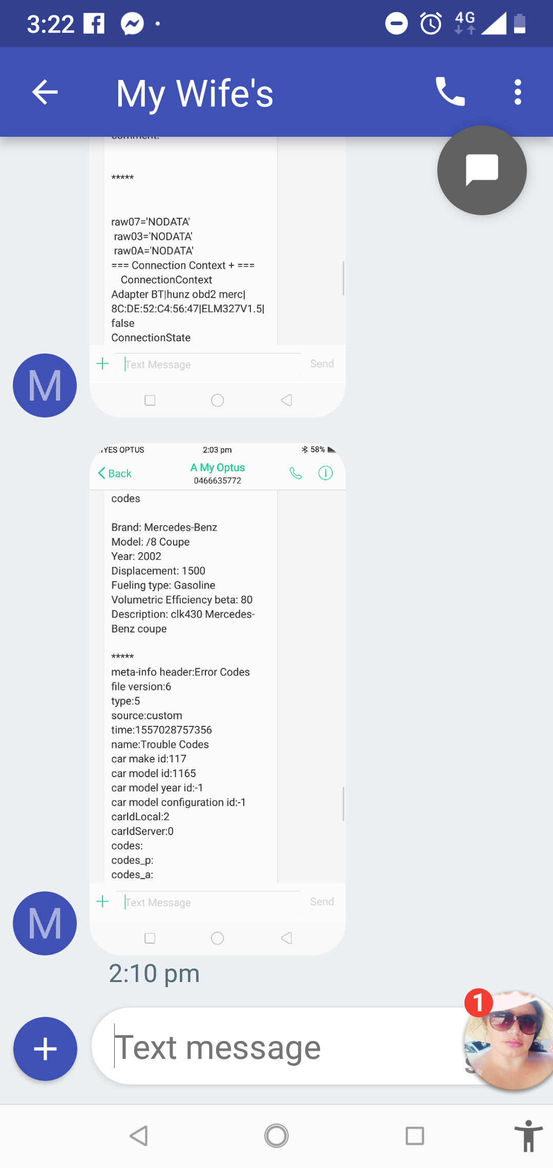

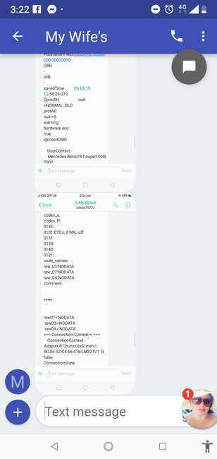

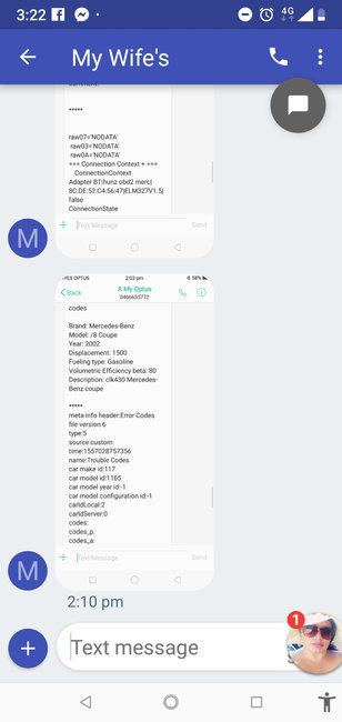

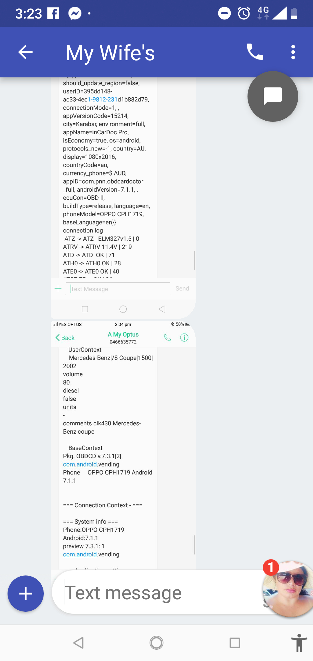

Yes it works together I would do a CAN scan which you can get a reader from Amazon for about $60.00 here is a video to show you how. This can tell you which part of the system is not working so we can fix it.
