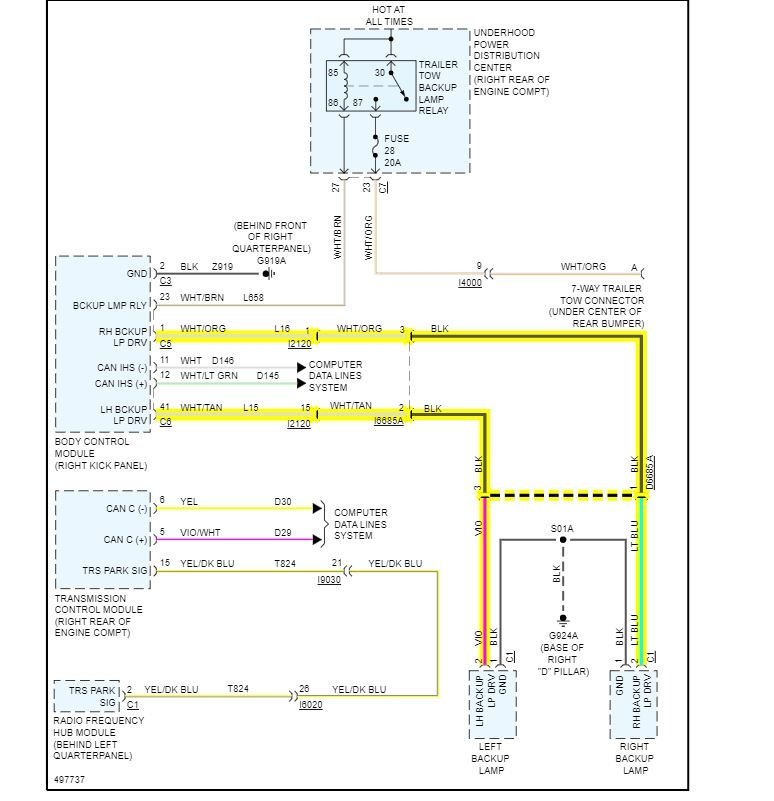

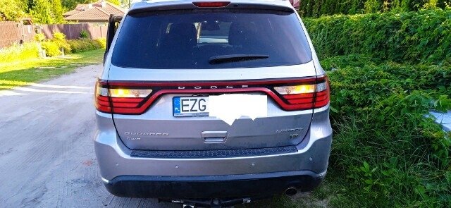

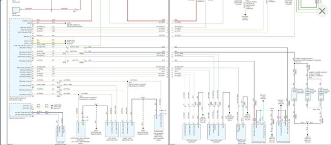

I bought the vehicle listed above from USA market. I live in EU country and I have to do some modification. I would like to know the wiring diagram for front and back lamps. I have change rear turn signal color and add rear fog lamp for EU regulations. I can see that there are 4 bulbs for reverse gear. I would like to know where the wires go to?

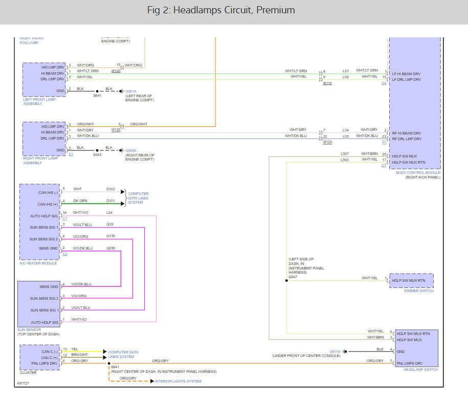

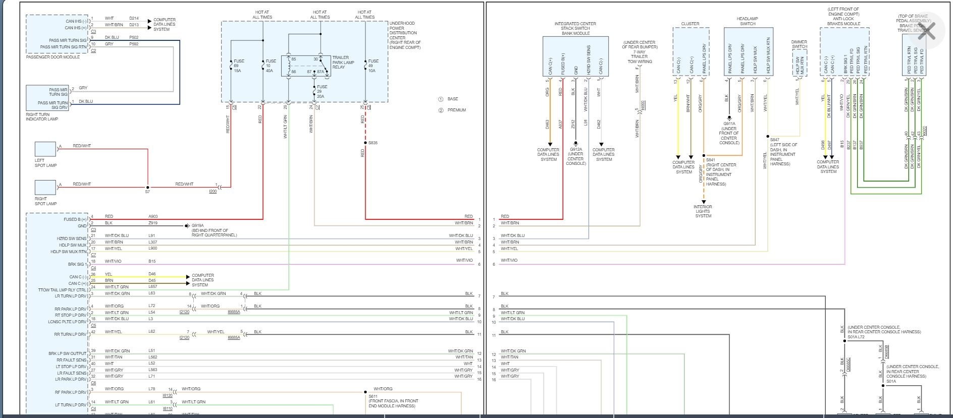

Good morning,

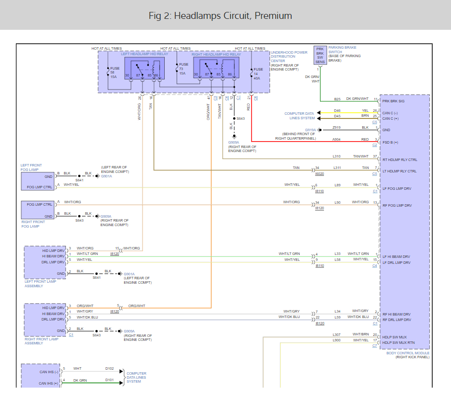

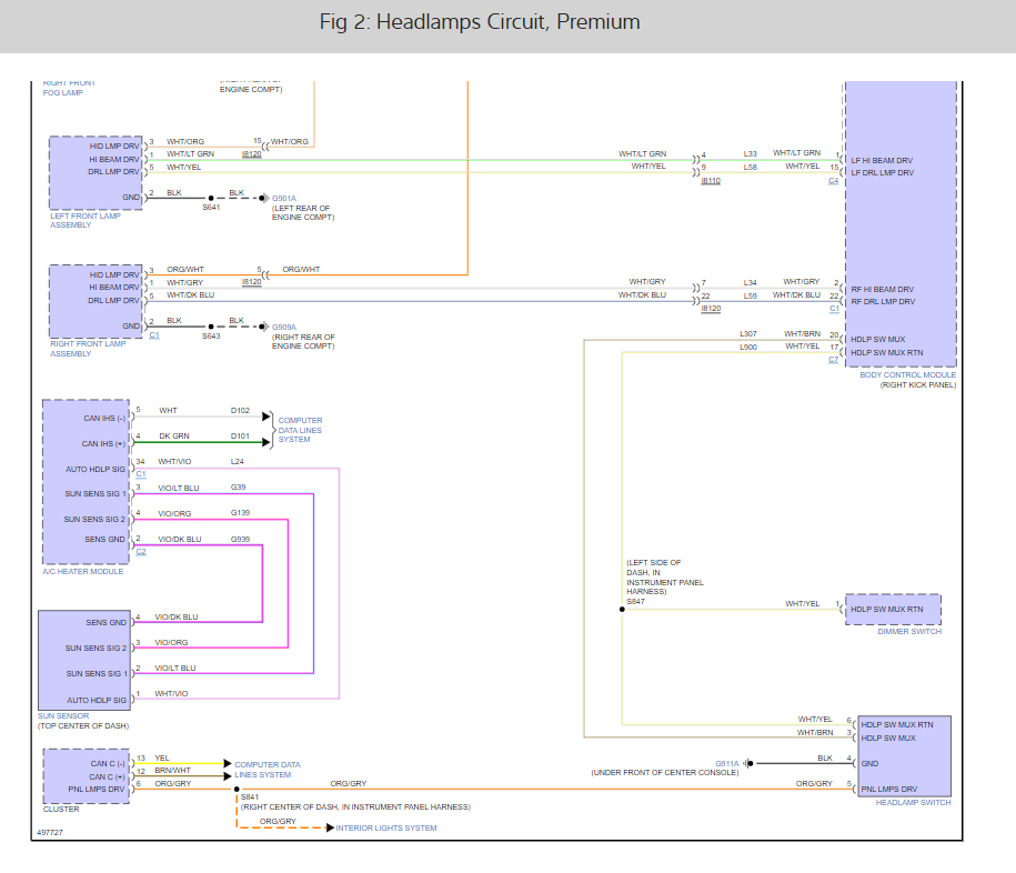

I attached the wiring for the backup lights, park lights, and headlights.
The body control module is what controls the lights based on the input from the headlight switch. Check out the diagrams (Below). Please let us know what happens.

Dear Roy,
Thank you for your reply. It is okay now. The diagrams are helpful.
But I can't find 4 white bulbs for reverse gear / backup light on rear/lift gate. There is only two wire - Left and Right side. Where is located split/junction point?
Monday, March 28th, 2022 AT 1:38 PM
I don't see any diagram with the 4-wire setup.
I circled the connectors, but they didn't give a location. The one is back by the taillights, but you will need to open the harness to check for that connector and see if it carries the extra wires for the 4-light system.

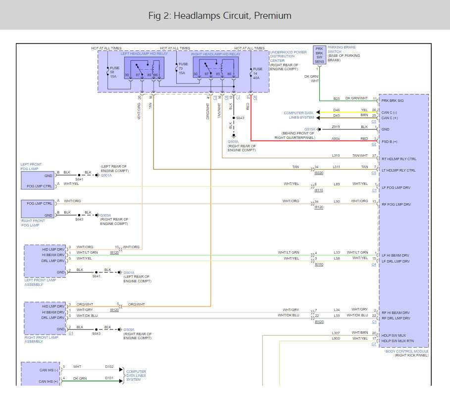

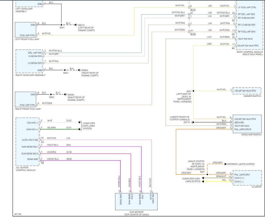

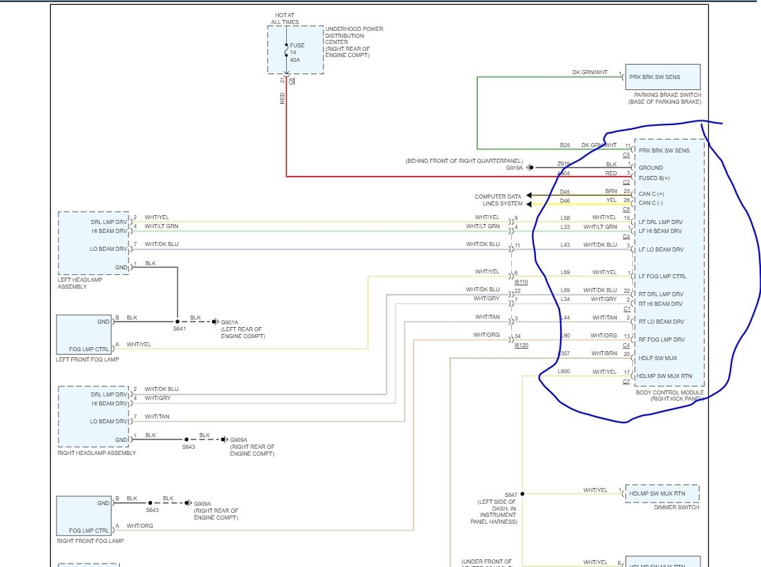

I have done the rear stop and turn lights. I have to add rear fog light. I would like to connect the front fog light with the rear fog bulb. Could you please add diagrams for front fog lamps? And location the proper wire/junction/connector on BCM for fog front lamps.

There are both yellow/amber turn signals.

KEN L
  • MASTER CERTIFIED MECHANIC
  • 55,440 POSTS
It looks like the fog light are controlled by the BCM. Here are the fog light wiring diagrams you asked for. Check out the diagrams (below). Please let us know if you need anything else to get the problem fixed.

Super :-)
Thank you very much for your reply.
