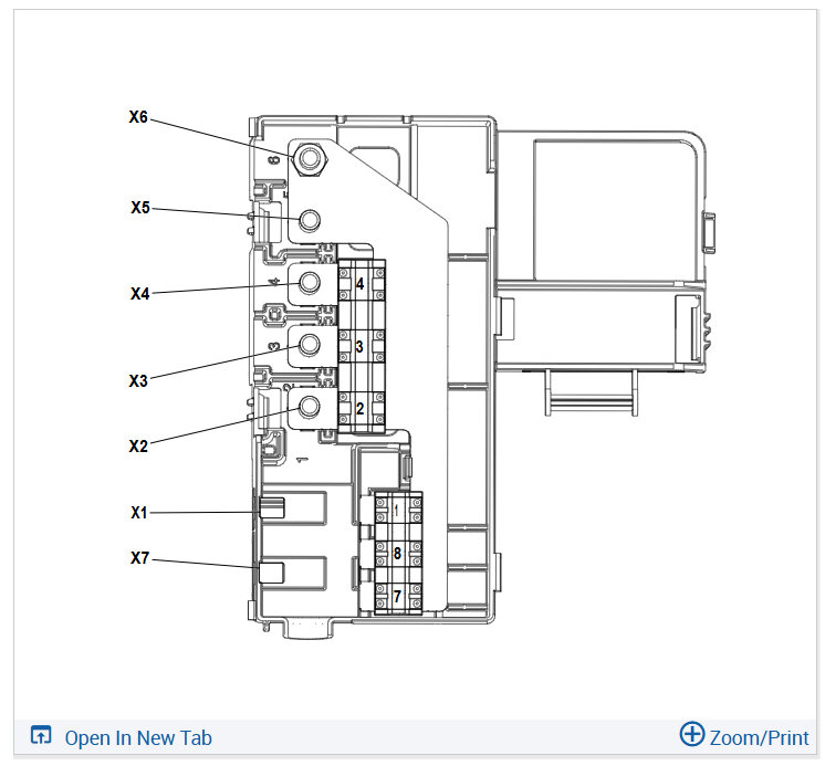

Tightening the negative battery cable the wrench came in contact with the body producing some major sparking, is this a short in positive line. At the same time there's no start, no turnover, no dash lights yet radio lights and display lights seem to work. checked fuses and relays all good there. When I try to start everything shuts down. Any ideas I don't have much hair left.

Yep, electrical problems can be tough. If you were working with the negative cable there should have been no sparking, are you sure it was not the positive cable? It sounds like you may have a bad battery or a bad connection at the battery cable ends. But we should check the MAXI fuses in the fuse panel near the battery. Please check for power through them, also I would have the battery checked. These guides can help:

Check out the images (below). Please upload pictures or videos in your response
