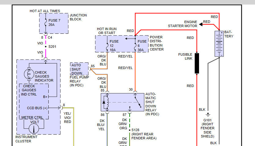

I drove the Jeep everyday let it sit for a month battery was dead would not start jump-started it would run on a couple cylinder according to a garage computers not getting 12 volts

Security is not the issue it still fires up and runs on about six cylinders. If you give it a little gas all the dash lights blink like it has a drained battery and the only gauge not working is alternator.

Scan for codes then. it may be a bad coil or a wiring issue or possibly a bad ECM. Check fusible link to alternator. See picture, then do a parasitic draw test on battery as well as check for condition including load test. Most places do for free.

It has a new battery and it drains over night. According to the scan tool there is no codes. The garage said the PCM has low voltage.

Then it may be a short in wiring to PCM or a bad PCM. You should let the garage check it out as they are familiar with it.
