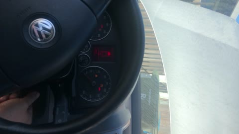

It seems to be an electrical problem with the car. It wont start and we found a short on the vehicle that has been draining the battery. We've been trying to trouble shoot the problem as I bought the car as is but still cant figure out what is wrong with it. The mechanic said it was the timing chain but when we checked the chain it was fine. Changed the PCV valve and valve cover, changed the camshaft and crankshaft, changed the spark plugs, changed air filter. This is what we narrowed the problem down to. When it started it started with a misfire but now it doesn't start at all. Not sure what it can be now.

Here it is not starting. We found that the alternator was bad so we changed it after testing it at AutoZone. Sorry for the late response.
