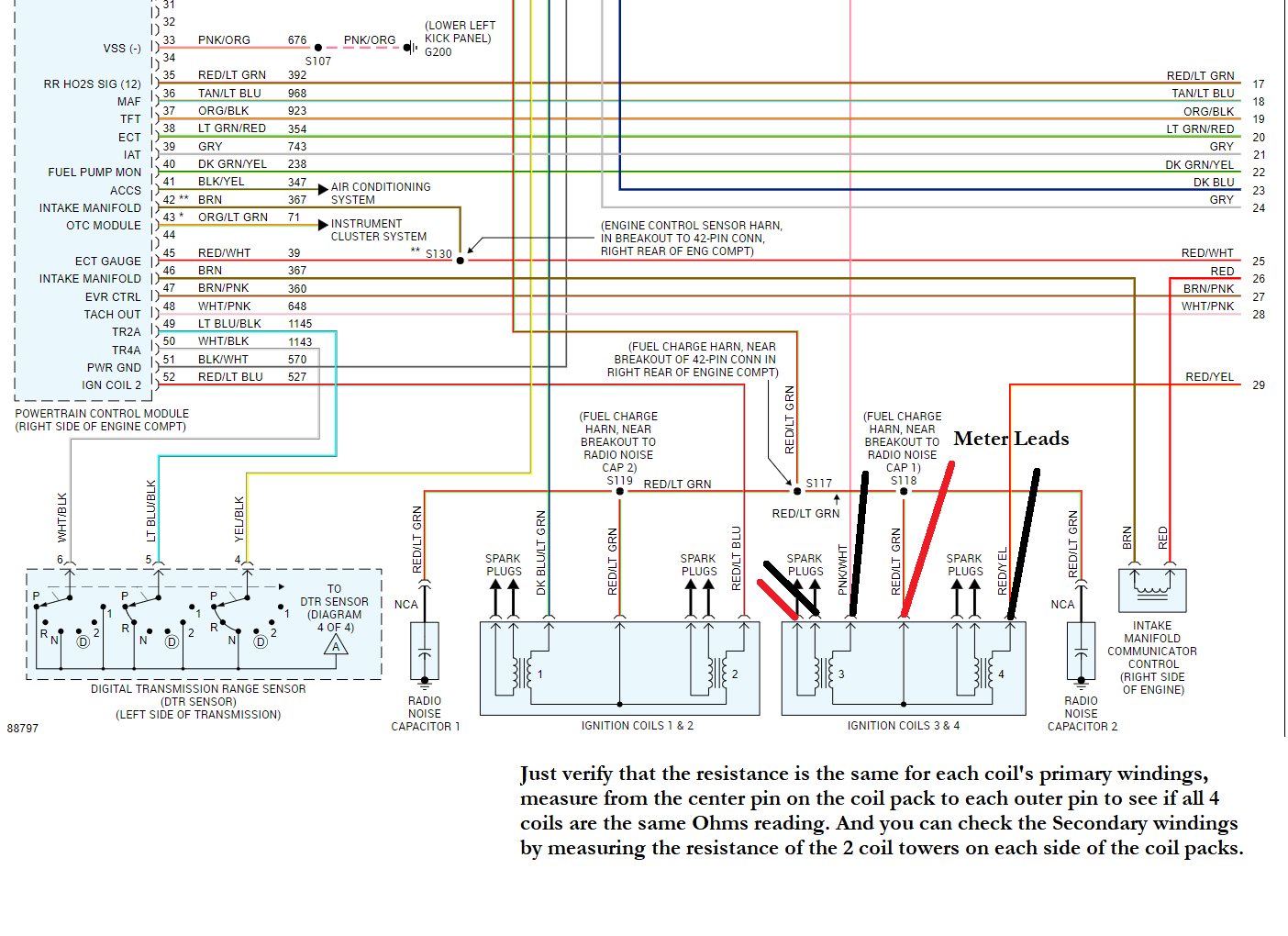

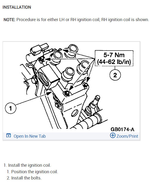

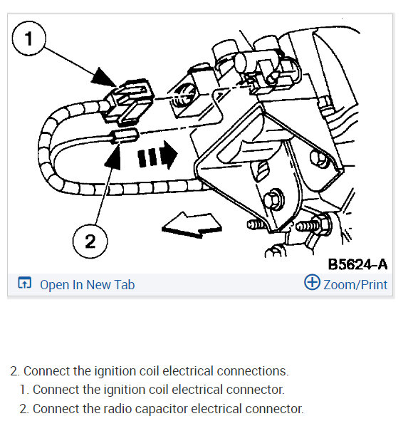

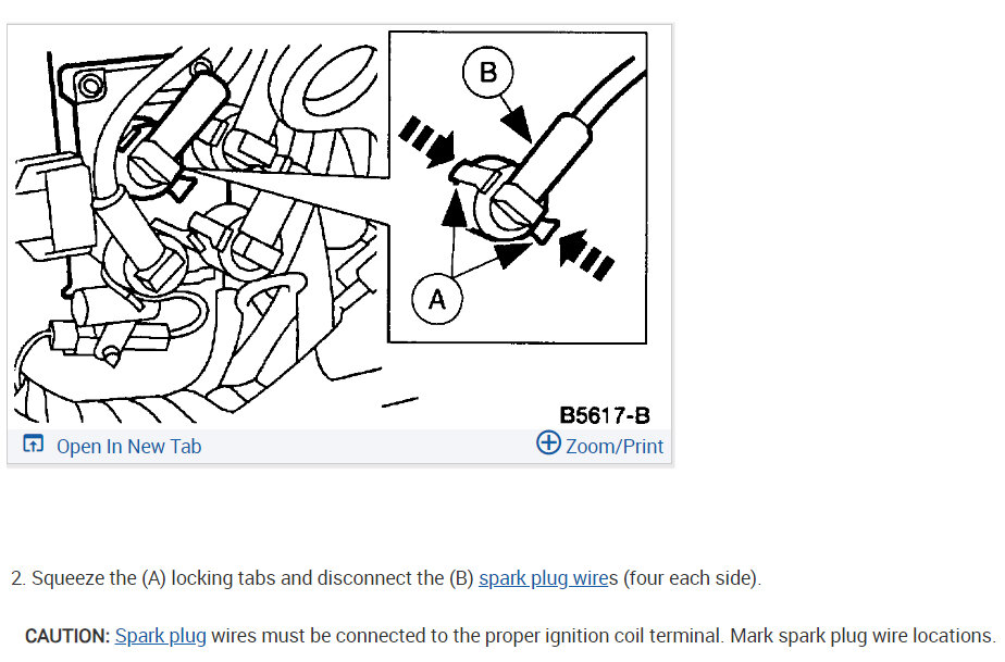

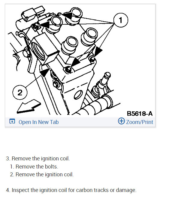

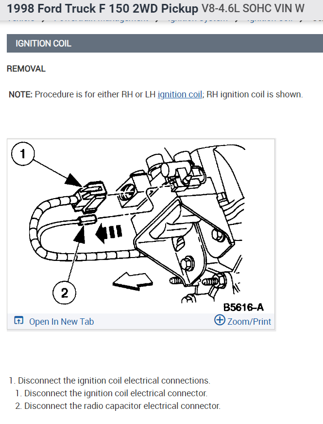

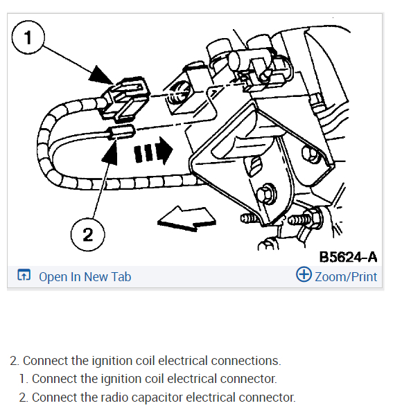

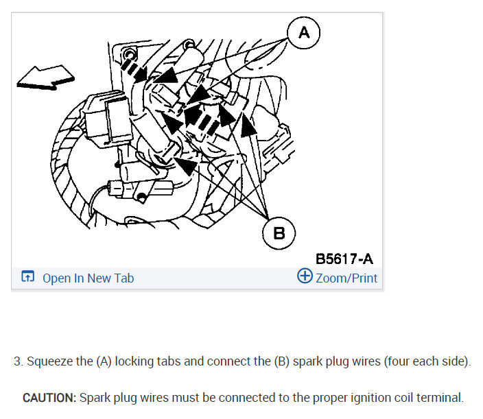

The coil packs on these trucks had a problem that would cause the issue you have described. here is how to change it out, also we should run the codes to see which codes are stored.
This guide should help us:
Check out the images (below). Let us know how it goes.

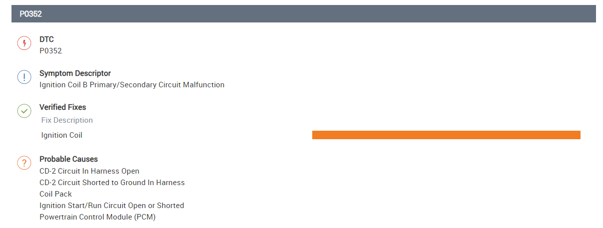

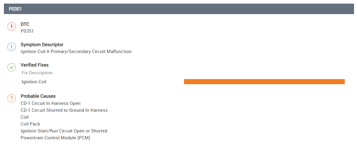

P0351, ign coil A primary/secondary circuit
P0352, ign coil B primary/secondary circuit

Hopefully one of the previous coils didn't short out and burn a coil driver inside the PCM. We can check for that later. You can check the resistance of each coil pack to make sure they are the same.
If they all test the same, the Primary's are the same and the Secondary's are the same, next I would check for continuity from the coil packs harness connector on each outside pin to ground. To see if there is a short to ground through the PCM on any of the coil control wires.
If that checks out ok, unplug the PCM connector and do the same test to check for shorts to ground in the harness between the coil packs and PCM, but with the PCM unplugged, that isolates the fault to the harness only.

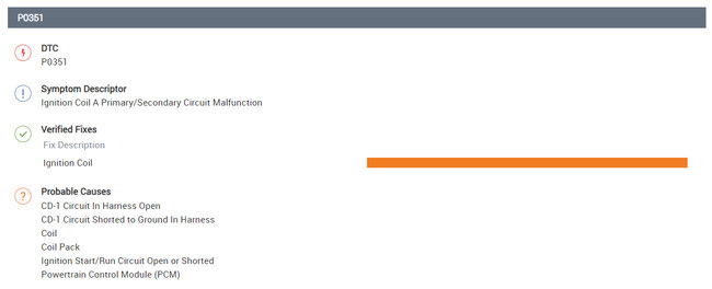

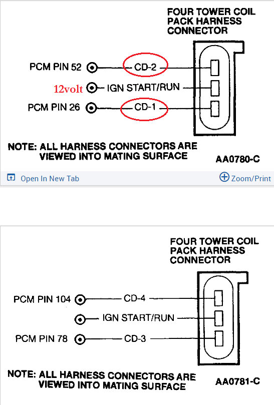

I would check the resistance of the coil packs if you bought used ones off of Ebay. These codes are coil circuit codes, the PCM is not detecting either any voltage or current on the coil control wires CD-1 (Ignition Coil A) and CD-2(Ignition Coil B). Start by checking for 12-volt on the middle wire of the coil pack connector, if there's power check the resistance of that coil pack. You can also hook a test light to battery positive and check for control on those 2 outer pins on the coil pack connector while cranking. What happens if you swap the coils, does it start at all?
