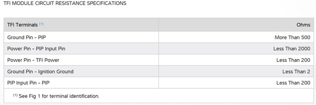

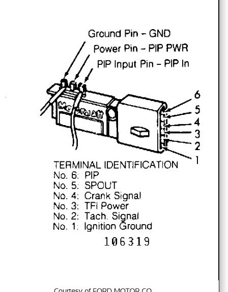

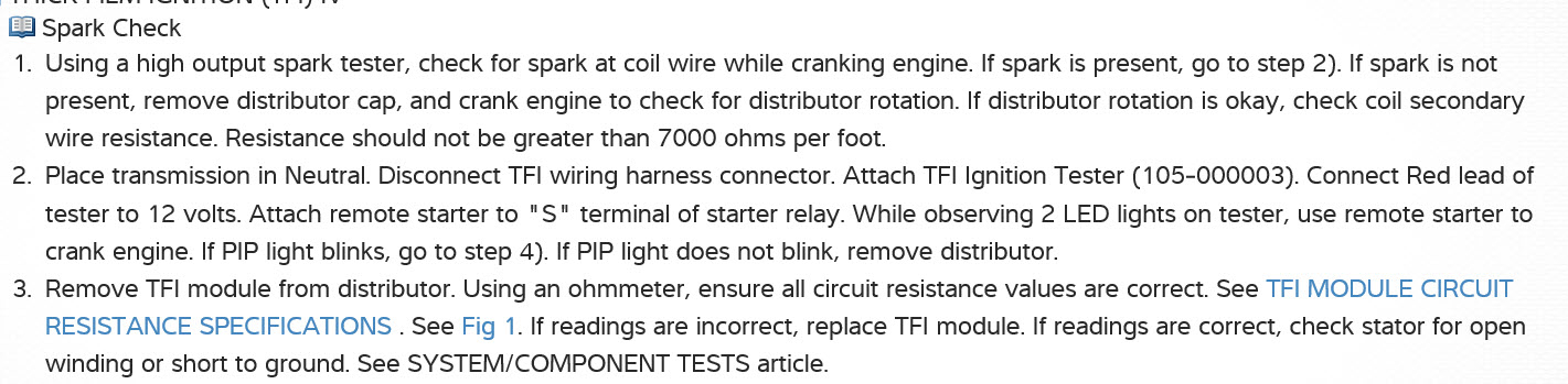

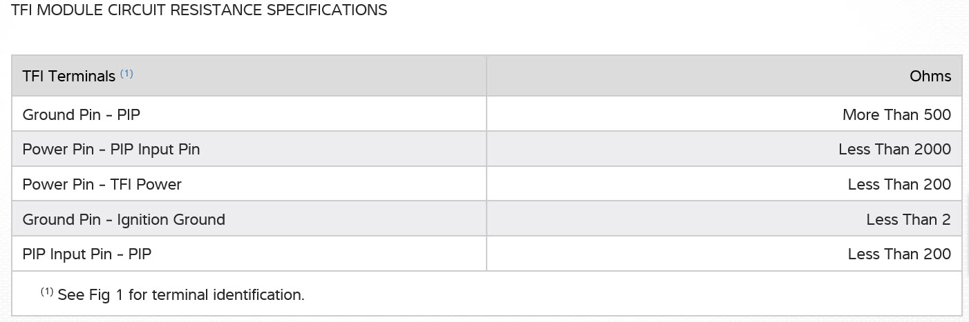

HMAC300
  • 48,601 POSTS
See pics
Monday, January 4th, 2016 AT 3:44 PM

HMAC300
  • 48,601 POSTS
Doesn't matter tests same way

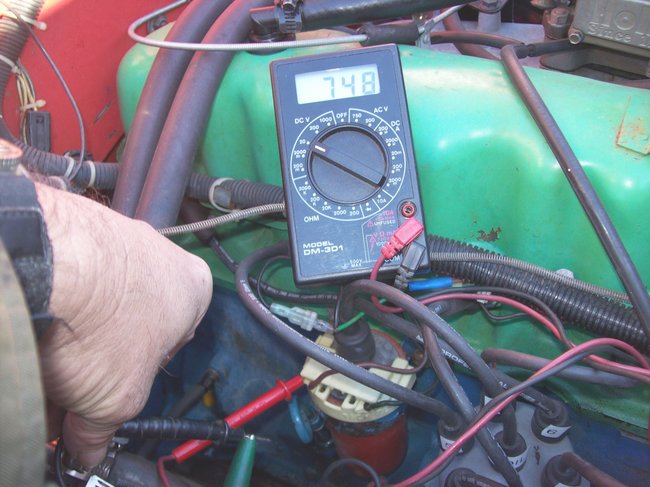

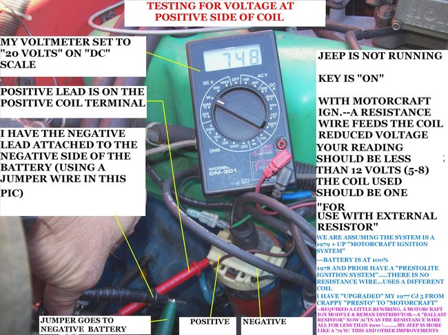

CJ MEDEVAC
  • 11,004 POSTS
DIFFERENT GUY
WITH A VOLTMETER [PREFERRED](OR IN DESPERATION, A 12 VOLT TEST LIGHT MAY CONFIRM THERE IS POWER ANYWAY)
TEST THE POSITIVE SIDE OF YOUR COIL WITH THE KEY "ON"
THEN TEST IT AGAIN, WHILE YOU CRANK IT
ARE YOU GETTING "JUICE" IN BOTH SITUATIONS?
ALTHOUGH THE PICS I'M PROVIDING LOOKS NOTHING LIKE YOURS (IT'S OF MY '77 JEEP CJ-5) IT'S THE SAME SET-UP FOR THE VOLTMETER. DISREGARD THE "JEEP INFO" IN THE EXPLANATIONS.
AUTO PARTS STORES HAVE DIGITAL VOLTMETERS STARTING AT ABOUT $20, HARBOR FREIGHT HAS 'EM FOR ABOUT $5.
KEEP ON FEEDING THE BOTH OF US SOME FEEDBACK!
THE MEDIC
