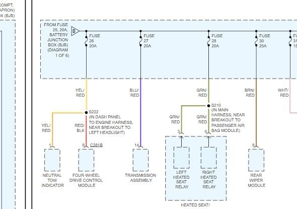

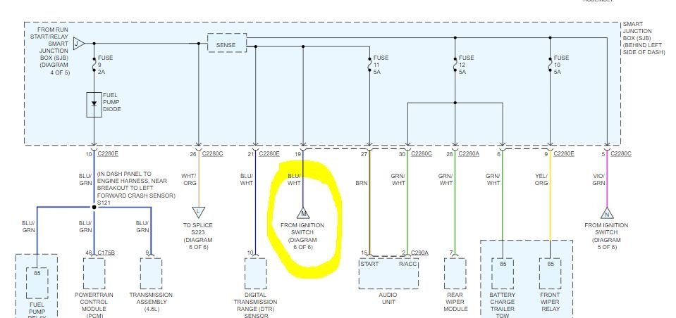

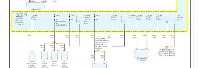

I attached the fuses and power sources. All these fuses are fed from the ignition switch.
+1
Wednesday, March 13th, 2019 AT 3:41 PM

Power to all those fuses come from the switch. If the switch is good, then I would suspect the fuse block itself.
Why it happened, I do not now as I am not there to check it myself.
