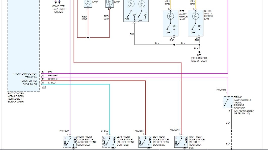

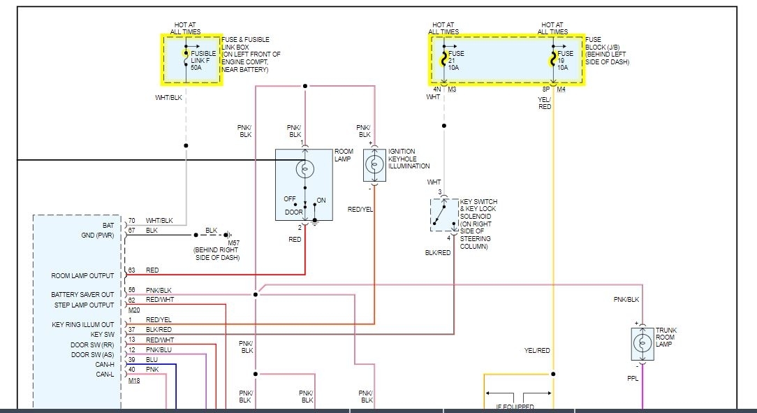

All interior lights not working and don't have a blown fuse.
Mar 21, 2020 at 11:16 AM
  • CAR REPAIR CONTRIBUTOR
Good afternoon,

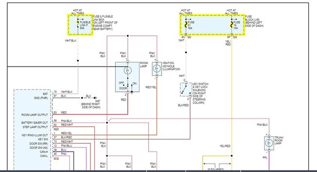

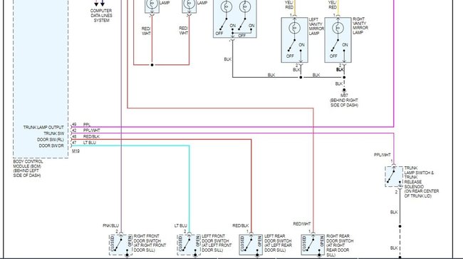

I attached a diagram for you and you need to test the fuses listed for power on both sides.
This is not a visual test but a voltage test.
Check these fuses and let me know.

okay Roy, thanks for getting back to me so quick. I had to go get a test by so I can check those. I didn't think about that. I'll get back to you oh and by the way the transmission lock is on too but I use a screwdriver to unlock it and drive it so say it's in the same system.
