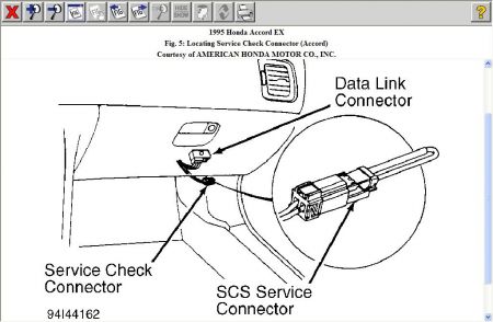

HI, I have a 1995 Honda Accord, when it gets up to temperature, the check engine light will come on and the car will die without warning, this all happens at once. Sometimes it will start right back up and sometimes it will take up to half hour, once started it will go anywhere from 5 feet to 20 miles and then die again. I replaced the cadialitic converter and that did not solve this problem, I can not get a diagnostics test run on it because it has no plug in. Please Help!
Thank You,
W. Kipp
Jan 9, 2020 at 12:51 PM (Merged)
KHLOW2008
  • CAR REPAIR CONTRIBUTOR
  • 41,814 POSTS
Hi W. Kipp, You need an OBD I compliant scanner or diagnostic tester to gain access via the DLC. For manual DTC retrieval, bridge the SCS connector and count the blinks of the CEL with the ignition switch turned on.

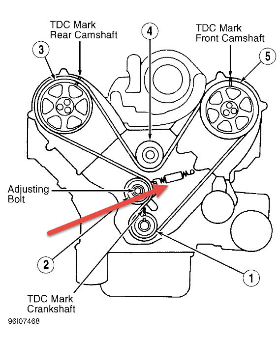

My car just off while I was driving to work. It just keeps cranking but will not start. I look through oil filler hole on the valve cover and ask someone to crank it but then I discover the cams shaft are not rotating. ( both the front and back unit) for v6. I checked the timing belt and it is still rigid in place. No sign of it has been broken. Is it possible for the main shaft pulley on which the timing belt get its movement is loose? What else to check?
HMAC300
  • 48,601 POSTS
in the drawing you will see that there are three bolts per cam so probably not that. more than likely the tensioner broke so you may as well pull heads because this is an interference engine and valves have hit the pistons so hard telling what damage has been done.

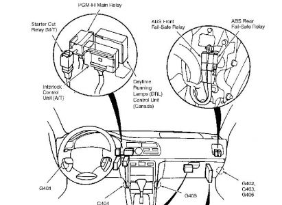

Will not restart immediately. After setting a while it may restart, or not. After setting longer it will start, and drive normal for weeks or months then it will stall out again for no apparent reason. Have replaced ignition, all fuel filters. Bad fuel has been ruled out as cause. On sixty five mile trip drove fine, sat for six hours and started home. Got seven miles and stalled. Set twenty minutes and started, got one mile and stalled again. Towed to Honda, found nothing wrong, drove home. Next day stalled again. Towed to local Honda, found nothing, (after $600.00). Drove home, got three miles and stalled again. Towed back to Honda, found nothing. Drove home and fine for three months then stalled again. I had the relay mentioned replaced. Problem remains. Mechanic says computer needs replacing. Any ideas?
KHLOW2008
  • 41,814 POSTS
Hi efinnell, Symptoms are consistent with an intermittently failing PGM-FI main relay. This is a known fault and if you resolder the PGM-FI main relay circuit board, it would work as good if not better than a new one. The cause are broken soldered joints on the circuit board.
https://images.2carpros.com/forum/automotive_pictures/192750_PGMFIRelay95Accord_7.jpg
