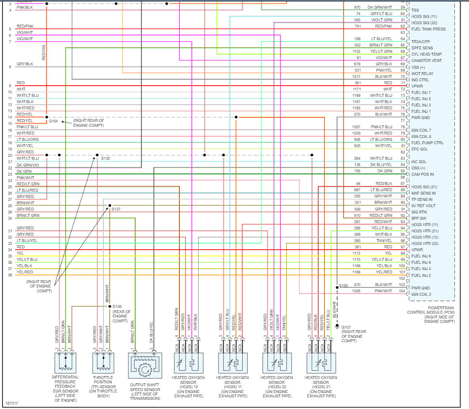

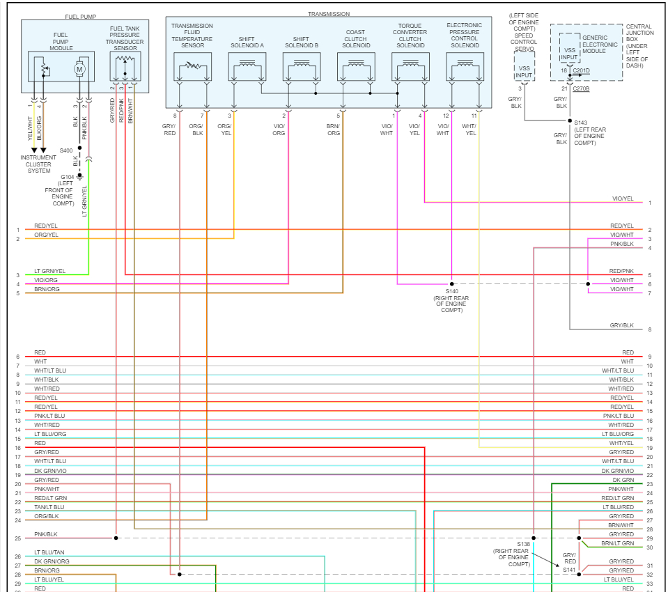

Hey, I'm remodeling my old Ford for offroad and I would like complete pinout and wiring diagram of it. Thank you.

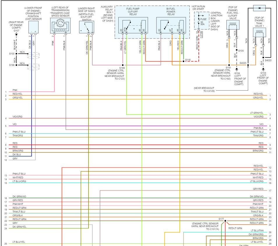

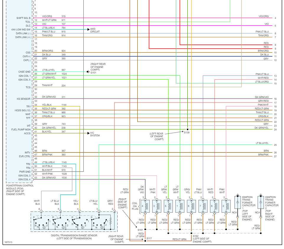

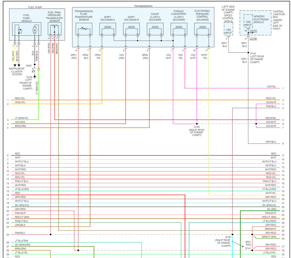

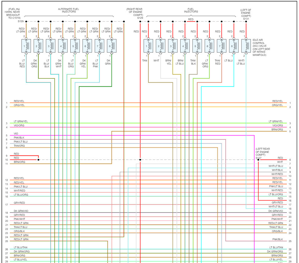

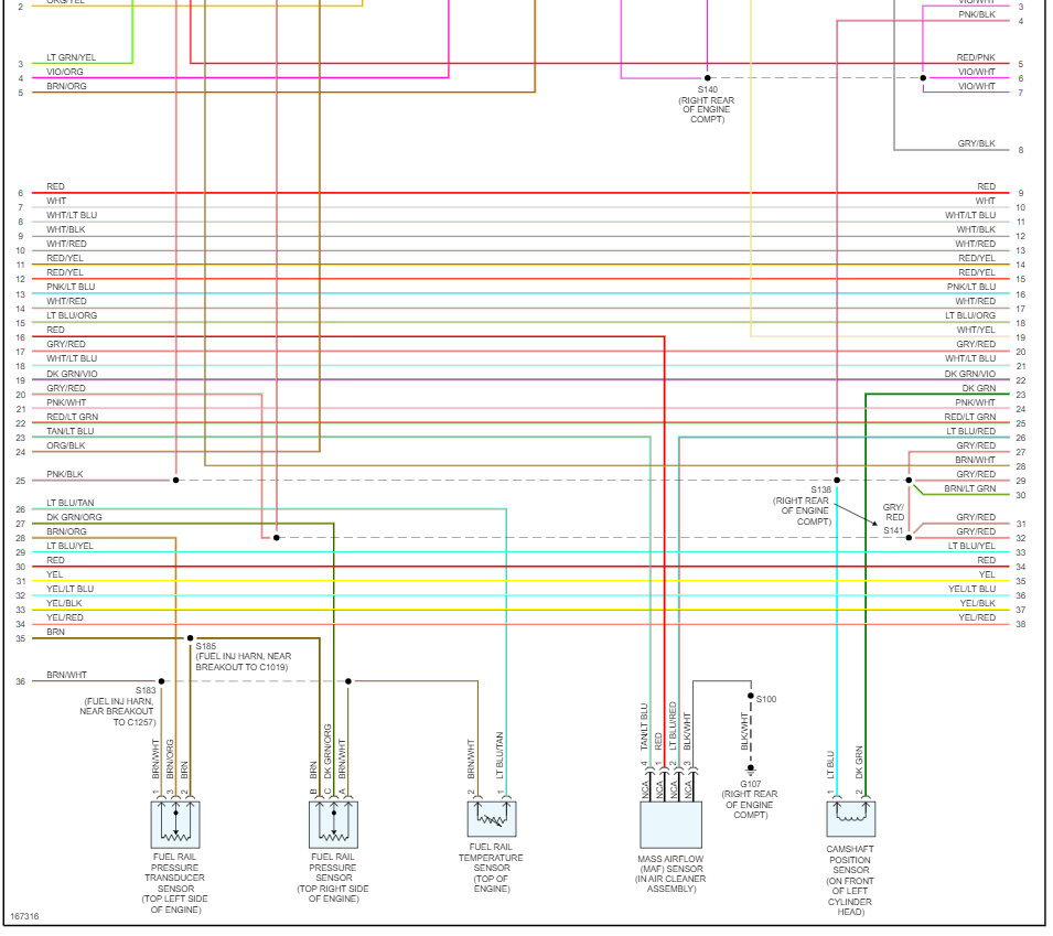

Sure, here is a guide to help you test the connection and the engine and PCM wiring diagrams in the images below:
Check out the images (below). Please let us know if you need anything else to get the problem fixed.
