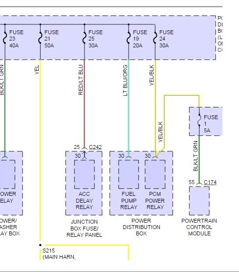

Ford 97 f150 my wife let it warm up for about 10 minutes and started towards the gate and it quit on her before she got to the gate it blows the #24 30amp fuse when you try to crank it. No fire no fuel. I found some bare wires and taped them thinking that was the problem but there still seems to be a short. Have checked all wire to transmission and transfer case short is still there. It is a dead short not intermittent it blows 30 amp fuse #24 soon as I turn the key on. Do you have any ideas I have been working on this for 3 days and not getting anywhere. Any help would be greatly appreciated.

LOOKY HERE!
GOT A DIAGRAM!

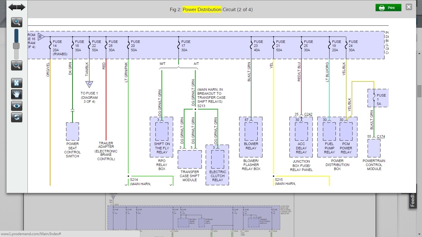

I HAVE TO MAKE SCREEN SHOTS (WITH PERMISSION), AS "PRODEMAND" IS A "BUY" REPAIR MANUAL (A FRINGE BENEFIT FROM 2CAR TO HELP WITH ANSWERS), SO THEY DON'T HAVE FREEBIE COPIES OF A LOT OF STUFF.
THERE WERE 4 POWER DISTRIBUTION DIAGRAMS, I FOUND YOUR INFO IN THE 2nd ONE. IN ORDER FOR THINGS TO POST ON THIS SITE SO YOU CAN SEE IT, I GOTTA TAKE ONE CHUNK AT A TIME. FORTUNATELY, WHAT YOU NEED FROM THIS ONE IS SHORT AND SWEET, I GOT IT IN ONE SHOT.
I CAN FIND STUFF-I'M NOT A MODERN VEHICLE KINDA GUY, CARBURETED JEEPS ARE MY CUP OF "SWEET TEA"
I RECKON THERE "MIGHT"/ "COULD BE" OTHER DIAGRAMS BRANCHING FROM THESE COMPONENTS SHOWN HERE.I JUST DON'T KNOW

NOW THAT I HAVE MAYBE "DRAWN THE PICTURE"
I LET DOC "COLOR IT" FOR YOU!
I'M SURE HE CAN TELL YOU WHERE TO START TESTING/ CHECKING
IF MORE DIAGRAMS ARE NEEDED, I'LL LOOK FOR 'EM
DIAGRAM IS BELOW

I TRY FOR BIGGER
HERE GOES

Thanks CJ for providing the diagram. The short was not on the circuit protected by the one amp fuse because if it was, that is the fuse that would have been blowing. The short has to be on the output side of the PCM power relay. That relay turns on for one second after turning on the ignition switch, then again during engine rotation, (cranking or running). I'm cutting it close on time so I'll have to do this from memory, and from my experience with Chrysler products, which are similar for this circuit. Typically the relay sends 12 volts to the injectors, ignition coil(s), and oxygen sensor heaters. None of those things commonly short so you can expect to find a wiring problem instead. Probably the most likely suspect is a wiring harness that fell down onto hot exhaust parts and a wire melted through and grounded out. The next suspect would be a harness that slides back and forth as the engine rocks during acceleration, and a wire's insulation is rubbed through. It's hard to replicate that movement when the engine isn't under load. Instead, lift the harnesses up and look for shiny spots on the body where the paint has been rubbed off. Next, look for harnesses that are run over sharp edges of metal brackets.

Since the diagram shows voltage coming in on terminal # 30, I'm posting my sad drawing for a Chrysler relay that uses the same designations. You may find these numbers on the side or bottom of the relay, otherwise go by the locations of the terminals. Use a wire or stretched-out paper clip to jump terminals 30 and 87 together while the relay is unplugged. Be careful to not spread the terminals in the socket as that can add a new intermittent problem.
