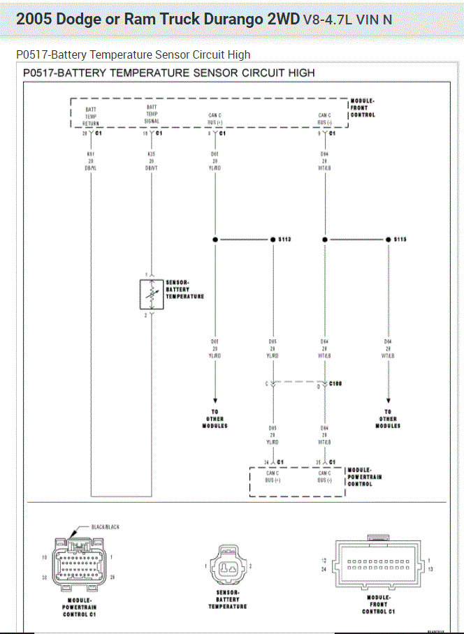

When the vehicle is running, are there any strange odors, sounds, or smoke from the exhaust? What exactly is it doing at this point?

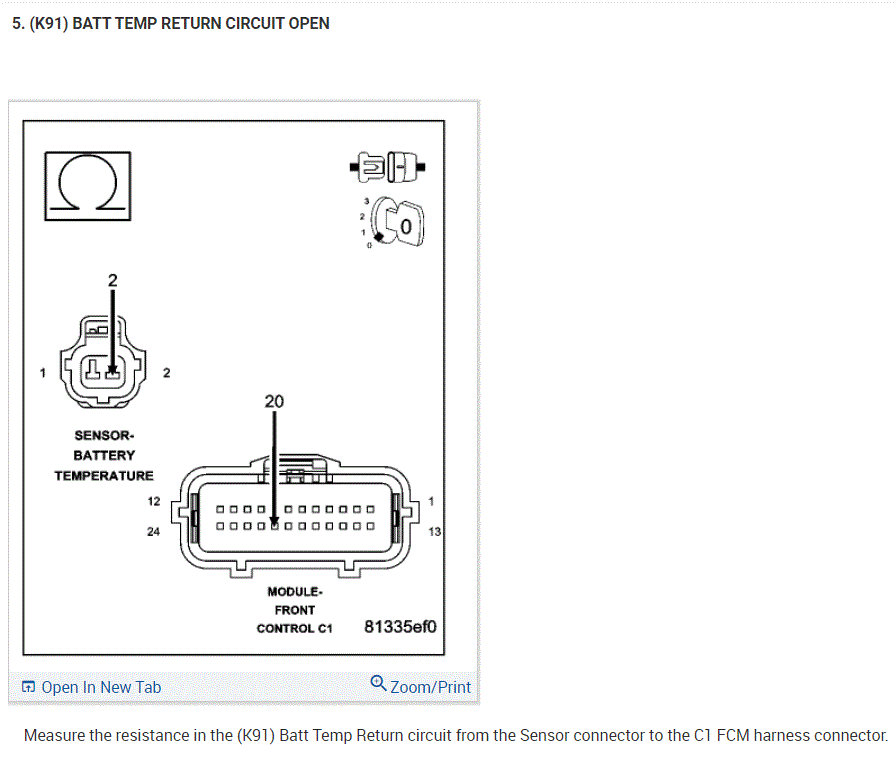

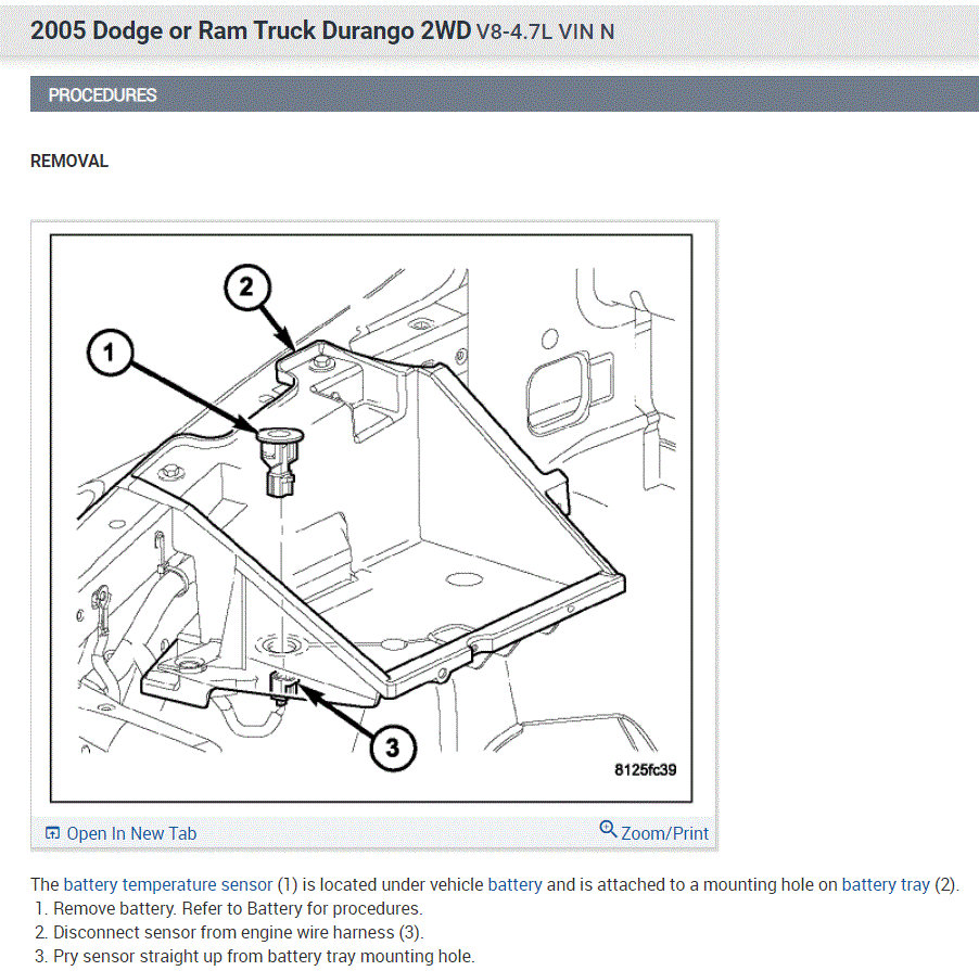

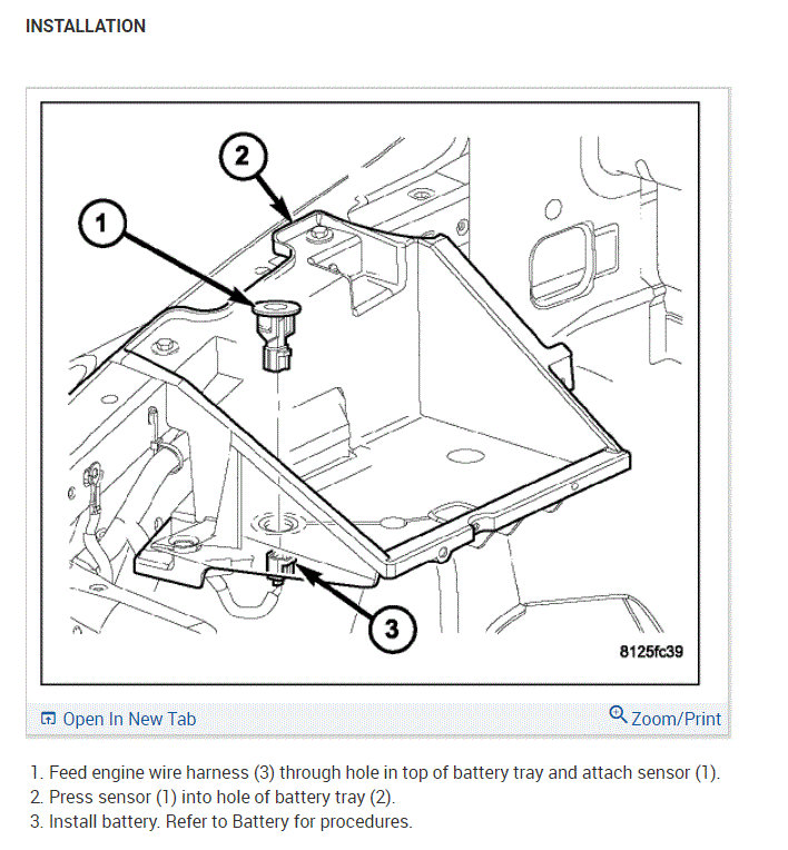

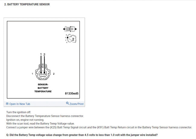

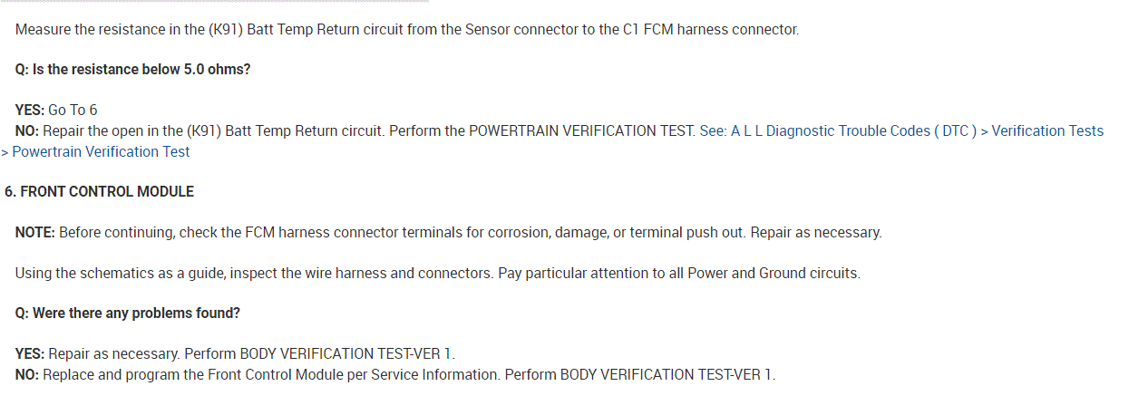

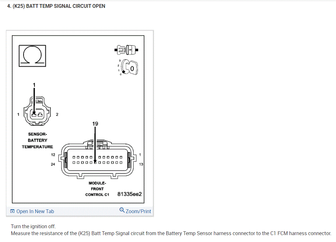

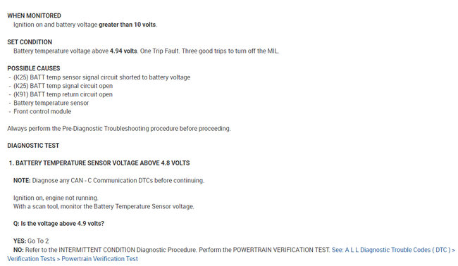

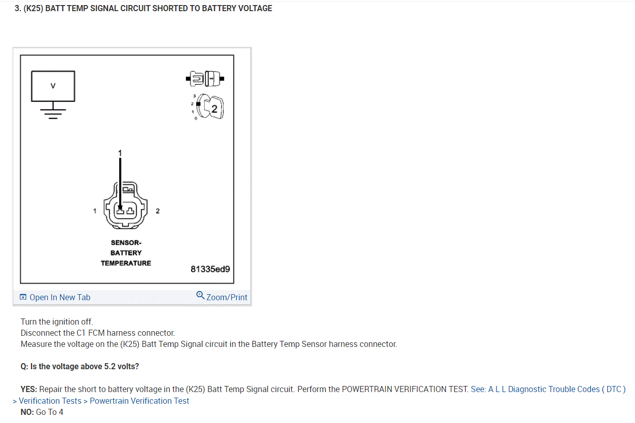

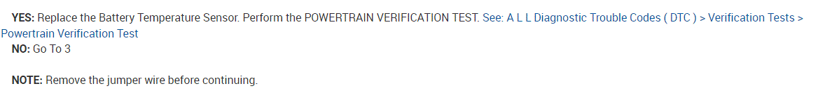

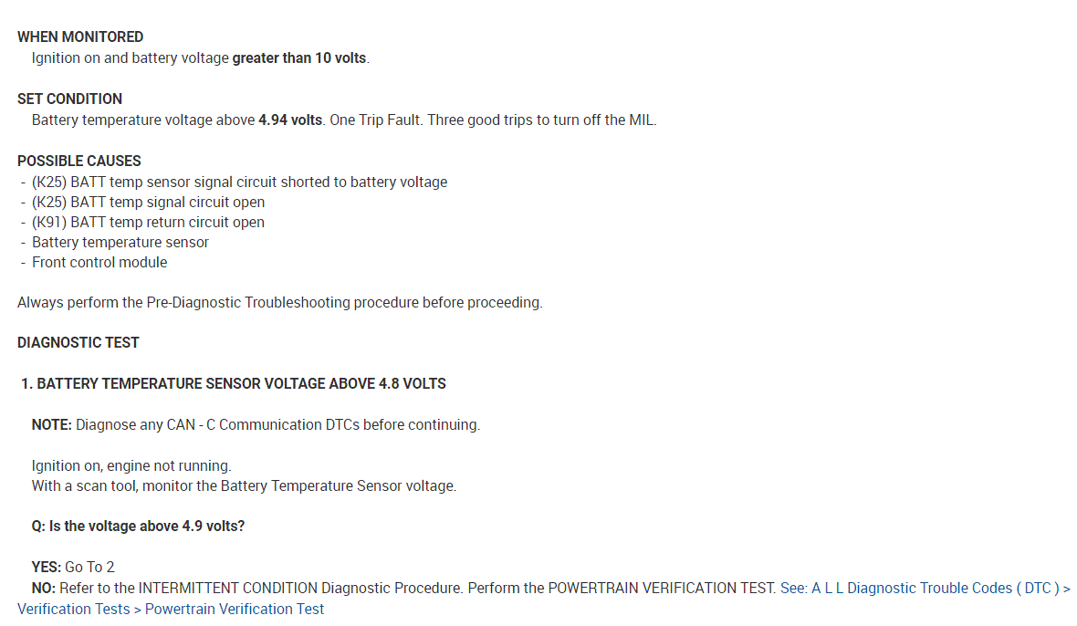

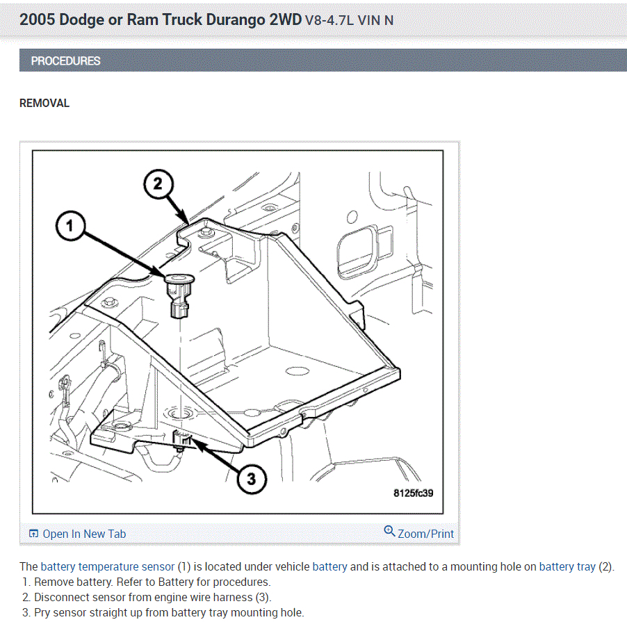

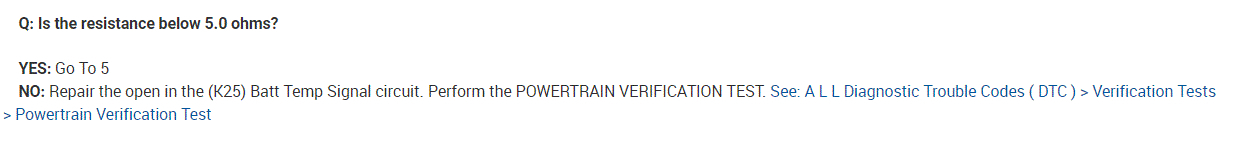

As far as the battery temp sensor, it is located under the battery. I attached information on the code, testing related to the code, and how to remove and replace it if you determine it's bad.
Here is a link you may find helpful when testing:
Let me know as much as you can about what is happening. Also, when you lost power steering and power brakes, was the engine running, almost stalling, or did it already stall?
Let me know if this helps.
