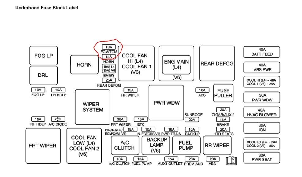

ECM/TCM keeps blowing to the point can't put a fuse back in.

I would start by disconnecting the engine control module and see if the fuse still fails when the key is turned on.
If it does, there is a wiring issue between the fuse and the engine control module.
If it clears, then the engine control module is the issue.

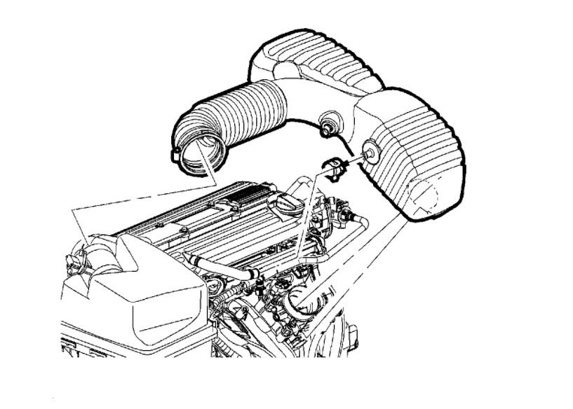

3. Disconnect the intake air temperature (IAT) sensor.
4. Loosen the clamp at the air cleaner assembly.
5. Remove the push pin attachment from the outlet resonator/duct assembly to support bracket.
6. Loosen the clamp at the throttle body assembly.
7. Disconnect the positive crankcase ventilation (PCV) fresh air hose at the cam cover.
8. Remove the outlet resonator/duct assembly.

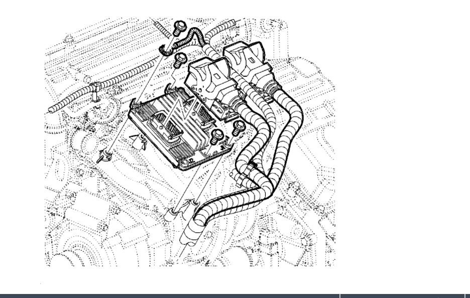

9. Remove the J 1 and J 2 connectors at the engine control module (ECM).
10. Remove the 4 ECM attachment bolts.

1. Install the ECM.
Notice: Refer to Fastener Notice.
2. Install the ECM bolts.
Tighten the engine control module bolts to 8 N.m (71 lb in).
3. Connect the J 1 and J 2 ECM electrical connectors.
4. Install the outlet resonator/duct assembly into position.
5. Connect the PCV fresh air vent hose assembly.
6. Tighten the clamp at the throttle body assembly.
7. Position the outlet resonator/duct assembly up with the support bracket and install the push-pin.
8. Tighten the clamp at the air cleaner assembly.
9. Connect the IAT sensor connector.
