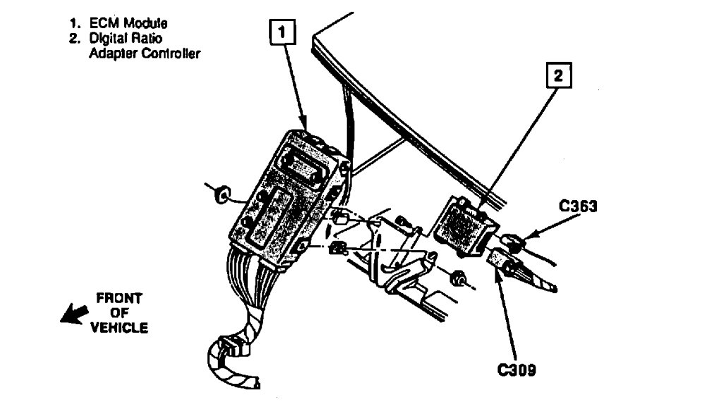

ECM? The fuse that's blowing is ECM 1.
Wednesday, January 9th, 2019 AT 9:06 AM
  • 52,797 POSTS
Yes, that is the engine control module
it has a couple of feeds and that is one of them.
It is behind the glove box. You access it from under the dash and it pulls down.
Wednesday, January 9th, 2019 AT 9:13 AM
