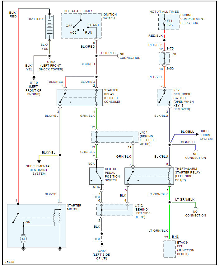

1996 eagle talon awd Turbo, 1.8, newly rebuilt 6 bolt swap, dsmlink ecu management, here's my huge problem, first it's a motor swap which worked out mint, but there's one issue the starer system is not working. With the dsmlink system I can monitor ignition and when it works it's does show that but I can't figure it out. There was an alarm system we ripped out so maybe there's something going on there but idk cause when I turn the key I hear the stARTER and relays clicking but the starter won't turnover and it's a new starter and I bench tested it and its fine so does it sound like a ignition switch issue or there's something on top the tranny that plugs in could it be that whatever that is. Oh yea sorry failed to mention this is a 5 speed and I tried 2 disconnect clutch switch no luck. Help please

Yep, if you have an aftermarket alarm that was taken out this will be the problem, I would repair the wiring. Here is the wiring diagrams for the starter so you can see how the starter system works. Check out the images (below). Let us know how it goes.
